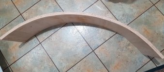

I am looking for some advice on routing with a Trend T11EK. My daughter wanted me to make 'bridges' for her, so I have laminated 6 strips of 3.6mm ply together around a steel former. The resulting shape is 900mm long by 300mm wide and about 22mm thick. The radius is about 200mm. I want to try and roundover the edges. I don't have a router table but could potentially get access to one.
Can anyone suggest how I could do this? My router was an impulse purchase - at £100 new!

Any chance you could post a picture of the laminated ply? I am have difficulty picturing the job.

Thanks for the replies so far. Attached should be a couple of photos.

Intriguing- what are they for?
How much rounding off do you want to achieve? If it’s just easing the edges then sand/glass paper should do.
If you need to use the router, a table is much safer making sure you cut in the correct direction.

You mention the router was an impulse purchase but you don't say if you have cutters for it.
You will need a round over cutter which has the radius you want. It will have a a bearing on the tip that will run along the wood to control the sideways cut. You set the depth of cut with the plunge stop on the router. Apologies if stating the obvious but from the question I'm taking it you are new to this.
You could buy a cheap set of cutters in a box or a quality single cutter for around the same money. The set will have things you will never use but can be ok to learn with. Any cutter can break if you cut too heavy with it so be more cautious with cheap ones.
The cutter will follow the edge so you want the edge straight and smooth before you start.
The router in a table would be easier to control - the router stays still and you move the wood but your job looks do-able without one.
