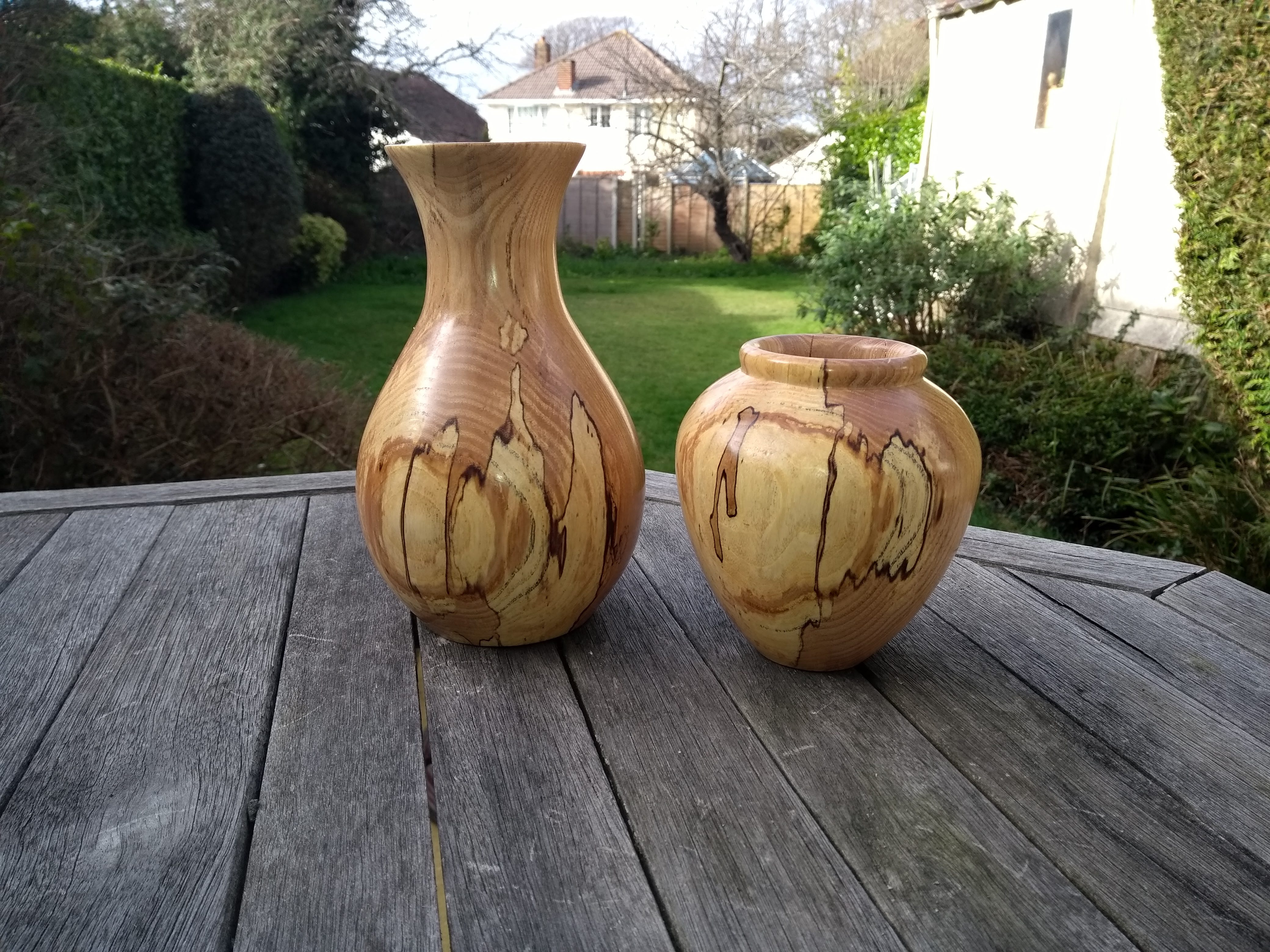

Postby selectortone » 11 Mar 2019, 16:38
For my sister's birthday. Turned from the same piece of spalted beech. The larger one is about 8" tall:

Nice timber, was it difficult to get a good finish?

I like those; never done anything in a spalted wood before. What's the finish used? - Rob

two very nice pieces and just the right amount of spalting. I really like the taller vase

DaveL wrote:Nice timber, was it difficult to get a good finish?
Yes, getting a smooth finish on spalted wood is a bit of a challenge - the spalted parts are very dry and it's easy to get tear-out. Liberal treatments of unthinned cellulose sanding sealer and sharp tools help, as does taking light cuts and paying attention to rubbing the bevel.
Woodbloke wrote:I like those; never done anything in a spalted wood before. What's the finish used? - Rob
They are finished with diamond white and then carnauba and beeswax applied by buffing wheels.
