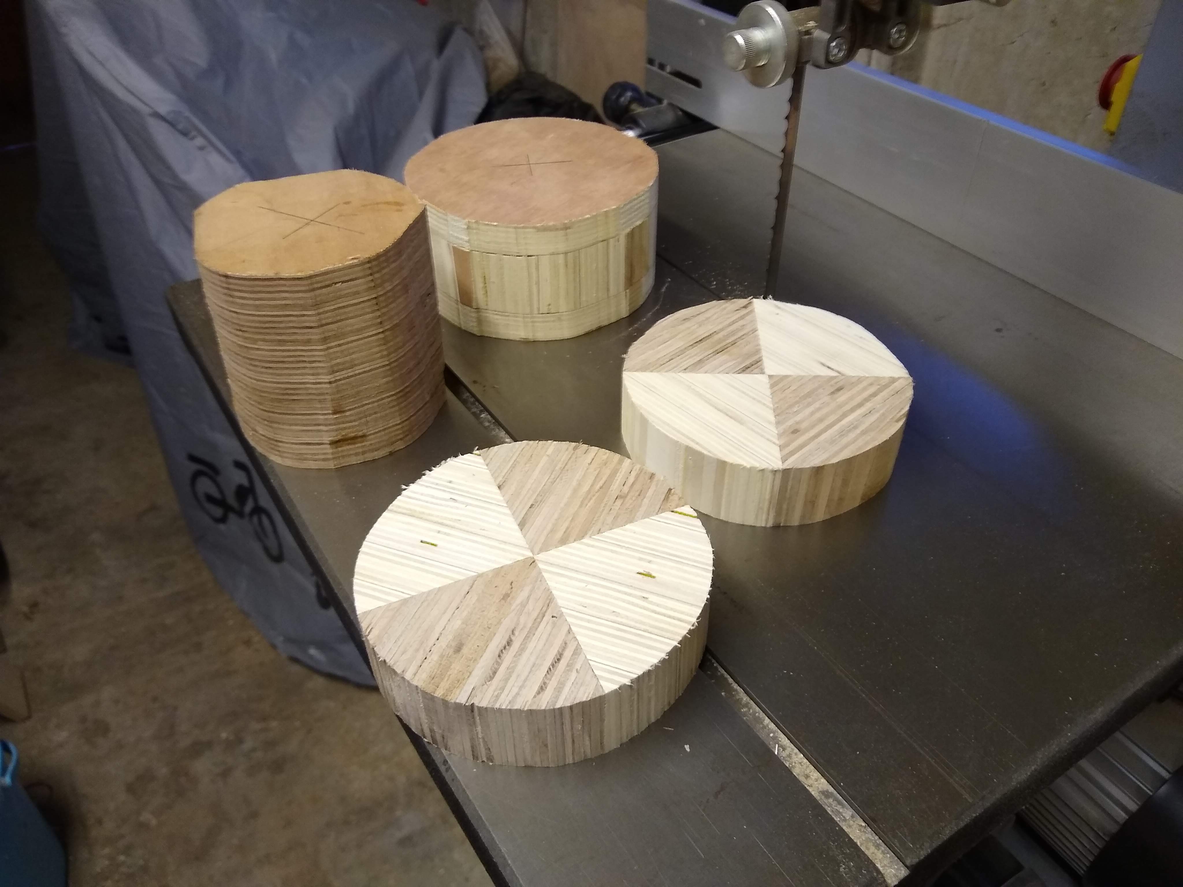

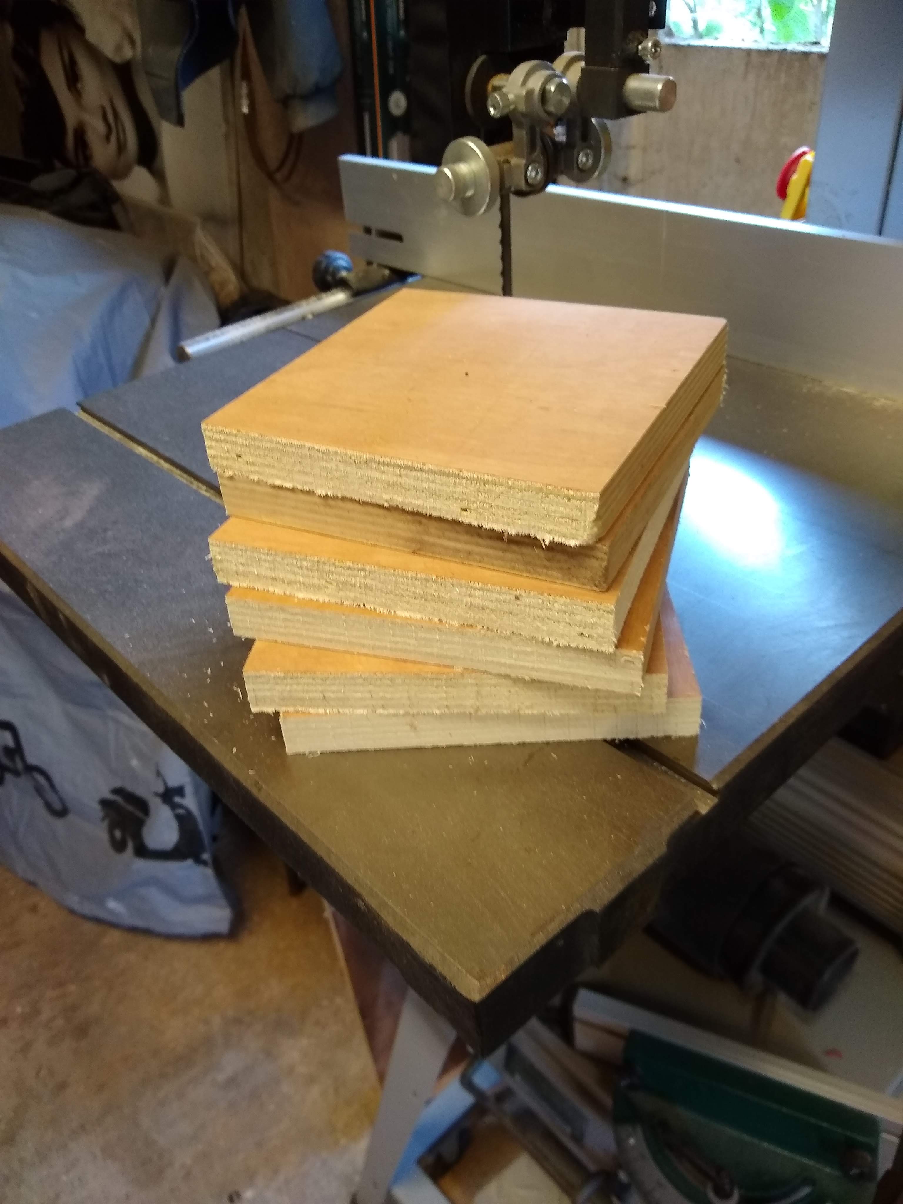

So: you start with a lot of this:

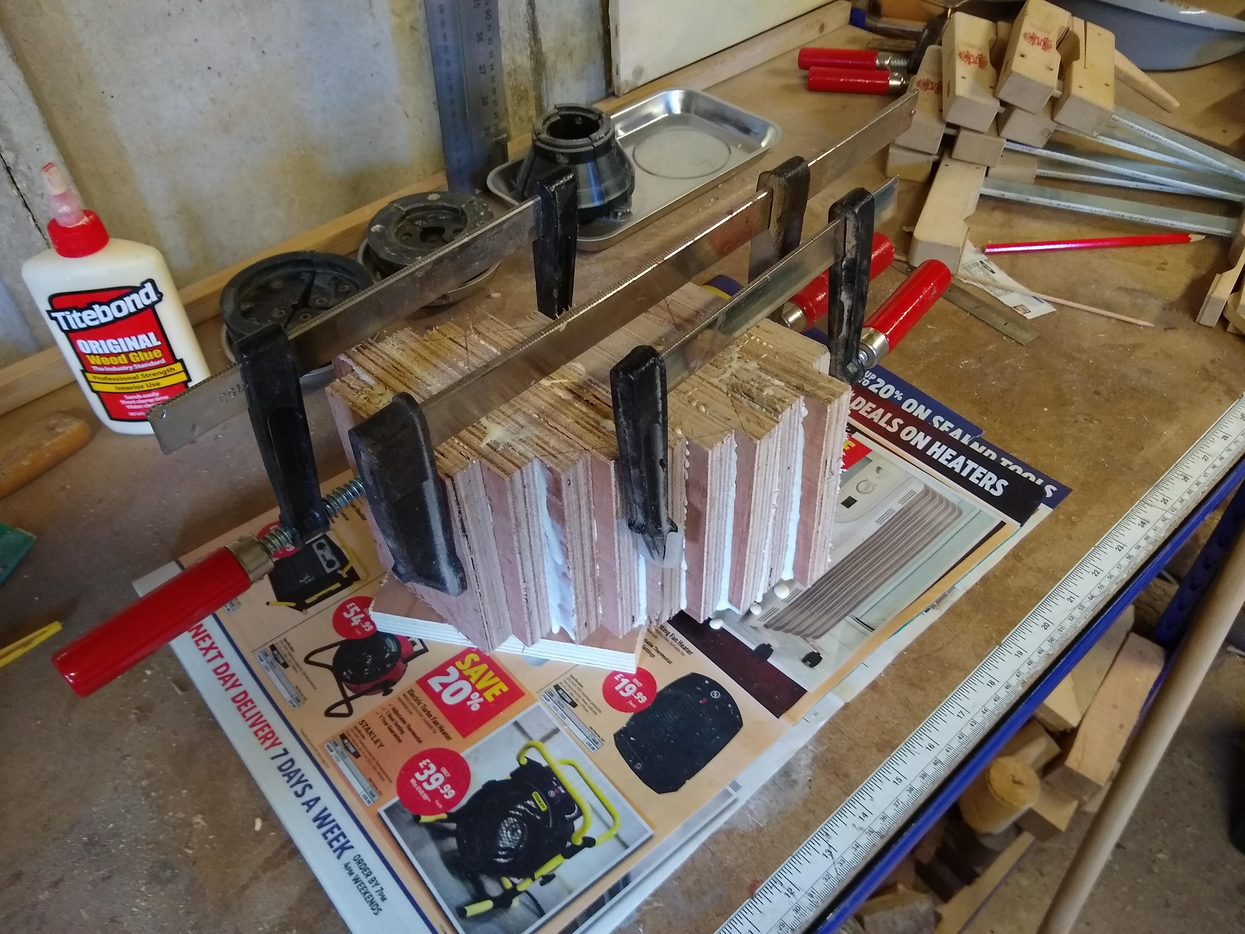

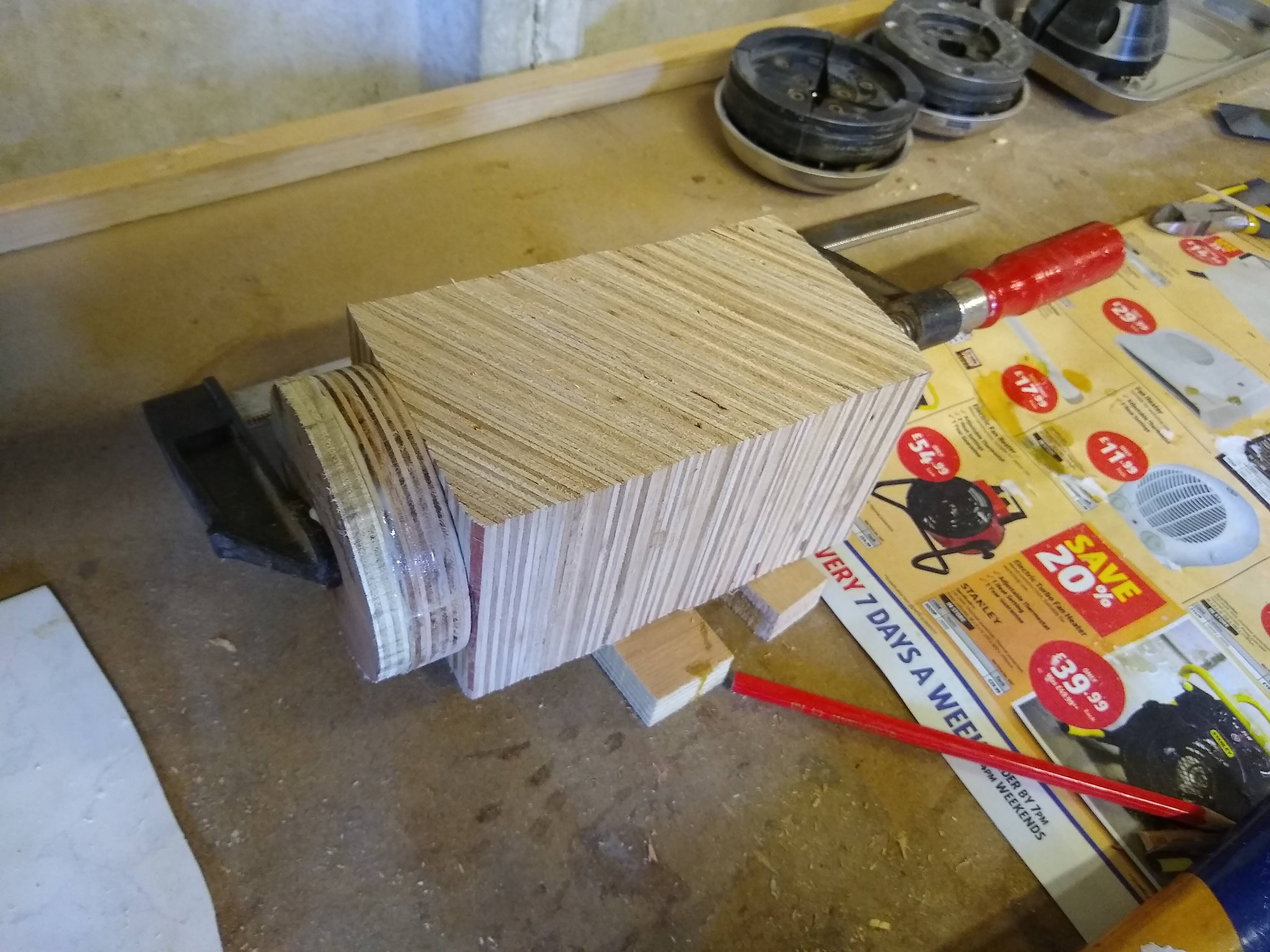

Cut it up, mitre it to bits and glue it all back together again:

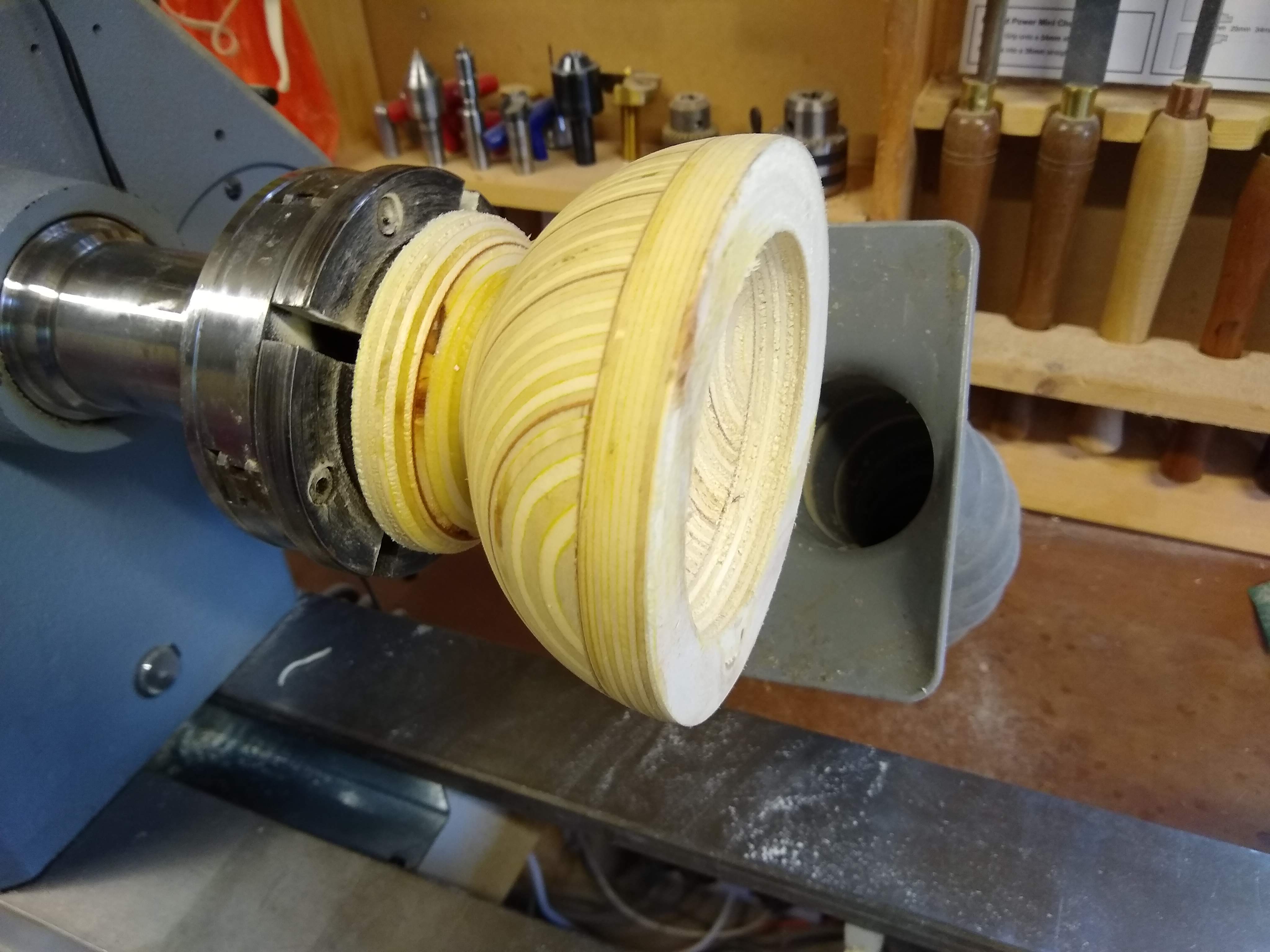

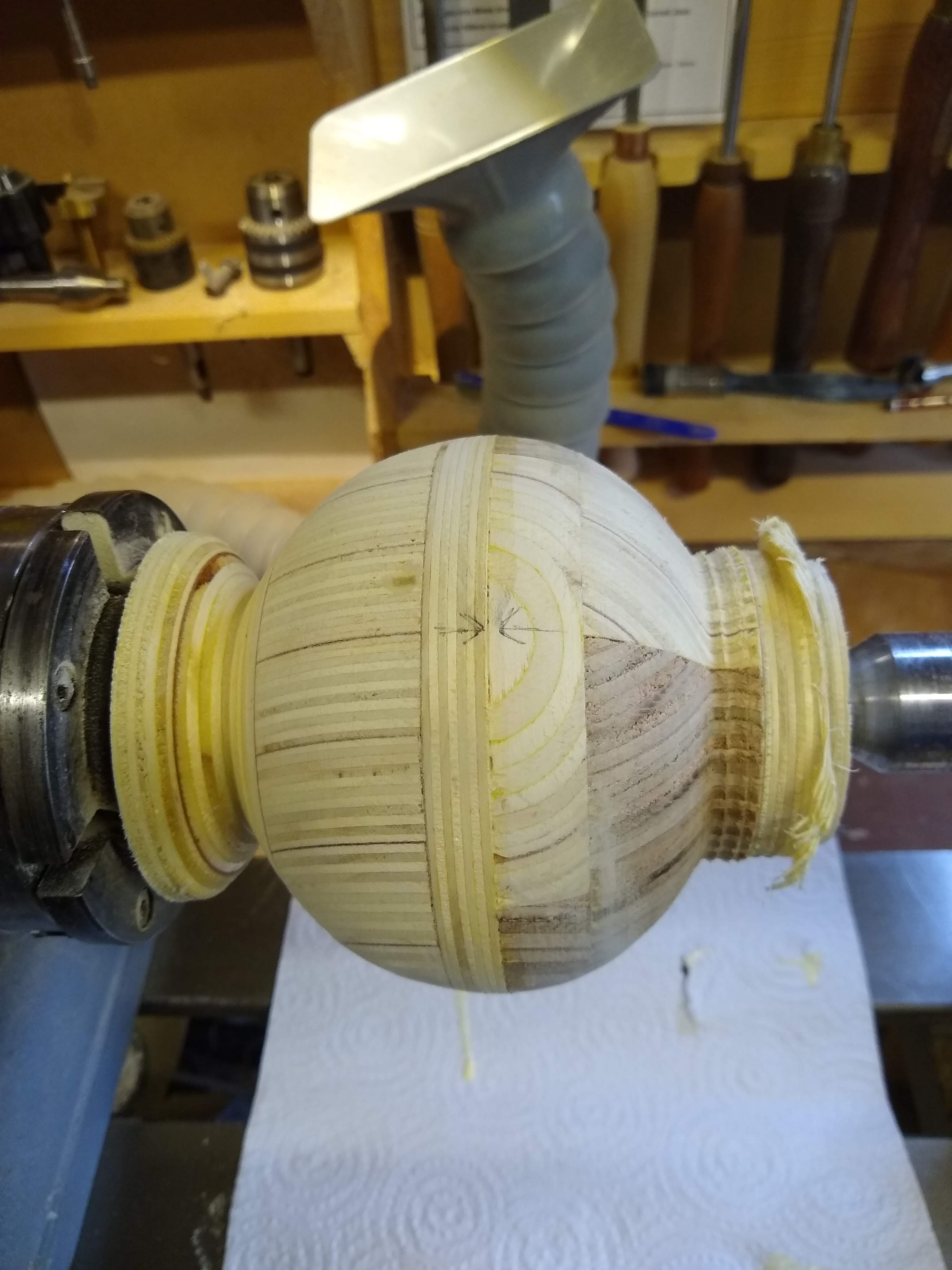

Some more glueing up, then turn the bottom half of the vase bowl:

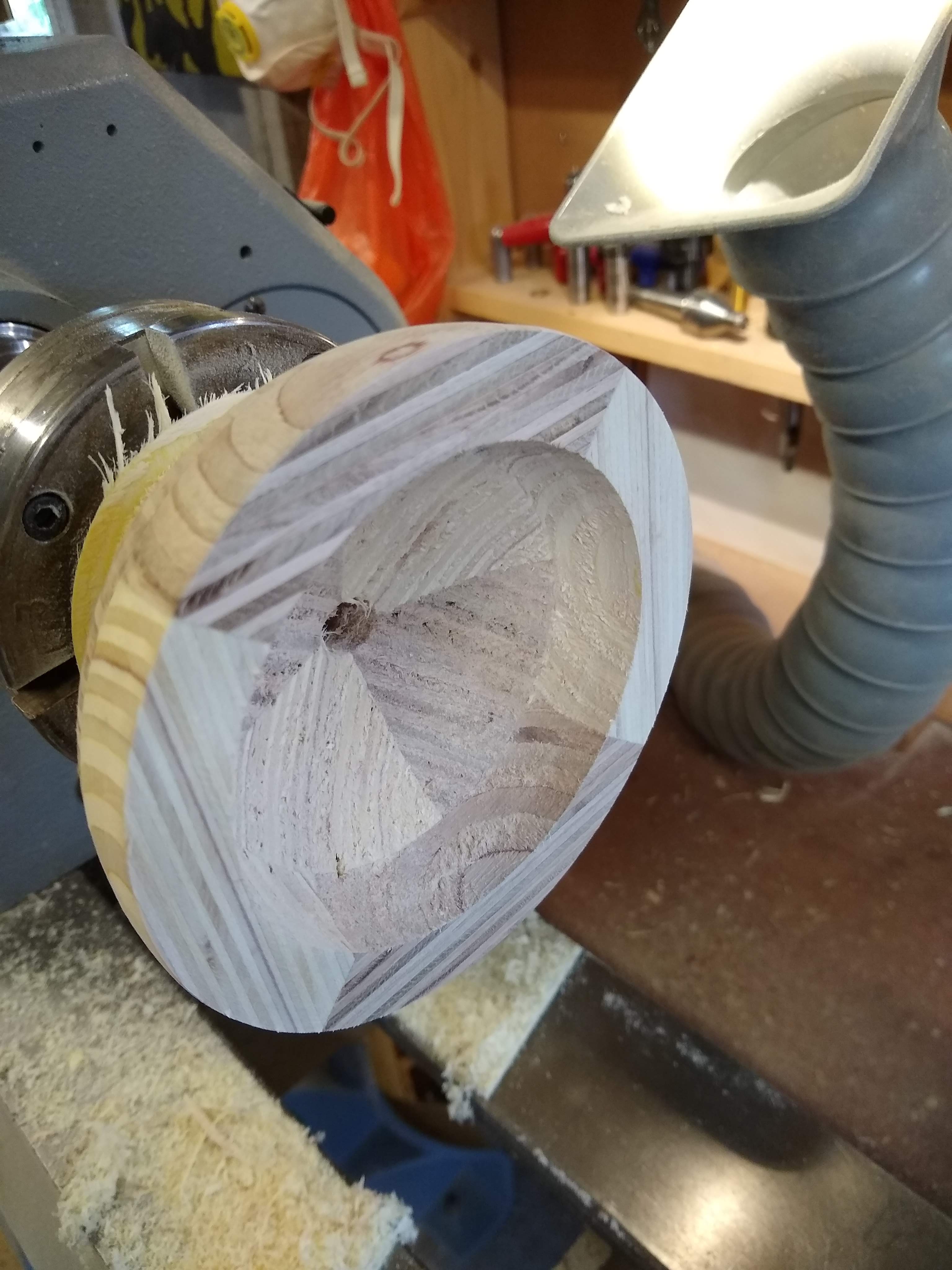

Then the top half:
Glue them together:

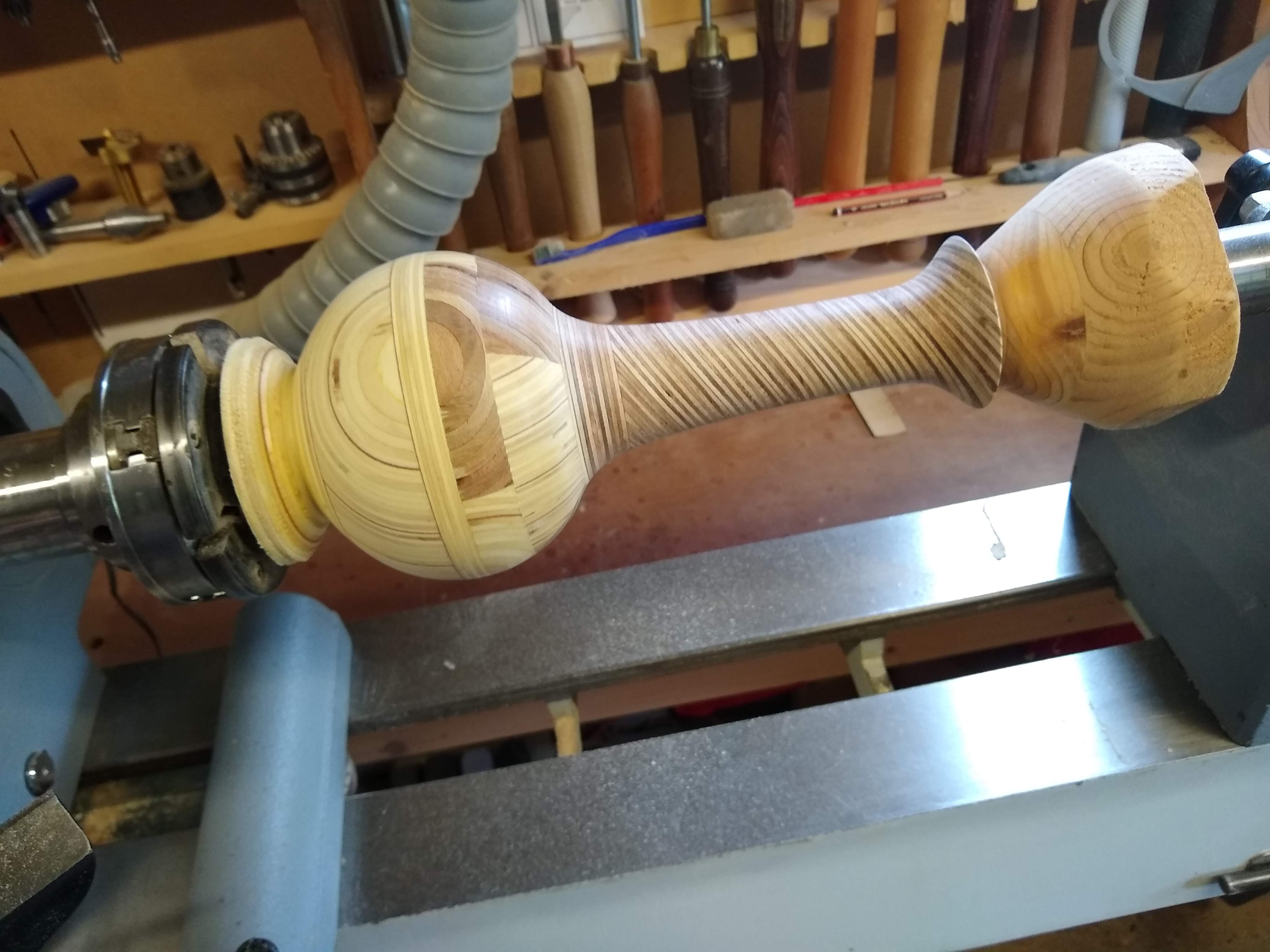

Glue some more for a neck (offset to get a 45deg angle):
Turn the neck (sorry, no pic) and then glue that on and turn to the finished article:

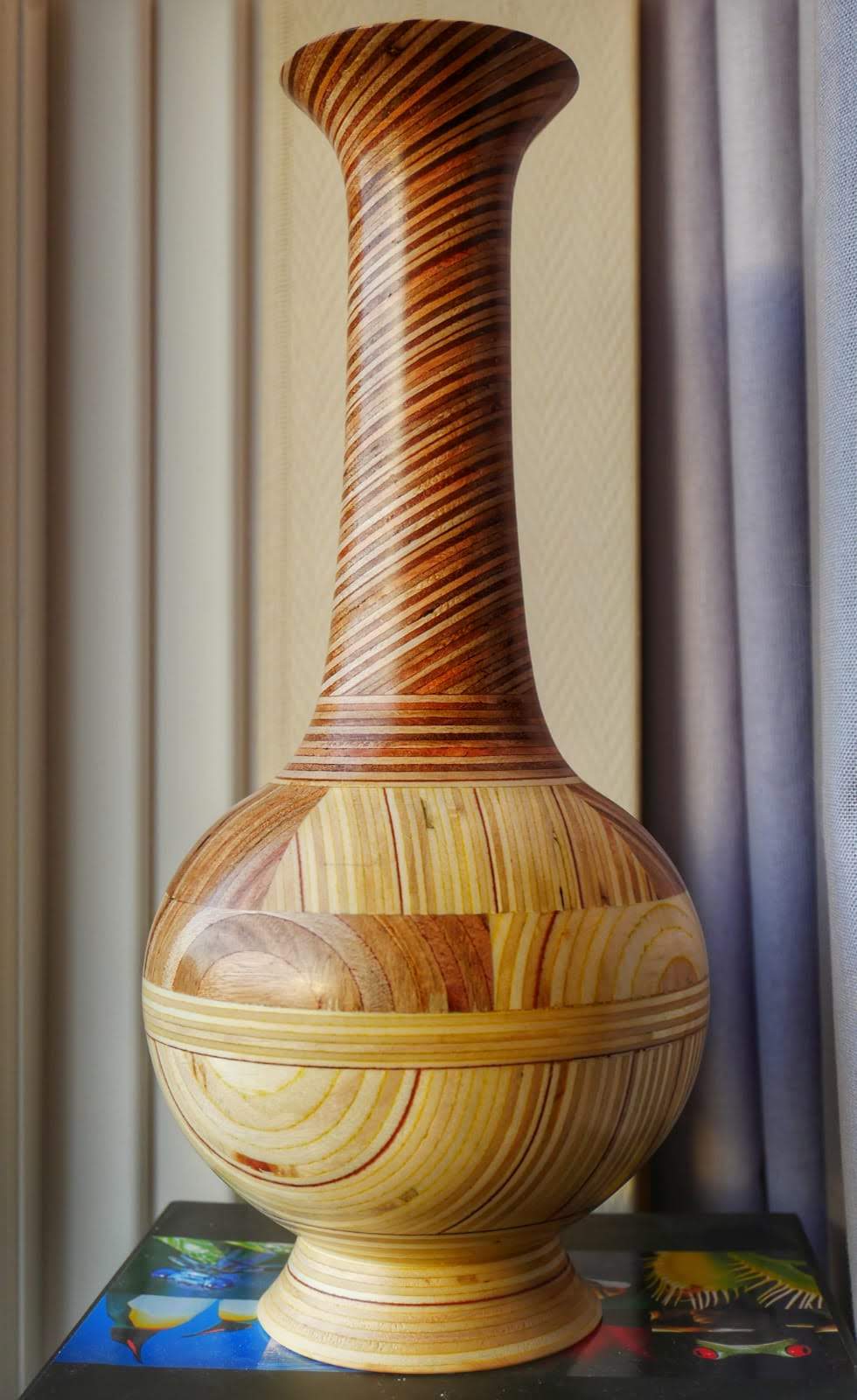

Slap on some paste wax, and voila:

Really nice.

Yes very nice, you have some good plywood there.

The only thing for me is the top half of the round section It would look better if it mirrored the bottom and then have the neck as you have done. It just looks too fussy with all the different directions of the ply.
That still does not distract from the good glue-ups with no gaps and the shape of the whole is very pleasing as well as the finish looks good from the photo
