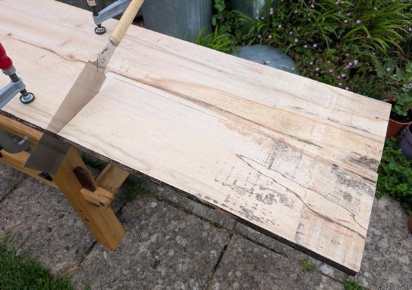

Although I've started the bedside table project, I haven't got very far with it yet. The legs have been planed on two sides and are sitting "in stick" (with some weights on top to try to keep them flat) and I'd like to leave them like that for a little while before finishing planing. It's far too hot at the moment to think about planing all the rest of the wood for the table so I thought I'd do a much smaller and (hopefully) quicker project in the interim.

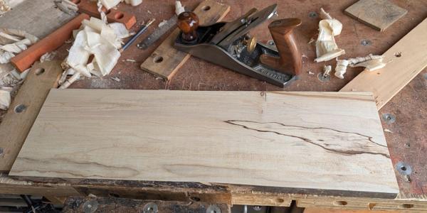

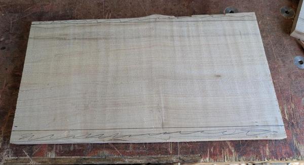

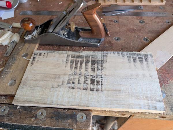

It started with one of the thinner bits of Sycamore that I'd bought for the bedside table. This one started at about 18 mm thick and I cut a bit off the end yesterday evening with the Ryoba (which was a lot quicker to do than the 40+ mm Sycamore I used for the table legs!)

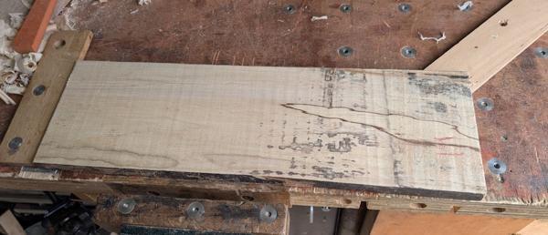

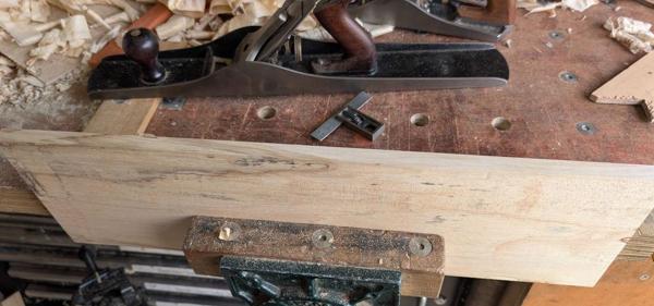

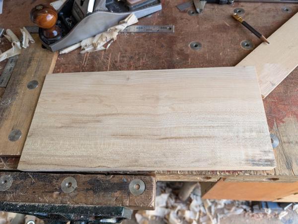

This is what the plank looked like once it was on the bench (the other side is a lot rougher but I forgot to take a photo of that):
After hand planing (both sides) with the #4½ it looked like this:

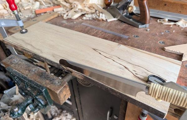

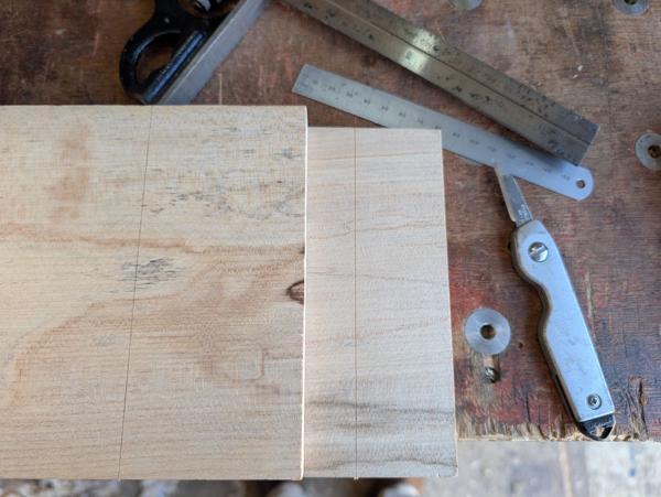

It was wider than necessary and I was keen to get rid of a knot near the edge, so I drew a pencil line for a rough size guide, chopped the other edge off with the Dozuki again and then used my panel marking gauge to scribe a line on both faces at what felt like the largest width I could achieve from the remnant:

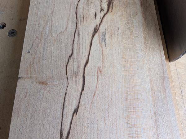

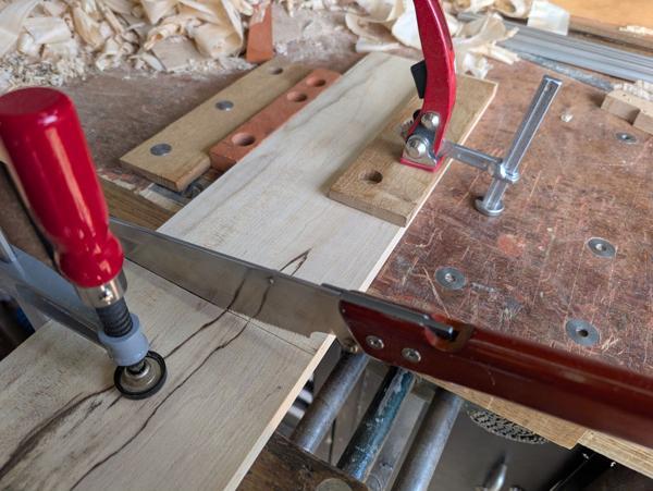

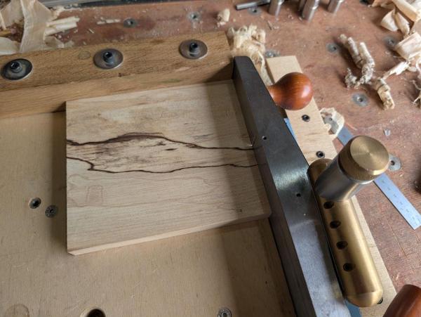

After planing that edge to the marking gauge lines, I picked a spot for a cross-cut. The aim was to select a bit of grain that was relatively straight for the area immediately around the cut line such that it would still match when closed up again (as a mitre). With the line picked, I carefully chopped it up with the cross-cut Dozuki:
The shooting board did its thing...
... and I was pleased to see that the grain lines still matched nicely:

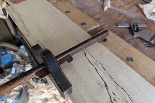

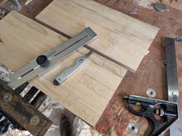

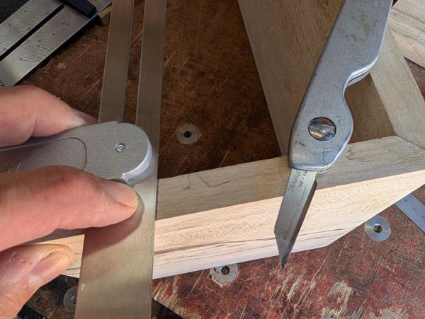

With the two planks ready to be joined, the first step was lots of marking out, using three marking gauges (one set for slightly over the thickness of the wood, one set for the thickness of the wood minus the thickness of the rebate and one set for the depth of the rebate at the mitre line) and this little Shinwa mitre square, which has the required 135° angle:
That photo looks a bit weird as the plank seems to be enormous, but that's just a perspective trick: the other plank is lying on the bench.

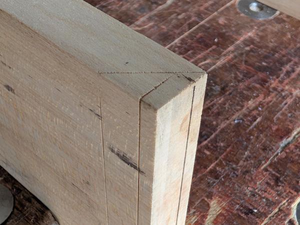

This is what one corner looked like after all the marking up:

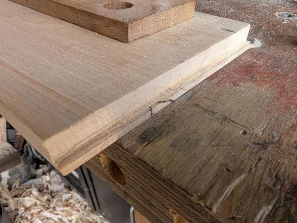

The marks for the rebate don't quite intersect as they're deliberately offset by a little bit to create a tiny pocket for glue to be squeezed into.

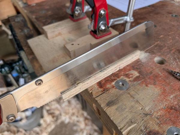

David Charlesworth cut the rebate using a powered mitre saw. I don't have one of them and, after considering a few alternatives, I opted to cut it with a cross-cut Dozuki, taking advantage of the teeth at the tip so I could cut the whole length without worrying about the far end going too deep:
The cross-grain cut was done in much the same way:
Straight off the saw:

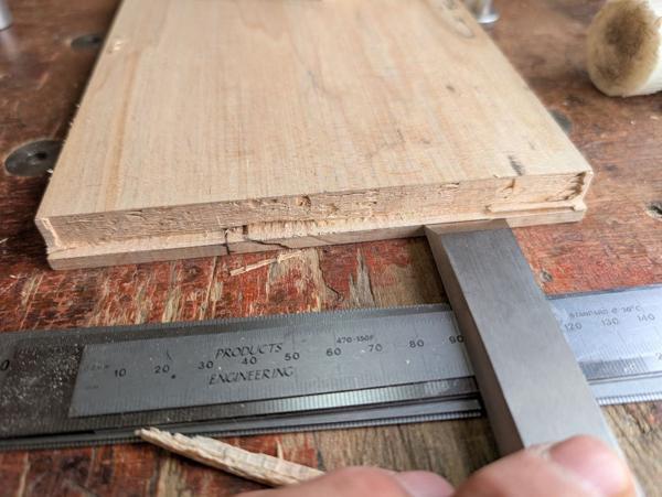

After chopping the rebate's shoulder line with a chisel, it was time to pare into the end grain. In David Charlesworth's video, he planed a little strip of wood to be slightly thicker than the rebate and then used that as a shelf for the chisel, thereby guaranteeing that the chisel would be going very slightly downhill and not leaving an undesirable lump. I was too lazy to plane a strip of wood, so I just piled up a few steel rules:
You can see from that photo that the shoulder line is a bit shabby, with bits of torn-out wood rather than a nice clean end-grain cut. The chisel was freshly sharpened and I took light cuts, but I think the softness of the spalted wood meant that I would have been better using a smaller chisel and minimising the force. I don't think it's an issue so I'm carrying on regardless.

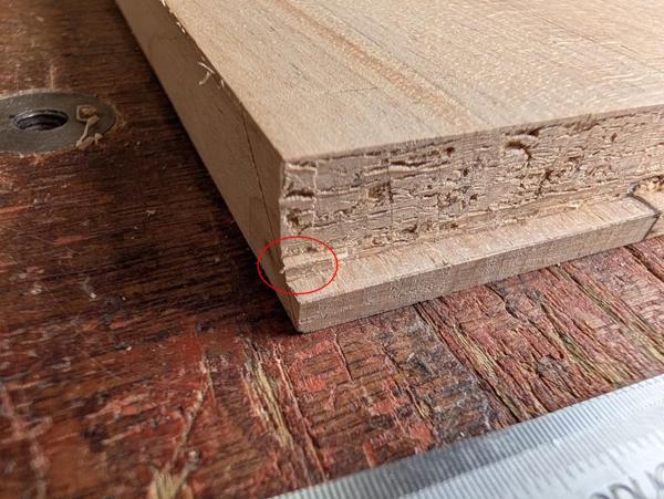

I mentioned before that the the two marked rebate lines didn't quite meet. For that reason, a tiny little lump of wood is left in the corner so as not to inadvertently cut into the mitre line:

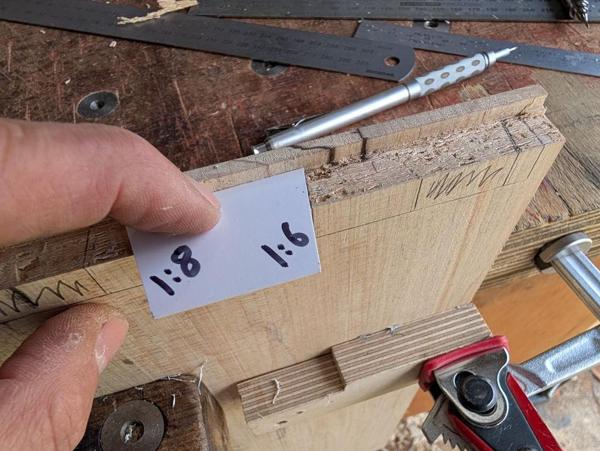

After drawing out the tail/pin pattern in full scale on a piece of paper, I made a little marking guide out of a bit of cardboard packaging and used that to mark the pin board:

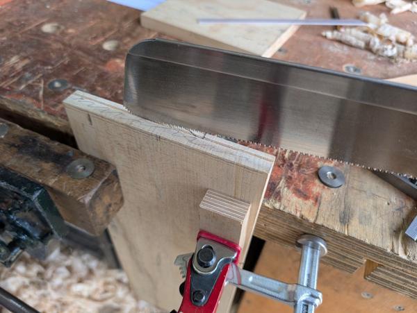

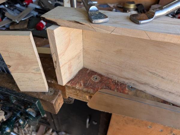

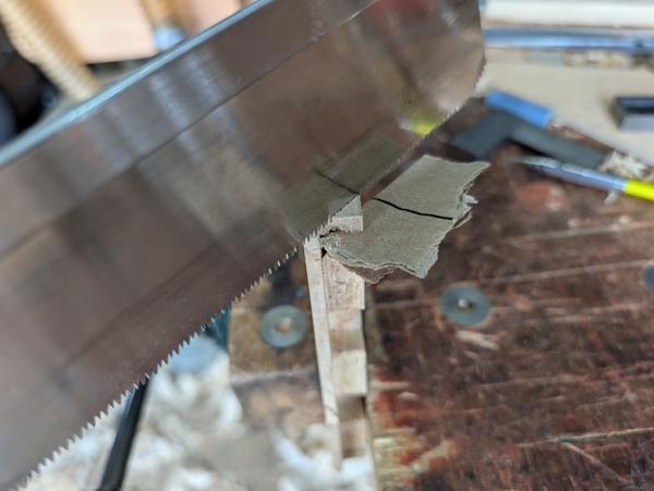

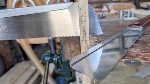

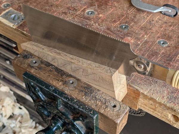

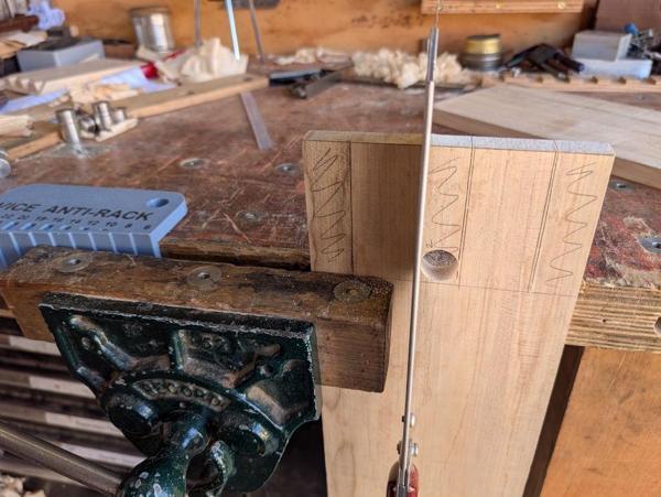

The pin walls got cut (to the line) with a Dozuki held at about 45°, cutting down to just above the shoulder line and just into the rebate:
In David Charlesworth's video he saws a little way away from the line and then pares to the line with a chisel (on both pin board and tail board). For through or lapped dovetails I usually saw straight to the line and I figured it would be fine to do the same the pin board. I may follow David Charlesworth's approach when I cut the tails but I'll decide closer to the time.

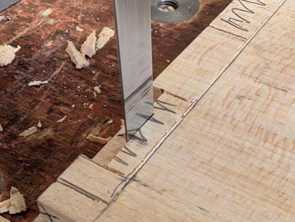

Next up was to mark a second shoulder line about 0.5 mm closer to the end of the board than the existing one with a combination square and knife. I could then chop to that line (hence leaving a tiny bit for a final clean-up with a freshly sharpened chisel) using a smaller chisel (10 mm or 12 mm if memory serves) with a depth line marked in marker pen on the back of the chisel:
Each chop was straight down (so ignoring the dovetail angle) and to full depth.

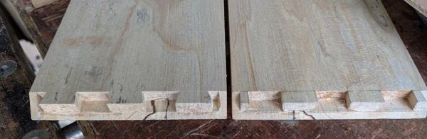

That left the pin board looking like this:
The next job is to chop out the angled faces, clean up the bit that's parallel with the rebate line and then do the final cut to the shoulder line. However, it's far too hot in the workshop now so I've called it a day. I'm not sure when I'll get more time on it but I'm pleased with the progress so far.

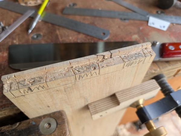

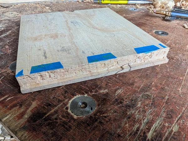

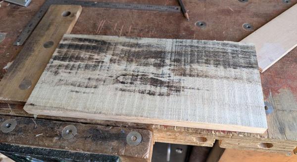

I have a stash of spalted sycamore, and the last thing that would ever cross my mind with it is to try to make proper joints. It's horrible stuff to try to work cleanly. All I can do is wish you the very best, Al, and hope it works out OK. I think you've seen already how crumbly it is. I reckon you might end up trying to glue this with thickened epoxy.
The stuff I used to make the drawer box didn't seem that bad & lulled me into a false sense of security I think.
Never used sycamore, spalted or otherwise. This stuff doesn't look very 'docile' - Rob
It's generally been a lovely wood to work with. Not as nice as ABW but as native (ish) woods go it's great.

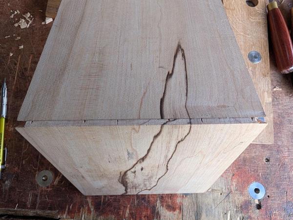

I think it depends how spalted the spalty bit is. The drawer box...
... had some lovely patterning (it might not class as spalting 🤷‍♂️ ) but was really nice to chisel.

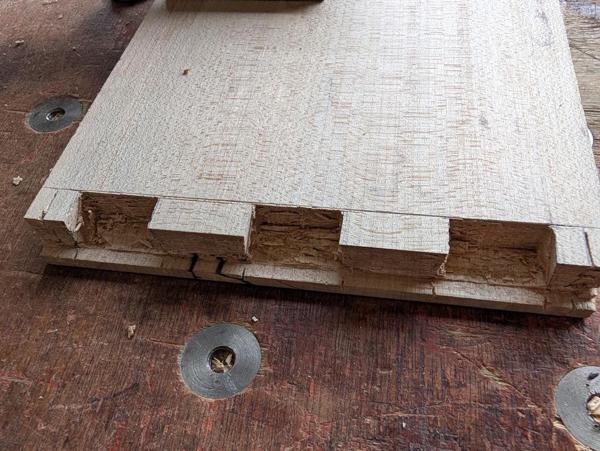

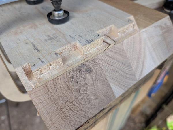

I couldn't find any photos from of the tail sockets post chopping, but this one was after chiselling a mitred corner, where it behaved impeccably:
Yes Sycamore is normally a lovely wood to deal with, hard like Maple, I used to use it for the insides of drawers till I couldn’t easily obtain it anymore. Gives a lovely crisp edge as you’ve shown Dr Al.

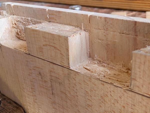

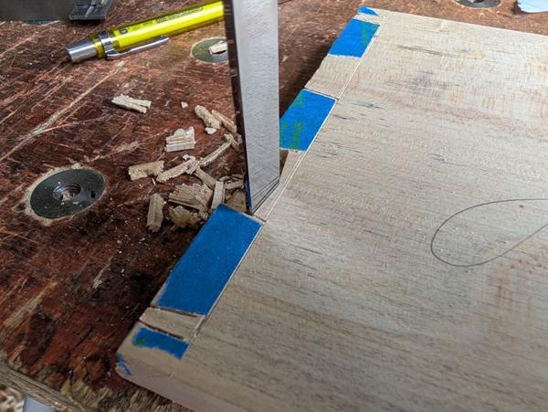

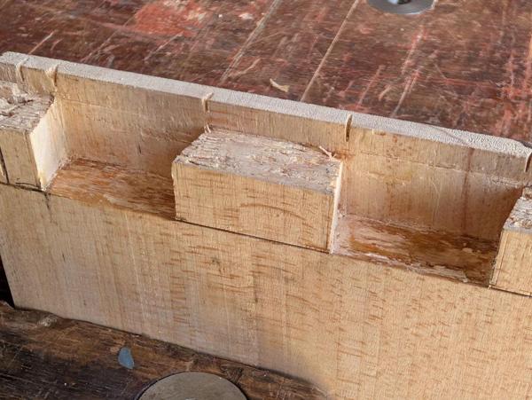

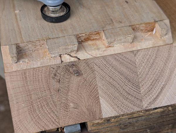

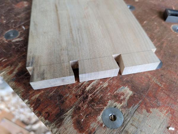

I finally managed a bit more workshop time this morning. If you remember from the last instalment, the last thing I'd done was to chop straight down parallel with (but not all the way up to) the shoulder line. The next job was to clean up the corners (where the saw didn't reach due to cutting at 45°), which I did in the vice:

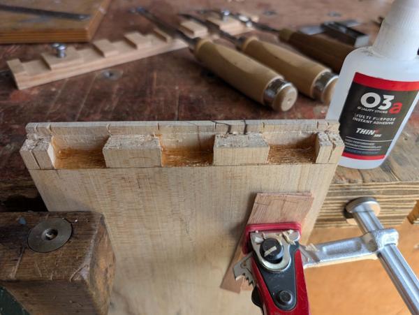

The glue faces (sides of the sockets) pared nicely, with none of the break-out of the slightly spalted wood that I had on the shoulder chops:

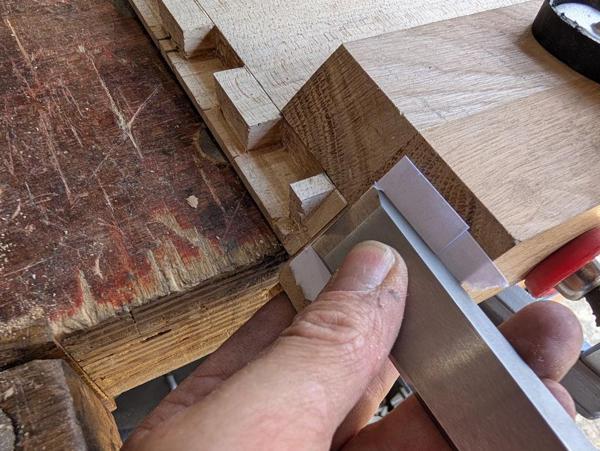

Before doing the final cut along the shoulder line, I decided to pour a bit of thin superglue into the end grain:

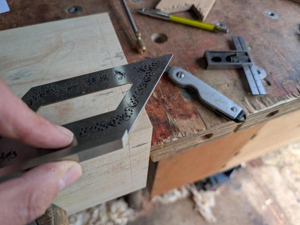

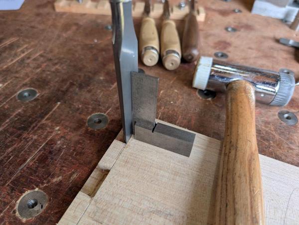

I could then chop down into the shoulder line, using an engineers square to ensure I was ever-so-slightly undercutting the shoulder:
There's still some superglue visible in a close-up photo (unsurprisingly given how broken up the surface was) but it's a much smoother finish and there's no superglue on the glue faces:

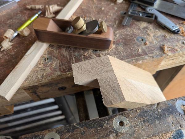

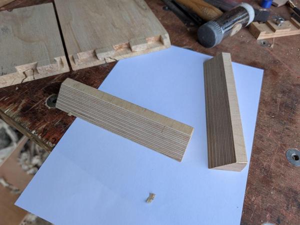

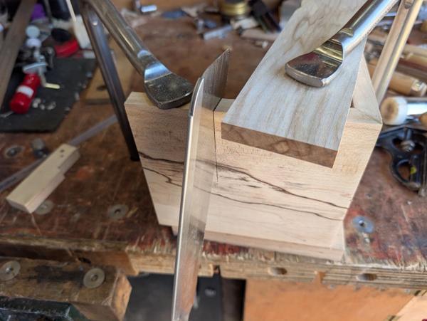

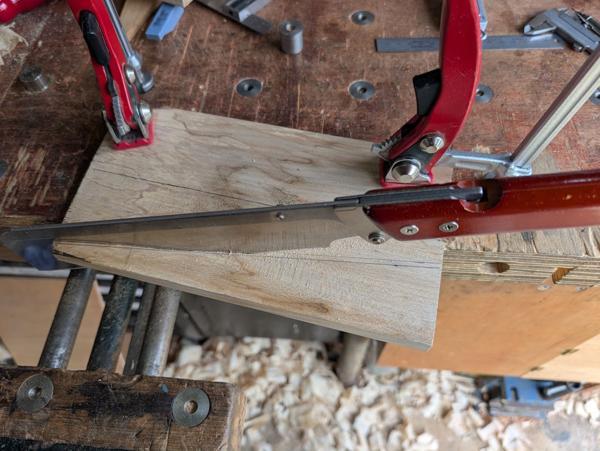

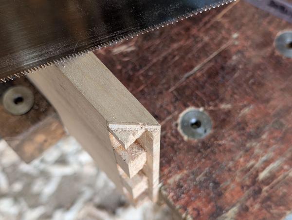

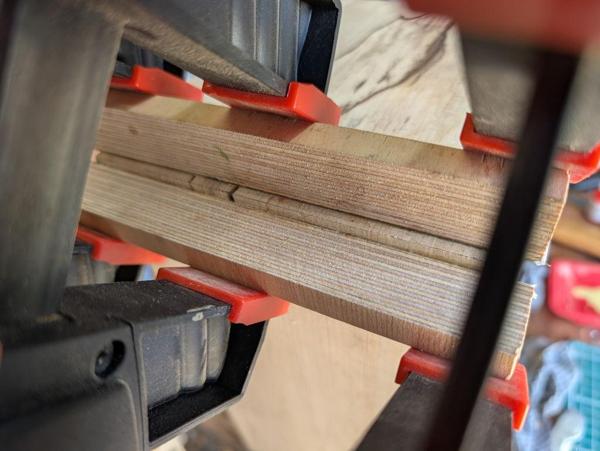

Next up was to saw the mitres with a cross-cut Dozuki, keeping well away from the knife line:

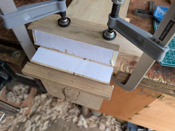

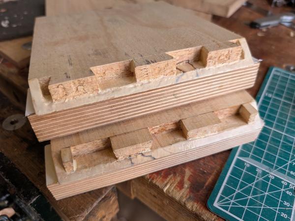

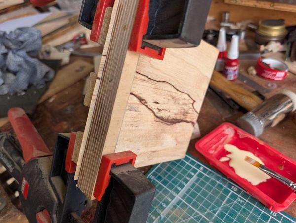

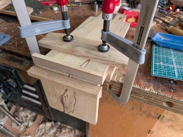

I decided to make a new mitre jig for this job. I've previously just used lumps of wood with a 45° angle planed (usually on a shooting board) on the end. I thought it would be nicer to have something that goes round the corner so I can attack the mitre from the side rather than the face.
This is one of those few jobs where my (long since sold) table saw would probably have been a preferable option but I really don't miss that saw and it's good to practise the techniques involved in doing things by hand.
I used a bit of oak worktop and my Ryoba to cut a big rebate and to roughly mitre the two ends:

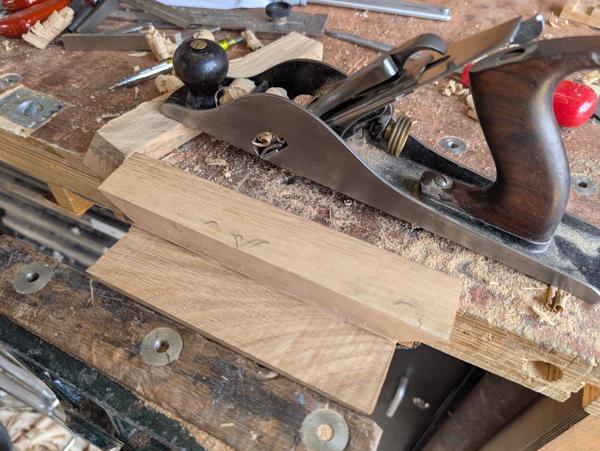

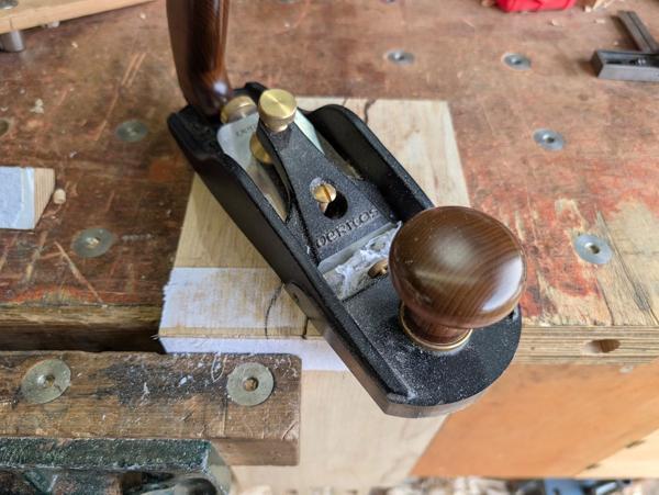

The carriagemaker's rebate plane then came out to prepare the two reference surfaces:

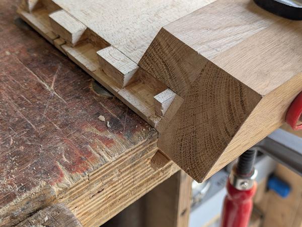

I then settled down on a stool and gradually worked at the mitres on each end with my little block plane until the surface was flat (as measured with a steel rule) and at 45° to the reference surface (as measured with a combination square). This was a work-in-progress shot (where it wasn't quite at the right angle yet); the finished shot ended up blurry so I decided to be lazy and just share this one instead:
Next up was to pare the mitres. When I've done this before (on mitred dovetails, not secret ones of which this is my first attempt) I've generally fitted the mitre guide overlapping the end and then gradually tapped it back with a mallet after each cut. This time I decided to try David Charlesworth's method, which worked really well. His method is to use bits of card and paper as shims underneath the chisel, gradually reducing the number of layers so that each chisel cut is about the thickness of a piece of paper:
That worked really well; each cut was a nice even thickness and felt very controlled. The first mitre done:

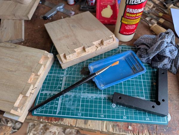

The next job is to transfer the shape of the pins onto the tail board (the long mitre gets pared later).

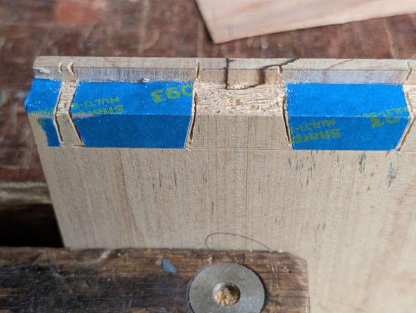

This morning I got on with the tail board. I put some masking tape on the face of the board and then used this set-up to transfer the edges of the pins across to the tail board:
David Charlesworth used a "Robert Wearing tranfer jig" (presumably from one of Wearing's excellent books). The jig consisted of two bits of plywood fixed together with a brace on the back to make sure they were fixed at right-angles to one another.
I've got a fairly well-equipped metalworking set-up, so I just used an angle plate (with a bit of plywood to make sure any slight protrusion of the tail board wouldn't hit the angle plate and stop the pin board from sitting in the right place):
This is what it looked like after peeling the tape away in the waste areas:

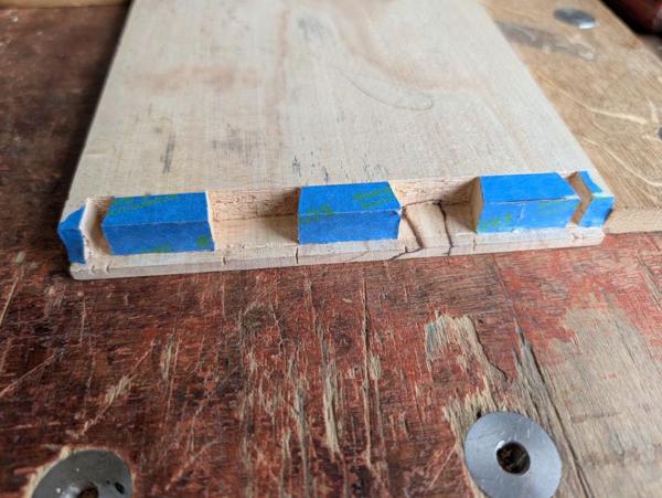

I'd originally put tape on both the end grain and the face, but I realised just before marking up that the tape would cause the pin board to be held slightly off the end grain and that would result in a misalignment (albeit a tiny one), so I removed it before cutting the lines. Before transferring the knife lines across the end grain, I re-fitted a piece of masking tape. I then sawed (at 45°), keeping a little way away from the lines as I wanted to pare these ones (which is what David Charlesworth did and if it's good enough for him then it's fine by me):

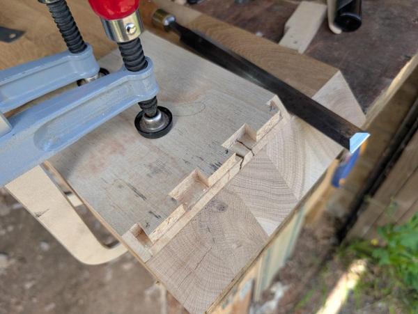

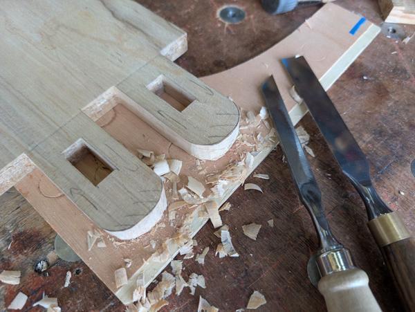

Next up was some chisel time, chopping out the waste, using angled cuts so the waste came out without any risk of damage to the tail edges:
As before, I worked to a second shoulder line and only when everything else was cleaned up did I chop down in the proper shoulder line.
The tails all cleaned up:

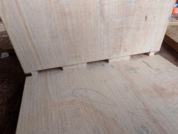

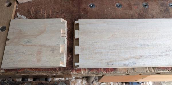

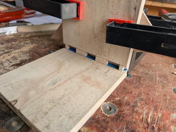

At this point, it was time to do a test fit:
So far, so good. It's goes snugly home most of the way, only stopping because I hadn't done the long mitre yet:

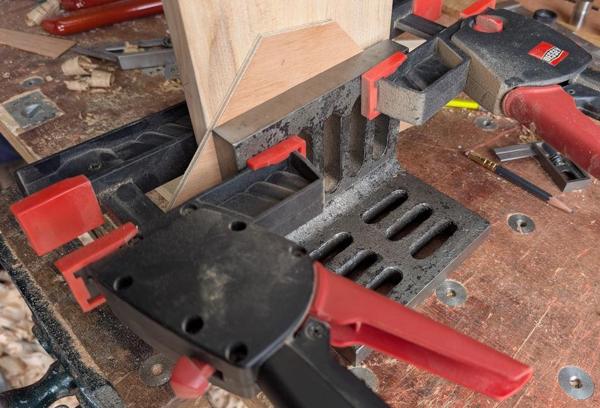

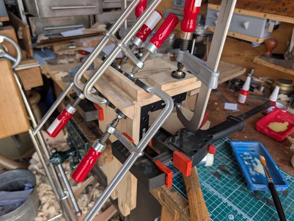

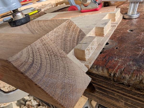

I grabbed another bit of oak worktop and cut a 45° angle in the end (I decided to be lazy and use a tracksaw this time), checking the angle against the face that's set back, being careful to align the angle gauge with the joints running along the worktop piece (as twisting the gauge would result in a mis-reading)::
After clamping the tail board in place, it was time to pare the long mitre:
David Charlesworth did most of the paring with a chisel and then switched to a shoulder plane for the last couple of cuts. I've never got to the point that I feel very comfortable or confident with a shoulder plane so I decided to just use a chisel for the whole process. This is a work-in-progress shot:
I don't seem to have a photo of the fully pared pin board, but here's the tail board:
I used a long paring chisel for a lot of the work, but also a skewed chisel as it made it easy to take slicing cuts.

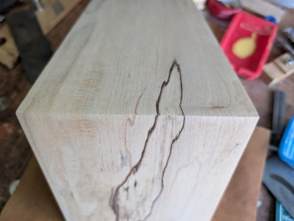

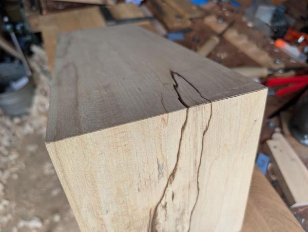

With the two long mitres cut, there's was nothing for it but to take a deep breath and do a trial fit:
As my first ever attempt at a secret mitre dovetail, I'm really happy with that. There's a bit of a gap towards the right-hand side, but it's very small and I suspect that it might close up a bit more once I've got some glue in there and clamps holding it together.
I'm also really pleased that I only need to do one of those joints for this project! Hopefully I won't make any major howlers in the next few jobs that will mean I have to start again...

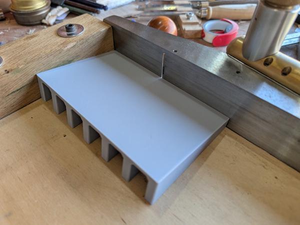

Here's David Charlesworth's:
Described by him as "quite simply, two bits of MDF or ply, screwed together and braced at 90°"
Here's a big claim: I think mine is better than his. Mine goes in the vice, and the raised edges mean that you aren't relying on perfect ends to the boards to get a right angle . I'm not explaining this well. Mine restrains both tail and pin board to a right angle, and with a right angle between them. Charlesworth's only deals with the angle between them. Here's a photo of mine in action, although most of it is obscured by the vice and the work:
Charlesworth's relies on both ends of all of the boards being shot perfectly square, because they become the reference. I don't hold to that, and use the shoulders as reference. You can see my board ends are just sawn.
I've never attempted secret mitre dovetails, so I'm not sure whether the jig would work.
I agree that yours is better than his for normal dovetails (I built something like yours into the Moxon vice on my portable workbench). I've no idea what DC uses for normal dovetails (I don't think I've seen his videos on the subject).
For the Secret Mitre ones, you need to be on the inside of the joint for marking, so you have the tail board and jig lying flat on the bench. The fence on yours would get in the way I think.

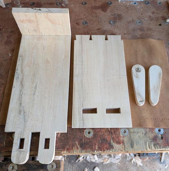

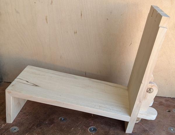

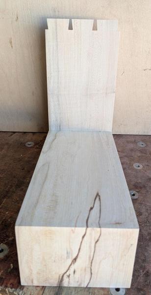

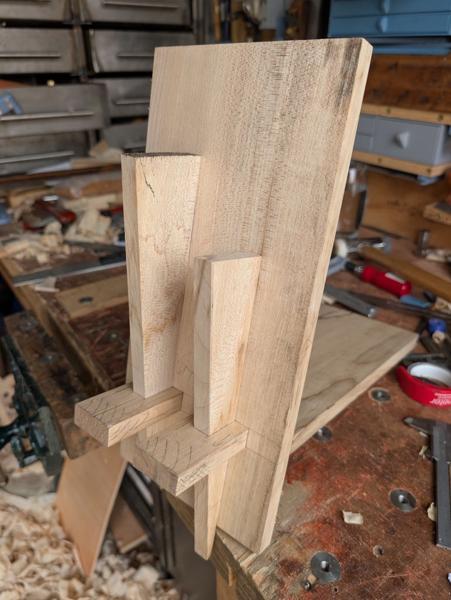

The other end of the pin board is going to get joined to another piece of wood with a tusked mortice and tenon. I'd been considering using some contrasting wood for this bit but in the end I decided to keep it nice and simple and make the whole thing out of Sycamore. To that end, I Ryoba'd a bit more off the same piece:
This time I did take a photo of the rougher side:
Getting smoother:
Smooth:

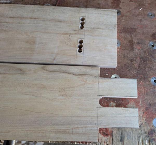

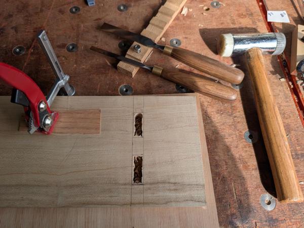

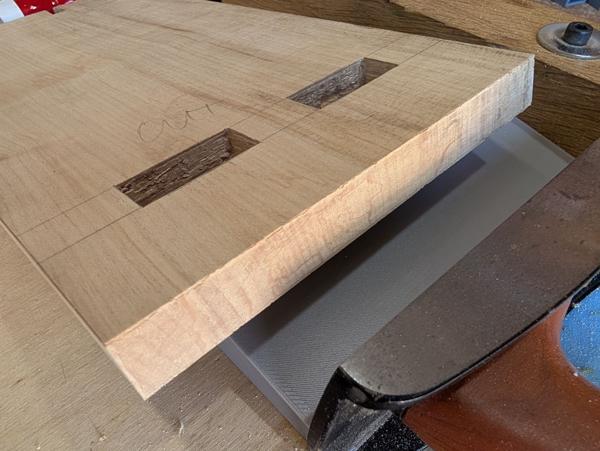

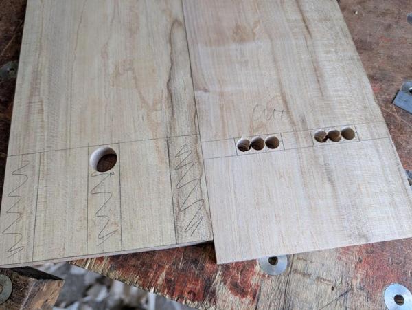

To mark out the mortice and tenon joint, I used my favourite edge distance gauge thing and a marking knife. The gauge has a long stretch so I could do all the along-grain marks referencing off the same edge. I marked both pieces on both sides and used a combination square to knife the shoulder lines:
It was feeling rather hot in the workshop so I decided to get some Forstner assistance with the stock removal, using a 22 mm Forstner bit for the bottom of the central section of the tenon board and a 12 mm one for the mortices:
The ends of the tenons will be visible and hence I'd like a reasonably good surface finish. To that end, I'll chisel them rather than trying to saw to the line. Sawing the tenons (away from the line) was done with the saw held at a steep angle, attacking first from one side and then from the other:
However, the tenons are rather long, so I couldn't saw down the middle without the back of the saw hitting the end of the board. I could have used a (back-less) Ryoba, but its plate is a lot thicker than that of the Dozuki I'd started with. Fortunately, my other rip Dozuki has a bit near the tip that is back-less so I was able to do the last little bit by taking short strokes with that saw instead:
That's as far as I've got today and I needed to come in to do some non-woodwork stuff for a bit. Tomorrow I'll chisel to the lines:
Once that bit of the joint is complete I'll mark up for the other mortices (the ones in the tenons into which a wedge will go).

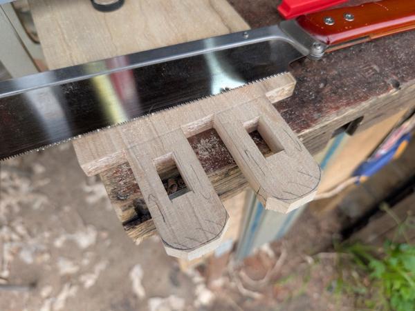

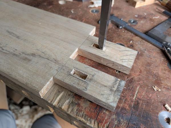

This morning I had a very pleasant session with the music on and the chisels out. I didn't take many photos, but this was part way through chopping out the mortices:
I was really pleased with the fit. It needed a tiny bit shaving off the end of one of the tenons, but that was it:

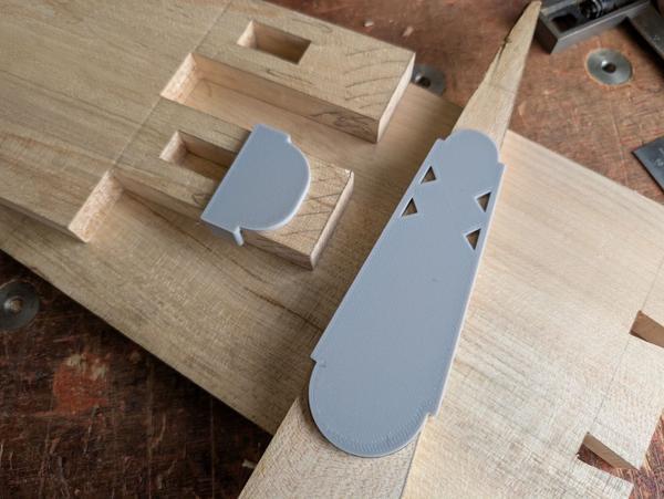

With that done, it was time to chop the inner mortices, using my 8 mm mortice chisel:
I very nearly messed that up: as I was part way through chopping I realised that the angled end (for the wedge) had the angle going the wrong way. Thankfully, there's plenty of tenon on the end so I just made it a bit longer than originally planned and all was well.

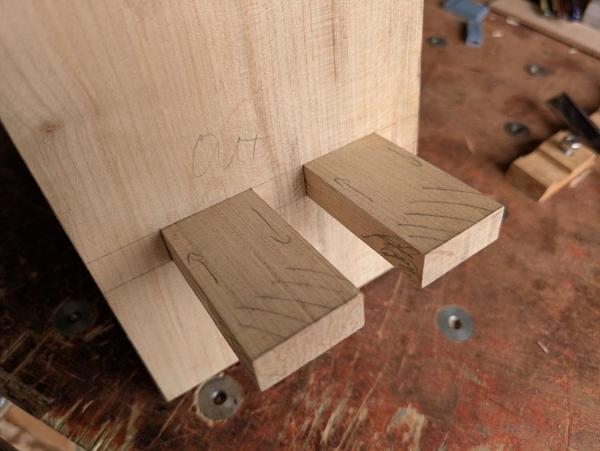

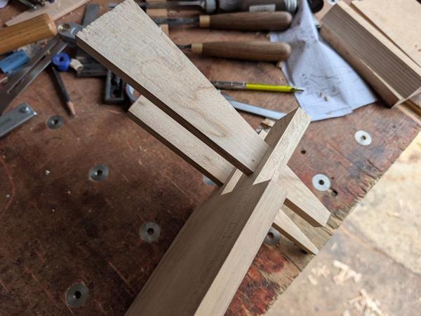

The wedges came from this off-cut of Sycamore:
Test fit in the holes...

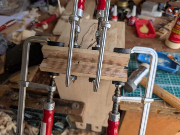

... and in the assembly:
They're obviously a bit long at the moment (although I intend to keep them quite long as they provide a bit of support to the upright).

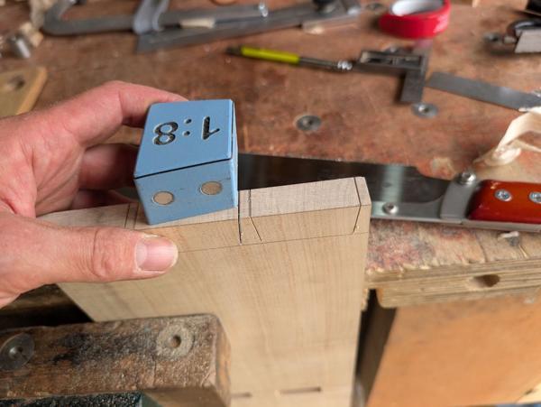

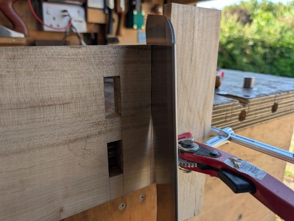

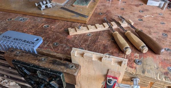

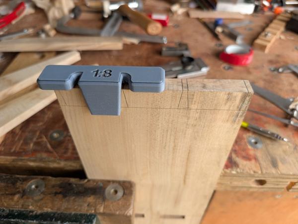

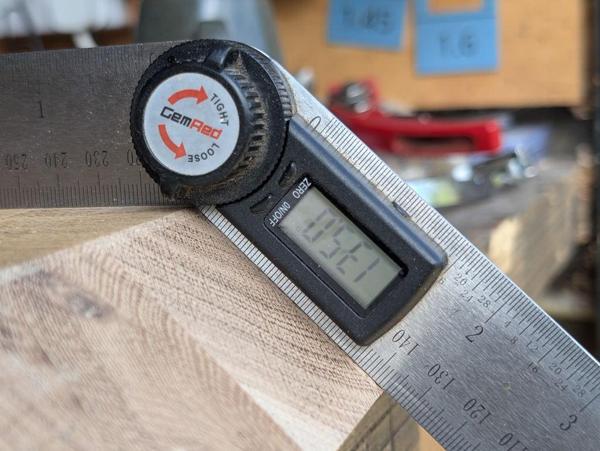

Next up was to cut some dovetails into the other end of that board. Rather than just eye-balling it, I decided to mark the angles and tail spacings carefully:
As I want the tails to all look even here, I pulled out my sawing guide. I don't use this very much any more, although it was invaluable when I was learning to cut dovetails as I could focus on practising marking and chiselling and not have to worry about sawing. Once I'd mastered the other areas, I ditched the guide and just focused on sawing.
In this case, however, I'm being more picky about the angle and the smoothness of the tail sides, so the guide seemed a good option:
I then spent a fair while taking cutting across the end grain with a 7 mm chisel, being careful to take light cuts to minimise the chance of break-out (normally this wouldn't matter much but in this case I wanted a fairly clean surface). All done:
This is a bit of whimsy really: those dovetails are purely decorative, i.e. they won't have a mating half. I haven't decided whether to round the arrises off yet, but I'm leaning towards doing so. Leaving the edges sharp would be more true to a typical dovetail shape, but chamfering the edges would minimise the chance of breakage, splinters or just a sharp edge causing a cut.

To give consistent shapes to the wedges and the ends of the tenons, I 3D-printed a couple of marking gauges and used them to pencil some curves onto the parts:
Those little arrows on the wedge marking guide are just there as a sanity check: the pencil lines I drew on the wedge (above and below the tenon) when in situ are visible through the arrow holes. As you can see, most of the wedge is going to be above the tenon, providing a bit of support against any twisting forces trying to open up the joint.
The bulk of the waste was removed with a cross-cut Dozuki:
Shaping was done with a pair of chisels: a skewed one that got rid of most of the waste in a slicing action and then an 18 mm bevel-edge chisel to refine the shape:
Two wedges complete:
It was now time to start thinking about assembling the first joint (the secret mitre dovetail). I'll do the joints one at a time so I can plane the face of the pin board before inserting its tenons into their corresponding mortices. Before assembling the first joint, I gave the inside faces a very light go over with a finely set smoothing plane:
I thought it was a good idea to take a photo of the inside of the joint as it'll be completely invisible (hopefully!) when assembled:
I made a pair of clamping blocks out of a bit of 23 mm plywood I picked up at the Bristol Wood Recycling Project. An angle was cut at 45° with the tracksaw and then a straight cut separated the second block:
David Charlesworth made his clamping blocks out of the same wood as the joint, but his pieces were quite a bit thicker than mine and I figured a larger surface for the clamp to bear on would be a good thing. A quick drawing (in CAD) confirmed that the line joining the middle of those two 45° surfaces should go through the centre of the mitre joint.
David Charlesworth glued his clamping blocks directly onto the work-pieces and then removed them after the glue up by bandsawing the bulk away and then planing the remainder. I decided to try a technique (often used in woodturning as I understand it) for attaching temporary blocks using paper and glue (with the idea being that the clean-up is easier). I sent a message to @Woodbloke, who had previously suggested the technique to me when I was turning a few bowls. He kindly sent me a quick write-up describing the process. Hopefully I've followed his instructions correctly!

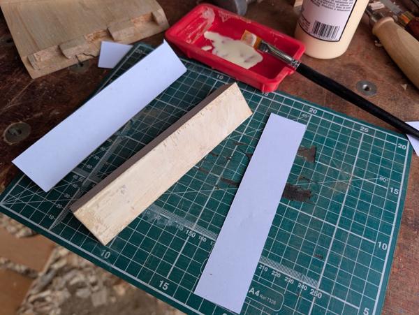

I started by cutting a couple of pieces of (90 gsm as that's what I had) printer paper to match the size of the clamping blocks. Initially, I tried applying some (Titebond 1) glue to the paper but the paper disintegrated so I cut a new piece out, applied the glue to the plywood and then stuck the paper to it.
I then applied another coat of glue to the paper (which coped much better with the wood backing) and then applied it to the Sycamore work pieces, leaving a few millimetres from the tip of the mitre so that joint can be seen when doing the final glue-up.
After leaving the glue to dry for a few hours, I decided to do another dry fit and see whether the clamps would close up the gap. Looks promising to me::
With all that done, there was nothing for it but to get on with gluing the joint together. I assembled the bits needed, some of which are in this photo:
Glue got applied to the sides of the tails and pins and to the mitre surfaces. As with other types of dovetail, I didn't bother applying glue to any of the bits of the joint that would be end-grain on face-grain.
After gently tapping the joint home, I fitted four small F-clamps:
By moving the F-clamps further towards the tip (i.e. into the camera in that photo), the joint can be opened up (i.e. it increases the included angle). Alternatively, moving them further away from the camera and tightening them reduces the included angle. By that means you can tweak the fit until it is a perfect 90°.
Once it was set at 90° and the four clamps were firm, I clamped a couple of right-angle blocks in place to make sure it stayed at that angle:
That's all I can do for now (which is probably a good thing given the temperature of the workshop). When the clamps come off and I remove the clamping blocks and clean up the outside surfaces we'll get to see how the joint turned out. Wish me luck!
After dinner I got impatient and decided to go and have a look at the joint. I took all the clamps off, then clamped the part to the workbench so I could hit the clamping block without putting any force through the dovetail joint:
With a couple of whacks the paper split:
To plane the shorter board, I had to plane towards the joint, which wasn't ideal, but I did most of it with a finely set smoothing plane, pulling it towards myself...
... before whimping out and switching to a card scraper. For the longer face I could go in the more natural direction so that was easier.
This is what it looks like now:
Very smart!
Especially if you know it's not just a butt joint, hidden underneath veneer... 😏
You had better keep the wip images of that joint alongside the finished project just to prove that it is not just a simple mitre to future generations. Great stuff.

The first job was to do a little bit of simple maths to work out offsets and then to scribe a couple of lines on the ends of the two parts:
After setting up a sliding bevel to 10°, I could transfer the marks all the way around the outside (checking and double checking I was pointing the bevel in the right direction):
I decided to be brave and saw directly to the line, so after pulling out my cross-cut Dozuki, I took a deep breath and started sawing. I worked across the narrow edge first and then gradually lowered the saw to cut down the face, without cutting (at least very much) into the face on the far side:
I managed to keep to the line (despite the constant flow of sawdust into my eyes as a result of the big fan I had blasting air at me to help cool the workshop down a bit) so I was really pleased with that. After doing the first edge and face, I flipped the board over and did the other side to separate the parts. There was a slight notch where the two saw cuts met, but it was minor enough that it would be easy enough to plane away.
For the other part, the workholding was a bit more complicated and I had to pull out my (infrequently used) hold-fasts as they can grip taller things than the usual ratcheting ones I use. This was the set-up for the cutting the first face...
... and this is what it looked like after finishing the second face cut:
I was even happier with that one, with only a very faint mark where the two saw cuts met.
To help plane the end-grain, my 3D-printer had made a little ramp for the shooting board:
The ribs on the bottom are just to speed up the printing time (it took about an hour and a half to print).
Shooting the end made it look this, with just the barest sign of the knife line still visible:

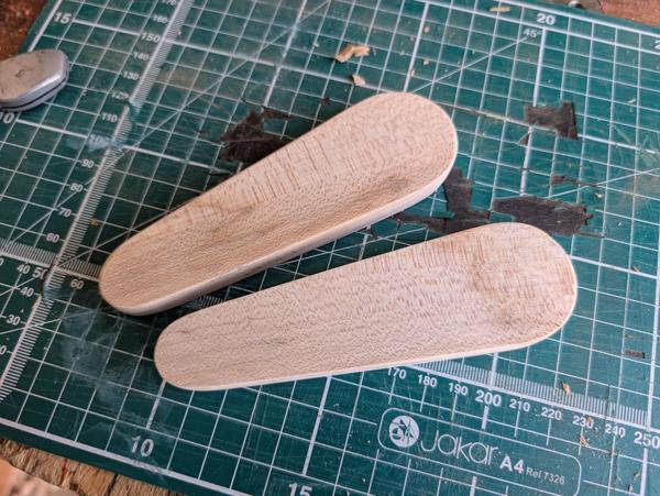

Earlier in the week, I'd put one of the wedges into the 3D printer and used its laser to burn my logo into the face. That took a bit of thought to get the angle right: I wanted the logo to be upright when the final assembly is complete. I clamped it in place on the bed with some magnets:
Then used the built-in camera to get a birds-eye photo. I could then use an image editor to measure the angle of one of the sides and hence calculate the angle that the logo needed to be rotated by.
I usually leave a planed finish on the stuff I make and rarely do any sanding but for this project I decided I'd run the random orbital over everything as I was feeling a bit nervous of messing up that secret mitre dovetail. Everything had been previously smoothed out with a smoothing plane, so I went straight to 240 grit and it didn't take long to run it over everything.
With that, the parts are all (probably) ready for assembly:
I decided to do a dry assembly first so I could see how it looks. I'm planning to glue the mortice and tenon joint together and then glue the wedges in: there's no real reason why this ever needs to come apart. I guess you could call this the big reveal of what it's going to look like, starting with what will eventually be the back view:
End-on you can see the grain flowing all the way along (most of which will eventually be hidden!):
I was happy to see the logo and the year ended up parallel with the bench:

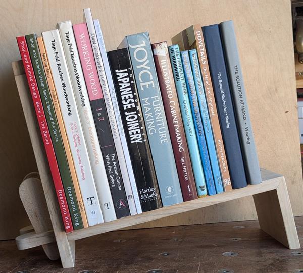

Just in case you haven't figured out what it's for, this is a little test with a few of my favourite woodworking references:
Once it's glued together and oiled, it'll be heading for my desk at work, so will end up with far less interesting tomes on it!

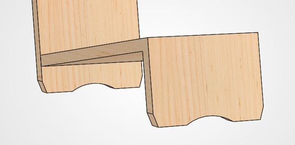

I had been pondering adding some shape to the ends of the feet (perhaps just cutting a curve out of the middle or doing that and chamfering the corners), but seeing it together I quite like what it looks like at the moment. This is the sort of thing I initially had in mind:
I'd welcome any thoughts on whether that would be a good addition or not (although I reserve the right to make my own mind up). One advantage of leaving the ends square is that I wouldn't have to worry about getting a good finish on a curved bit of end-grain!
