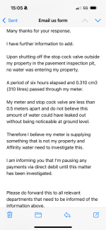

Further investigation required - I shut off the stop cock located in an inspection pit outside my property boundary in the pavement. All water shut off to my house, nothing coming through the taps.
Here’s a photo of the two inspection pits (ignore the third metal cover, my son found it further down the road and insisted on putting in in the photo…)
Here’s a photo of meter reading.
I went out for six hours and returned to this reading.
That 0.31 cubic meters of water that have gone through my meter in six hours while supply shut off to my house.

I’ve written to Affinity via their online form saying I think there is an issue with my meter but have not received a response in the time they suggested they would respond.
I haven’t shared any of my findings and am reluctant to as I know I’ll more than likely be fobbed off about leaks on my side of supply to house, which I think isn’t possible in this situation.
I’m not particularly experienced in these things and get very frustrated having to try and speak to someone/many people in large organisations that don’t understand what I’m saying or how to take notes on my account so the next person to look can try and make head or tail…
Essentially I want to immediately stop my direct debit and inform them of this due to a metering issue. £924 per year for water is insane. I’m not even in my house for about two months a year as we go abroad to visit my wife’s in laws.
What’s the best way to go about this based on the information I’ve given? I’d be really appreciate if someone has had similar issues with utilities companies and how to deal with them?

When you talk to them, I'd leave out the theorising and stick to the absolutely concrete.
  • You shut off the stopcock so that no water was flowing to your house, and your meter showed 310l of usage over six hours, with the stopcock closed.
  • Your meter and stopcock are <distance> apart and you do not believe that a leak between them could have shed that much water without being noticed at ground level.
  • Therefore you believe your meter must be supplying something that is not your property, and they need to investigate.
Leave out the theories of supplying someone else's house - let them come to that conclusion themselves when they send someone out to look. Their engineer's report will carry a lot more weight than, as far they're concerned, a customer who doesn't want to pay the bill.
Keep everything in writing. Water companies operated under the Guaranteed Standards Scheme, which puts pretty strict limits on the time they have to make a substantive reply to a written query or complaint. Keep copies of all communication, so that if they don't sort it out to your satisfaction you can paint a complete picture of the process if you need to escalate. That said, no need to go in guns blazing from the beginning. Give them a chance to sort it, but be prepared for the chance that they won't.

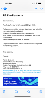

I received a response to my initial communication with Affinity Water before making my post above.
I’ve subsequently responded to this with the useful info and tone provided by everyone.
Shall see what happens. Fully expecting they be in comms as soon as the next direct debit payment can’t be taken… 😜
Low and behold, a few days after my direct debit payment should have been paid, I received a call from Affinity acknowledging my email, and wanting to book an appointment with an engineer/technician.
Young lady was awfully apologetic and proceeded to tell me that any account irregularities and payments would be rectified upon conclusion of investigation.
This suggests to me that Affinity know that there is a problem, or why would they be so apologetic without having done any investigation?
On speaking with neighbours further down the street, it would appear that they are suffering from similar problems.
I’ll report back after June 17th appointment with findings.
If anyone was interested - I wasn’t at home when the gent from Affinity arrived, my wife allowed access to the house. He was there for less than five minutes and these were his findings.
I’ll await communication now re: sorting future payment and refund for payments made.

Afternoon for anyone interested in this one.
Had correspondence from Affinity Water yesterday.
I've read the email a few times and I'm still confused.
How do they know that 25M3 is the correct amount of usage from 1st February until 17th June? Affinity have admitted that there was no meter supplying my house in the above.
I'm also out of pocket big time on the direct debits which have been made. There is no suggestion in this email of refunding me anything.
Where do I stand on this? Surely I should be refunded all paid monies, then a new bill issued?
Thanks, Sam.

Absolutely… reply raising those very concerns.
If there's no meter, then they generally work on assumed usage based on the type of property - I think they just count bedrooms, but there might be more to it. Either way, if they can't measure your usage then you're billed for something approximating what an average property of that type usually uses.
Utility companies generally work on an account basis - any money they collect via direct debit goes as credit to your account with them, and when they issue a bill they'll debit that amount from your account. That's what lets them collect a constant direct debit amount even when usage varies over the year.
What I'd expect to happen is that they issue you a new bill with the lower usage, and your account balance with them goes massively into credit as a result. Then they'll probably adjust your direct debit to some tiny amount until you burn through that credit, before moving it back up to reflect your actual metered usage once they know what that is. You won't be out of pocket in the long run, except in so far as you'll be loaning them money at zero interest. They probably can refund you the credit balance, but they don't generally like doing it so you'd have to ask and might need to be quite insistent about it.
