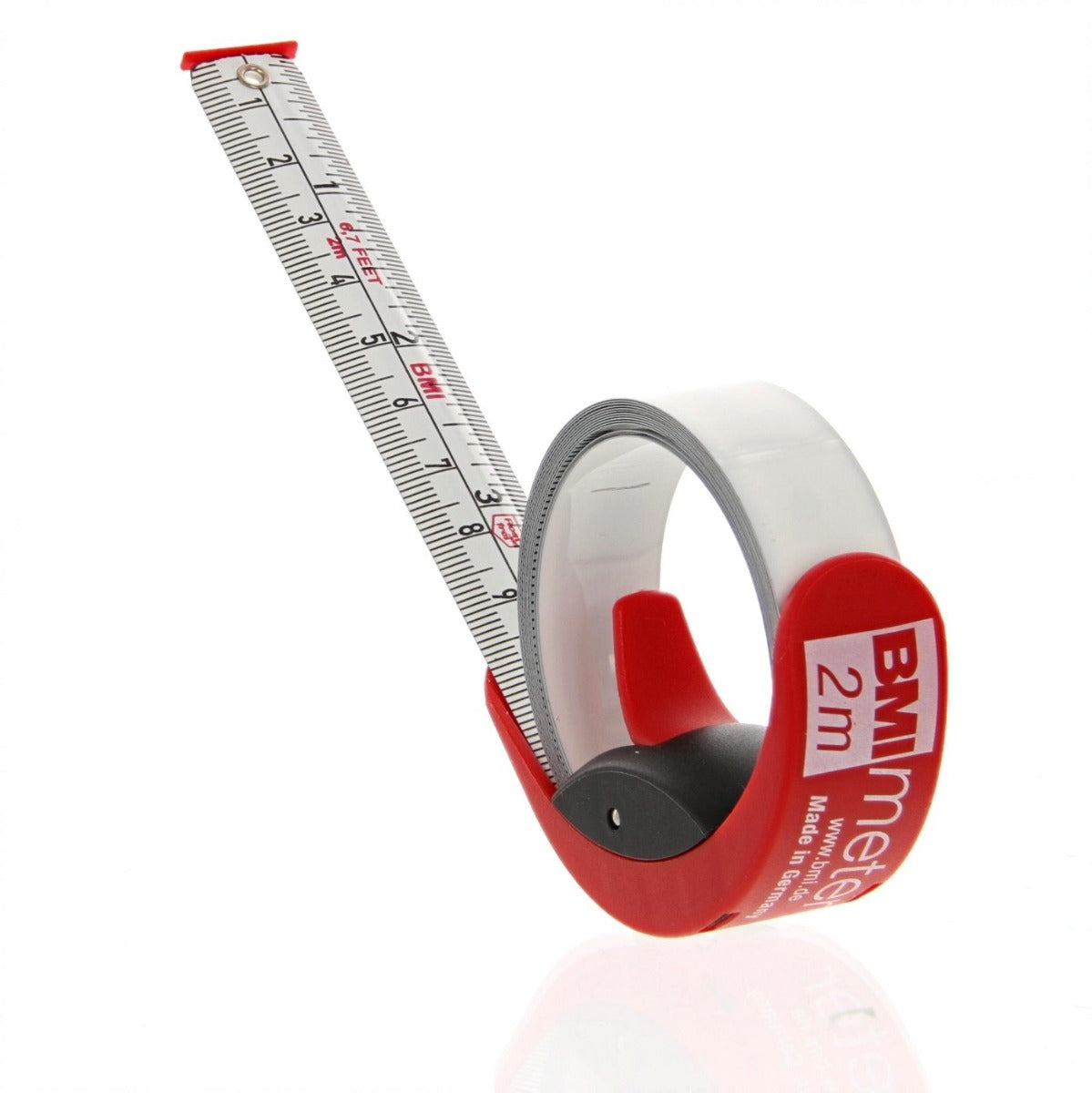

The ones I use the most are the frame-less bmi-meters, but they (especially the metric only versions) are not often available in the UK for a sensible price. They do pop up on ebay (new) occasionally though. You can buy them from RS but they're quite expensive. I've also just found them on thetapestore and the prices look a little better.
They look like this (2 m and 3 m versions exist):
The tape is curved the opposite way to most tape measures so you can use them to draw along (as a straight-ish edge). They're also light enough that if you hold the tape against the wall, the body also stays on the wall rather than sagging down & twisting the tape.
The downside is that they don't have a hook - they're more for measuring up to edges. Nevertheless, it's rare I reach for anything else these days.

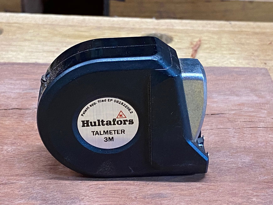

I've also got a hultafors talmeter (as suggested by @Lurker) which is great when you do need a hook.

Most intriguing Al, still not really sure what the benefits are exactly but I did find this site that has a short video, ( I couldn’t listen as Pam was asleep.)
My plumber uses the BMI tape. Bought one and I don't like it!

I have one of the BMI tapes, it lives next to the bench and is handy when marking out, the benefit of them is that the blade lies flat so they are basically like a long ruler.

Just like Lurker I really like Hultafors tape measures. My other go-to brand is Tajima. To reduce the chance of mismatches I prefer to buy class I tape measures. Next to that I mark all my analogue measuring devices with a red or green sticker. I always check analogue measuring devices against a DIN 866 B ruler. Is the deviation over 1 meter more than 1 mm, then it gets a red sticker. Is it less, then it gets a green dot. I also try to check for any significant deviations along the length, not only at the end. I do this even with the rulers fixed to my machines. That is also one of the reasons I prefer digital tapes nowadays (the M507 are great). It is easier to calibrate them all to the same gauge block, which makes sure all measurements are equal.

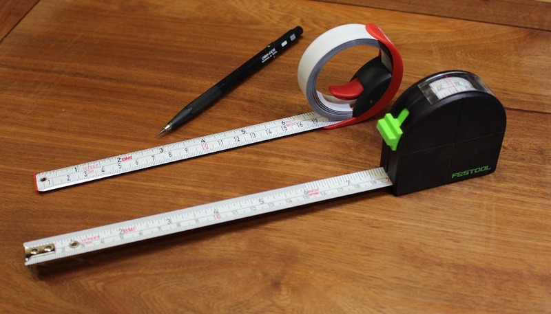

I also got one of the Festool ones (the only Festool product I'm ever likely to own !) with a fold out spike and pencil holes for striking radii, a clear window on the top that uses a scale printed on the back of the tape for internal measurements. Nice ideas, but has a tendency to jam up a lot, requiring re-assembly.

The Hultafors is of average thickness and a bit heavier that most tape measures. The Tajima is lighter and all rounded, so it is better suited to carry around in your pockets. Moreover, one of the handy features of the Hultafors is also a downside: it has a sharp point on its lip that can be uncomfortable when you put it in your pocket.

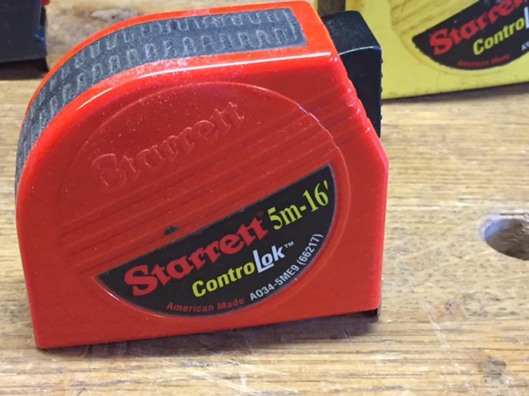

For general purpose measurements I use metal case 5 m Stanley power lock, the ones with 3 rivets in the tape end, tried others but they don't seem to last.
For bigger measurements and measurement between two adjacent surfaces I now use a leica disto.
For rod work it's mainly steel rule, most machines are set up with DROs that are calibrated to Stanley power lock……all the above would change if I went back to cutting roofs again or building bridges……the splash a Stanley tape or Estwing hammer makes when disappearing forever is not nice
