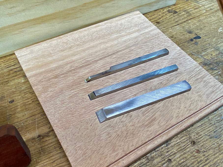

A few comments from someone who's made their own irons.
It's not especially difficult, particularly for a plane without a blade adjustment mechanism (a #43 or any wedged plane). For this one, you'll probably want to shape the blade blank a bit (you'll notice it's wider where the wedge is compared to where the cutting tip is). I would do that with a milling machine as I have one, but you can do it with a hacksaw and some decent hand files. The only other tools you'll need are a pair of pliers and a blowtorch; for small blades like these the sort of thing a plumber uses for copper pipe soldering would be fine. A magnet is handy, preferably one you can fix to something (e.g. with a screw through the middle).
The process of making a blade for that plane would be something like this:
  1. Buy some gauge plate / O1 tool steel / high carbon steel in the same thickness and width as the existing blade.
  2. Cut to length.
  3. Hacksaw/file down the end near the cutting tip to the width you're targeting.
  4. File a rough bevel on the end (to save work on the stones later).
  5. File some relief on the sides (so it's very slightly narrower on the side that gets to the wood last than on the side where the bevel meets the flat face). You only need to do this near the tip and, if you prefer, you can do it after hardening using sharpening stones.
  6. Hold it in the pliers and heat it up (focusing on the tip) until the tip is glowing a bright red (generally called "cherry red" in descriptions I've read).
  7. Check it's hot enough by offering it up to the magnet. If it's hot enough, it won't stick to the magnet.
  8. Dunk in some vegetable oil and move it around slowly until it's cool.
  9. Clean up all the scale that will have built up on the surface using sandpaper or a sharpening stone). There are ways to make this step easier, but I'm going for the minimum tool option!
  10. Heat it up again with the blowtorch, this time focusing the heat away from the tip. Watch the colours move along the tool. You'll see a straw coloured stripe followed by a blue stripe. When the straw coloured stripe gets to the tip, dunk it in the oil again. If the blue coloured stripe gets to the tip, go back to step 6.
  11. Get the sharpening stones out and make it sharp.
  12. Try it out!
It's also worth having a think about how you'll hold your boxes. One of the things I like about my #43 is that it's small and doesn't protrude much over the box side. That makes it easy to support the box sides being grooved with stops or, if required, clamps. As plough planes get bigger, they work better on big things but become a bit cumbersome for small boxes.

Yes, that looks like a blowtorch and should do the job just fine.
Gauge plate is an English/British term for (harden-able) tool steel that's typically provided accurately sized (by grinding to size). In the US, I think it's just called O1 tool steel (the "O" meaning hardened by quenching in oil). It's also known as "ground flat stock". Lots of names for what is basically the same thing.
For comparison, if you want to make hard things from round steel, then generally the easiest unhardened option is called "silver steel" in the UK or "drill rod" in the US. Also referred to as W1 tool steel as it's generally hardened by quenching in water rather than oil, although either W1 or O1 can be quenched in either water or oil - the results might not be quite as good with the "wrong" liquid, but it'll work.
I'd really recommend getting yourself a copy of Tubal Cain's book on hardening. It goes into far more detail than you need but covers the basics well (and has a nice colour chart showing what colours correspond to different temperatures).

I use a MAPP torch I think you might have problems with that gas torch getting to the right temperature.
Some fire bricks will help to concentrate the heat. I made a crook knife blade with a MAPP torch and fire bricks and it heated the blade very quickly and evenly.
The easiest way to judge the temperature is with a magnet on a stick it will stop sticking to the blade when it’s hot enough, then polish the blade and temper it by slowly heating it until it turns to a straw colour and quench.
I don't want to put you off having fun making your own plane irons, but original Sheffield made irons from the 19th and 20th centuries are pretty easy to find in the UK, if you are able to shop over here.
That's true for bigger blades, but for a plough plane blade a propane torch will be fine.
Insulating fire bricks help a lot. Refractory fire bricks hinder a lot (as they soak up an awful lot of the heat). The latter is good if you want the heat to hang around for ages (e.g. to keep your radiators warm), but not good if you want intense heat for a short amount of time. Unfortunately, the term "fire bricks" can mean either.
For a plough plane blade, a small plumbers blowtorch pointed at the tip will get it up to cherry red very quickly, regardless of whether any fire bricks are involved.

If you have a bench grinder and want a really easy option for making blades for simple plane like this, you can buy 3 mm thick HSS flat bar (I got mine on ebay) in various widths. I bought some in 3 mm, 4 mm, 5 mm and 6 mm widths. All you then need to do is cut to length (with angle grinder, dremel or, at a push, bench grinder) and then grind a bevel on the end. No blowtorch required.
If you don't have a bench grinder or can't find HSS flat bar of suitable lengths, then the process is the same as I described earlier (with gauge plate and a blow torch).

I made blades for mine from 3mm M2 steel (HSS). This was purchased cheaply, to width, on eBay. Use an angle grinder to cut to length and grind a 30 degree bevel. HSS will not be affected by heat, and it takes and hold a great edge.

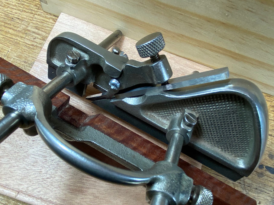

Back on topic, I suppose I'll have to learn how to use the plane. Is it assembled correctly?
WhatsApp Image 2025-10-27 at 6.20.10 PM (1).jpegWhatsApp Image 2025-10-27 at 6.20.10 PM.jpeg
Imagining it is, I guess I'll need to practice a bit, because the grooves do not come out very precise...
