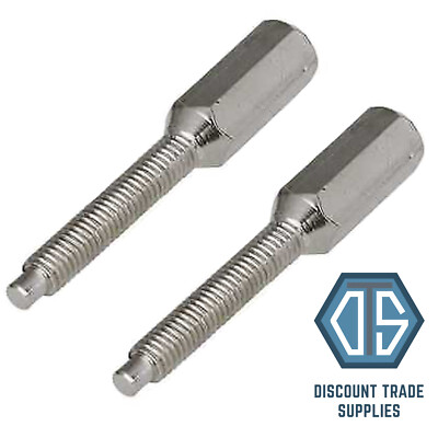

I found I had to buy M3.5 screws as well but apart from that the tool worked well, stopped me having to
remove the whole box.
As Jim mentioned, the standard thread for electrical accessories is M3.5. An M4 screw will fit through the holes in most faceplates, and if the lug is knackered beyond the ability of the tool above to re-thread, then tapping it as M4 and using one of those is often a viable fix. There are also exorbitantly expensive products on the market to rescue a lug which is completely gone, and some other nuclear options which will work (and not technically break the wiring regulations) but also have some future electrician think "who the hell did this?". I'll save those for if re-tapping in either size doesn't pan out.
So, first thing I'd try is re-tapping at M3.5 using that tool. If that doesn't work, tap it to M4 and try that. If neither works and you don't fancy spending silly money, report back and it's time to get creative.

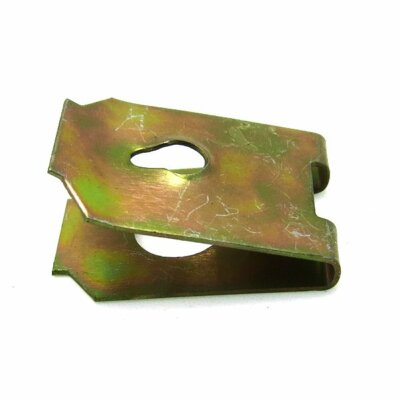

U nuts?
