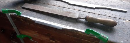

I clamped the blades to the bench and shaped the bevel by filing.
Shaping the bevel
