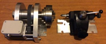

I then moved on to the indexer, plain aluminium frame to hold a ER32 collets plain bored shaft and the stepper motor with 3 to 1 reduction for holding position.
(132.32 KiB)
Once complete put power to box - box to stepper indexer in now working as it should be with a complete range of collets, then started thinking what if it had a 4 jaw chuck on it, so made two back plates to fit the nose thread of the ER32, one for a 125mm 4 jaw and one for a 80mm 3 jaw this now gives me many options.
(164.99 KiB)
Next I made a tailstock to suite.
(487.25 KiB)

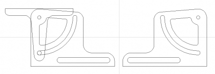

Been thinking on the table design and I am going with this for the brackets:
(5.61 KiB)
This will have a form of slotted table so you can say hold down a plane blade or chisel and could also be used to machine angles on the miller if needs be.
Phill
