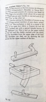

Postby AndyT » 20 Sep 2021, 07:00
Brilliant! And you've gone to the best source for the instructions. I'm sure yours will be bang on 45° and 90° and be really useful.
There's another feature of the 90° side that I didn't mention, using it to saw tenon shoulders. There used to be a special vice used by chairmakers, in conjunction with a saw with the blade attached to a flat block. A chair leg or frame side is clamped in the vice and the saw is run round it, cutting even shoulders to define a tenon. This is especially useful on curved pieces that need a square tenon.
I think there's a diagram in Salaman or maybe in Roubo. Anyway, you can use the square side to do something similar. Or you could use that mitre saw - is it an old American one?
Edited to add pic of armchair saw
(136.29 KiB)
AndyT

Postby rxh » 20 Sep 2021, 21:11
AndyT wrote:Brilliant! And you've gone to the best source for the instructions. I'm sure yours will be bang on 45° and 90° and be really useful.
Thanks Andy - I have never heard of an armchair saw. I may have to make one now :)
The mitre saw is a Nobex, from Sweden, dating from the 1970s (I think). The saw can be re-sharpened but its plastic handle disintegrated and so I made a wooden replacement.
