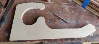

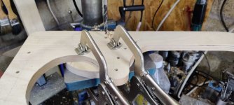

The first job was to draw round the template (on some 18 mm birch plywood) and go round with a jigsaw to rough-out the shape (cutting a few millimetres outside the line, which isn't visible as it's on the other side of the plywood here):
(20.29 KiB)

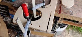

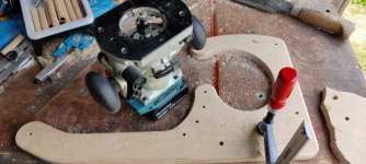

I then stuck the template down to the plywood with some double-sided tape (crossing my fingers that it would come off easily enough later!) and used some wood filler and masking tape to fill in the small indents that resulted from the template being made in four parts rather than all as one big piece.
Then it was time to set up the router table and install a pattern following router bit to finesse the shape:
(25.85 KiB)

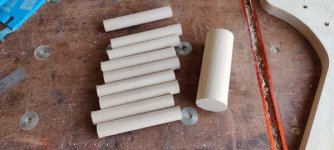

All the dowels cut:
(22.83 KiB)

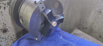

I don't have a woodworking lathe and I don't really like turning wood on the metal lathe (sawdust is great at soaking up all that protective oil :( ), but I couldn't think of an alternative so I put a rag over the slideways and got on with it :obscene-drinkingbuddies:
I started by making some quick soft plastic jaws out of some acetal bar I had in the drawer. These screw onto some two-part jaws I made a few weeks ago out of some commercial one-piece soft steel jaws. I could then bore a 16 mm hole in the plastic jaws to hold the dowels nice and concentric without risk of marring them.

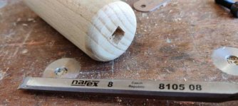

I then used an 8 mm chisel to open the hole up slightly at the outer end to accept the square bit of a coach bolt:
(21.8 KiB)

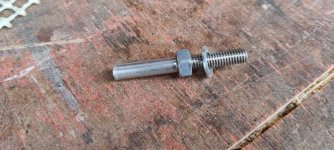

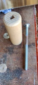

The coach bolt I found in the drawer isn't in the best condition, but the head should clean up okay and the rest will be hidden in the peg:
(23.34 KiB)

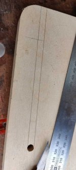

The first job was to mark out the location of the slot. I started by drilling an 8 mm hole at the end of the slot:
(34.29 KiB)

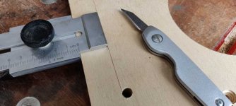

I then used my edge distance gauge thing to mark two lines, tangent to the drilled hole and parallel to the bottom edge (on both sides of the board):
(29.99 KiB)

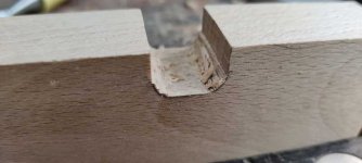

... and clamped a bit of PAR oak to the board and used it as a vertical reference for chiselling out the rest of the waste. I did this four times: both sides of the slot and both faces to half-way as that seemed like a good idea.
(34.22 KiB)
(30.32 KiB)

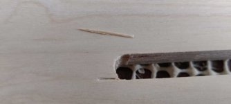

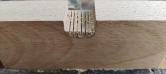

Sanding caused a little chip to pull out from the side of the hole I'd drilled earlier today. I hadn't noticed the chip before, otherwise I would have removed the bit & glued it back in again before sanding. However, I found some other little bits lying around and one of them wasn't too far off the right size:
(15.56 KiB)
After gluing and sanding:
(19.17 KiB)
Not perfect, but it'll have to do.

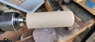

To sand the pegs, I made an extremely high tech mandrel by hacksawing the head off a cap screw:
(46.75 KiB)
That could go in the cordless drill and I just held a bit of 240 grit sandpaper in my other hand and kept going until it looked smooth enough.
Before:
(23.83 KiB)
After:
(24.72 KiB)

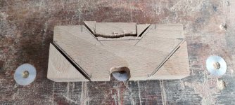

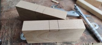

I wanted the inkle loom frame to nest slightly into the feet as I figured it would be a bit more robust. This is a bit awkward as I've rounded the edges of the plywood off with a 5 mm arris bit. I thought I'd start by just cutting a slot out square and then deal with the corner later. I marked it out with an offcut of the same plywood:
(34.69 KiB)
(28.53 KiB)

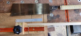

... then cut a load of slots with a dozuki to simplify waste removal:
(32.43 KiB)

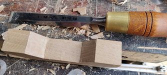

A 10 mm chisel got rid of most of the waste:
(38.7 KiB)
and then a 16 mm one tidied it up.
(34.46 KiB)

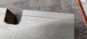

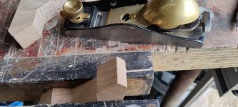

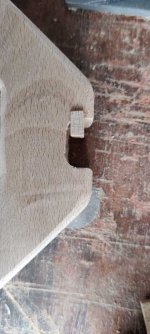

Unfortunately, when chiselling out the waste on the second foot, I somehow managed to chip out one of the corners, so I ended up squaring off both pieces and doing the whole exercise again.
(63.83 KiB)

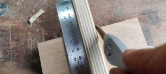

That left the slot too deep, so I used a marking gauge to mark out how much to remove to get it back to where I wanted it to be:
(29.83 KiB)
I sawed the bulk of that off and then planed it down to the lines.

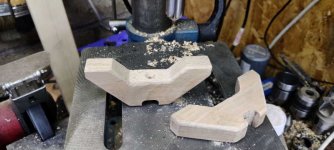

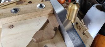

Next up is to add some shape to the feet. I played around with a couple of designs, but I'm still not sure what I'm going to go for. I'm probably leaning towards the second of these (with straight edges rather than curves), but another option would be to draw something a bit more complicated in shape, 3D print a template and then use the router to copy it onto the parts, much like I did with the body.
(39.27 KiB)

Postby Dr.Al » 18 Jun 2022, 17:37

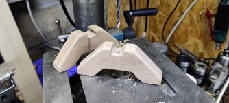

After consulting with the aesthetics department, it was decided that the more angular shape was the best option, so I roughly dozukied / coping sawed the shape out of one of the legs:
(47.45 KiB)
The bottom undercut was roughly chiselled out with a 12 mm chisel and then cleaned up with an 18 mm one:
(44.44 KiB)
The angles on the top were cleaned up on the shooting board:
(29.24 KiB)
After preparing one piece, I used it as a template to mark up the second one and then did the same thing again:
(39.32 KiB)
The end-grain corners were rounded over a bit with a block plane:
(39.95 KiB)

I'd like the loom to be dismantle-able for easy storage / transport (and gift wrapping!), so I thought it best to attach the legs with screws rather than glue. Therefore, I took the legs to the pillar drill and drilled through with a 4 mm drill bit from above...
(33.34 KiB)
... and then with a countersinking bit from below:
(35.27 KiB)

The last major job (unless I've forgotten anything!) is to make a nut to go on the end of the coach bolt. Carolyn's inkle loom just used a wing nut, but I think I can make something a bit nicer than that.

I decided it would be a good idea to deal with that chip in one of the feet. Even if it doesn't look perfect, it'll hopefully be a lot less noticeable.
I chiselled out a slot using my 4 mm chisel to get rid of the chipped bit and make the hole a bit squarer. I then found an offcut and cut it to about the right size:
(25.05 KiB)
That got glued in...
(36.21 KiB)
... and when the glue was dry I could trim it flush and sand:
(28.18 KiB)
I then got a scrappy bit of hardboard and superglued a load of screws to it:
(104.04 KiB)
That made it easy to lay everything out for application of Mike's Magic Mix:
(53.29 KiB)
I've done the first coat now (but didn't take any photos). I'll do a few more over the next few days and get some photos when it's assembled.

The other outstanding job was the nut for the tensioning peg. I chucked a bit of brass in the lathe:
(40.07 KiB)
Roughed it out extremely vaguely (I didn't really have a design in mind and was making it up as I went along) and knurled the outside diameter:
(32.26 KiB)
I then finessed the shape with a radiused tool:
(43.49 KiB)
I then shortened the end a bit, drilled and tapped M8 and then added a 9 mm counterbore:
(34.45 KiB)
After parting that off, I put an offcut of steel (probably EN1A) into the chuck and turned a simple mandrel. The diameter of the plain shaft bit is a close fit in the counterbore, so this keeps the nut reasonably concentric when the part is mounted on the mandrel.
(38.18 KiB)
I then fitted the nut and used my home-made ball-turning tool thing to round the end of the nut off:
(42.16 KiB)
While I was in metal-mode, I used a wire brush to get rid of the rust on the coach bolt and gave the cleaned up surface a light oiling to keep it from rusting again. I usually de-rust with citric acid, but that would have got rid of the plating on the rest of the screw. The wire brush made pretty easy work of it anyway, so I'm happy with that.
All done ready for assembly when the oil has had an overnight rest:
(40.04 KiB)
