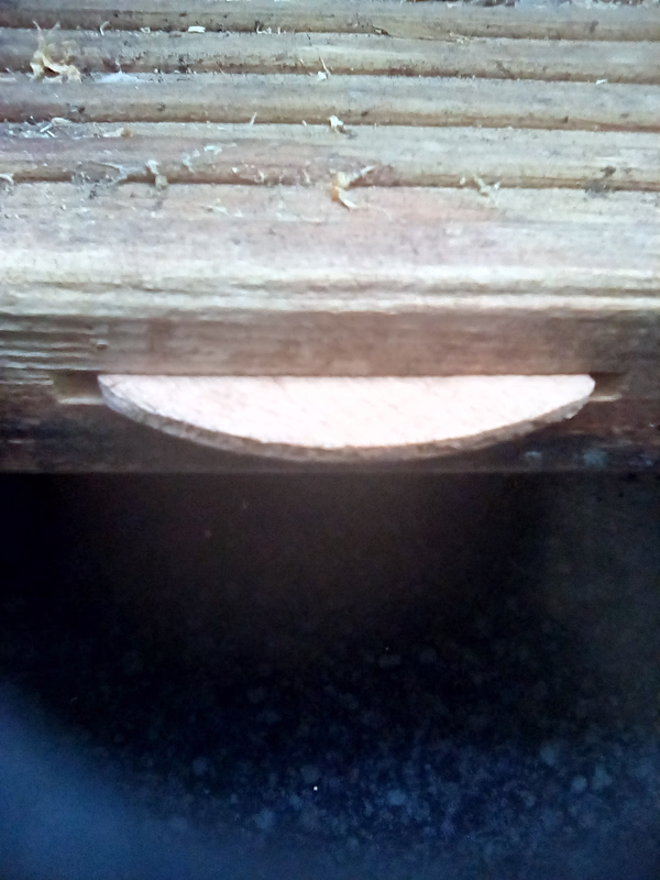

IMG-20260810-124457-5.avif
No 20 on the dial and no 20 biscuit in the slot- who'd have guessed that.

Just to say as it looks like your test piece is on a piece of decking, compressed beech biscuits aren’t suitable for exterior joinery, apologies if you already knew.
