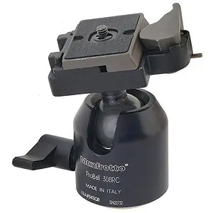

I am the sort of twerp who buys a lightweight carbon fibre tripod, discards the pan+tilt head and then sticks a really solid and chunky ball and socket head on top of it. Pan+tilt = video, but too frustrating and slow for stills stuff, especially panoramas.
The preferred head is an ancient Manfrotto 308RC with a quick-release plate, and I've had it for around 35 years or so. It stays put rock solidly when you ask it to. Sadly, like me these days, it's also prone to not unsticking occasionally, so I have to lubricate it from time to time. Even after all this time, I can't settle on what to use.

I have had similar issues. Too much lube and it will not lock properly. I have had success with the tiniest amount of vaseline petroleum jelly applied in minuscule quantity. Also quite good on the rack and pinion system.
I have a ReallyRightStuff BH-55 ball head and the owner's manual is very clear about not using any lubrication on the ball. Any part of the ball head that requires lubrication has already been permanently lubricated. Using any lubrication will decrease the lockup capability.

They're really nice but I'm wedded to the Manfrotto plates, in part because I have a specialist pano head I've adapted to work with them, and I'm not keen on the Arca-Swiss style. The Manfrotto ones have a nice interlock, so you can't easily drop the camera too. Also I already have a good, if quirky, carbon-fibre tripod. And several heavier duty ones too.
I think that's how mine was initially, but the coating seems to have worn, although it's still functional otherwise. It's a very sturdy ball head, which is why I bought it in the first place, and I haven't seen anything as good since. The BH-55 is excellent, but would be too heavy,
This is the model I have. It's a 3/8" thread into the QR plate, but the plate isn't removable from this ball head (there's no sign of a press having been used - I think it was Loctite). I have lots of both camera plates and QR fittings for things like copy work, and camera plates live on my 300 f/4 and pano head for quick setup.
Needless to say when locked it's rigid, and any give in the system is elsewhere. The shaft above the ball is about 10mm diameter. Genuine Manfrotto camera plates fit the QR plate best, but the Chinese knockoffs serve and don't fall off or come loose. I have quite a few of the QR knock-offs as they can be fitted to other supports (e.g. the camera position on my pano head), and whilst they're not perfect they do work.

I have been frustrated by the QR plate being "permanently" attached to the column and ball, but... it's just occurred to me that a bit of well-aimed heat might cook the thread lock so I can separate them. I am pretty sure I can remove the safety interlock and cam first, so they’re not harmed.
That would mean I can strip the whole thing and clean it thoroughly, which would be a better starting point. At that point PTFE spray and talc can be experimented with...

It's had as good a clean as I can manage for now, and I shall have another go at unscrewing the QR plate when we get back. I also found a perfectly sized zip lock bag to cover the ball in a suitcase, so it won't make a mess (it sticks out of the tripod bag - why do they never make them three inches longer than the tripods?).

I had a problem with a Benbo ball and socket not releasing, it turned out to be a circular collar inside the head wasn’t circular it gets pushed sideways to lock the head. I managed to get it sorted by squeezing it in the vice and now it’s fine.
