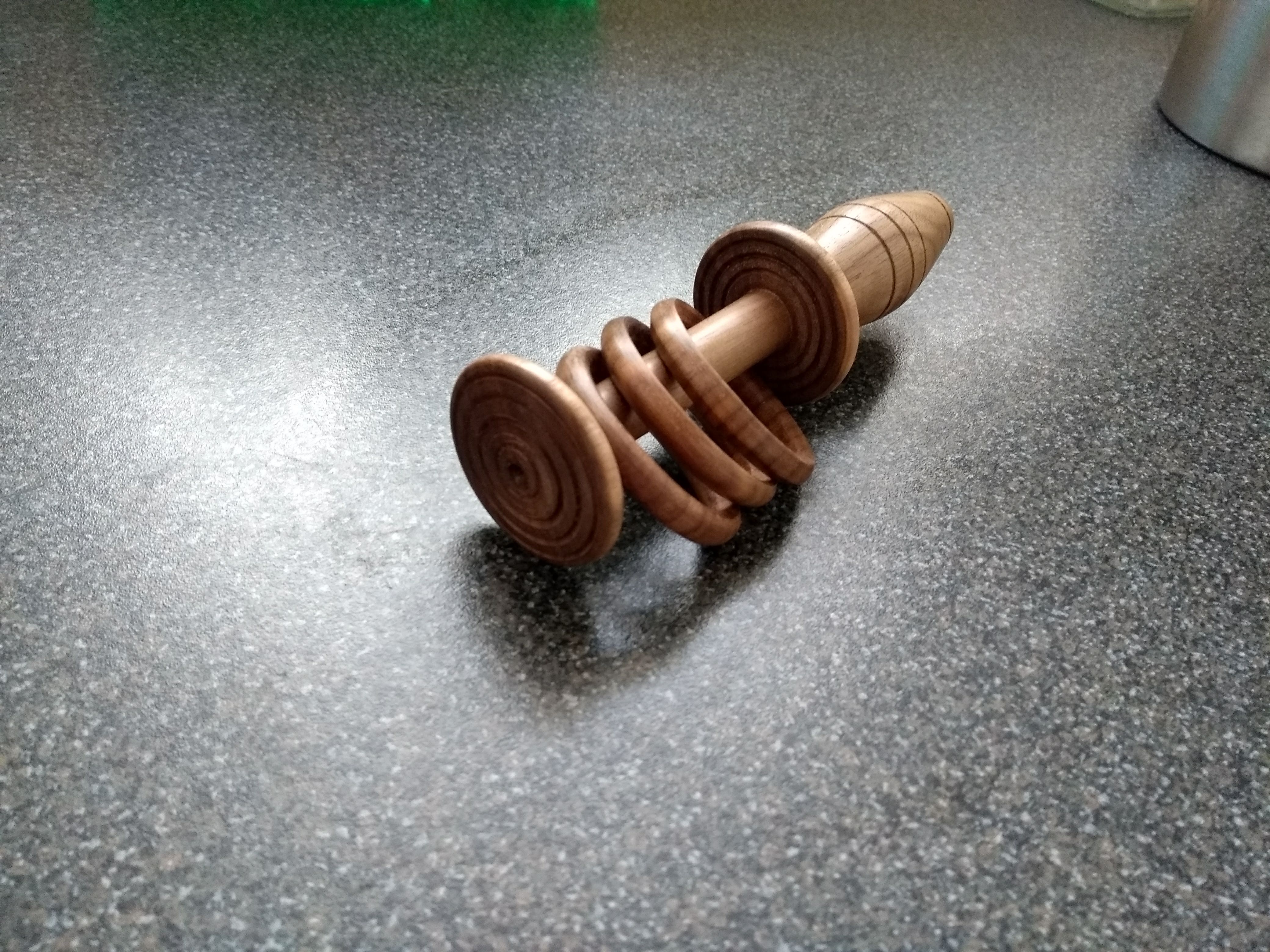

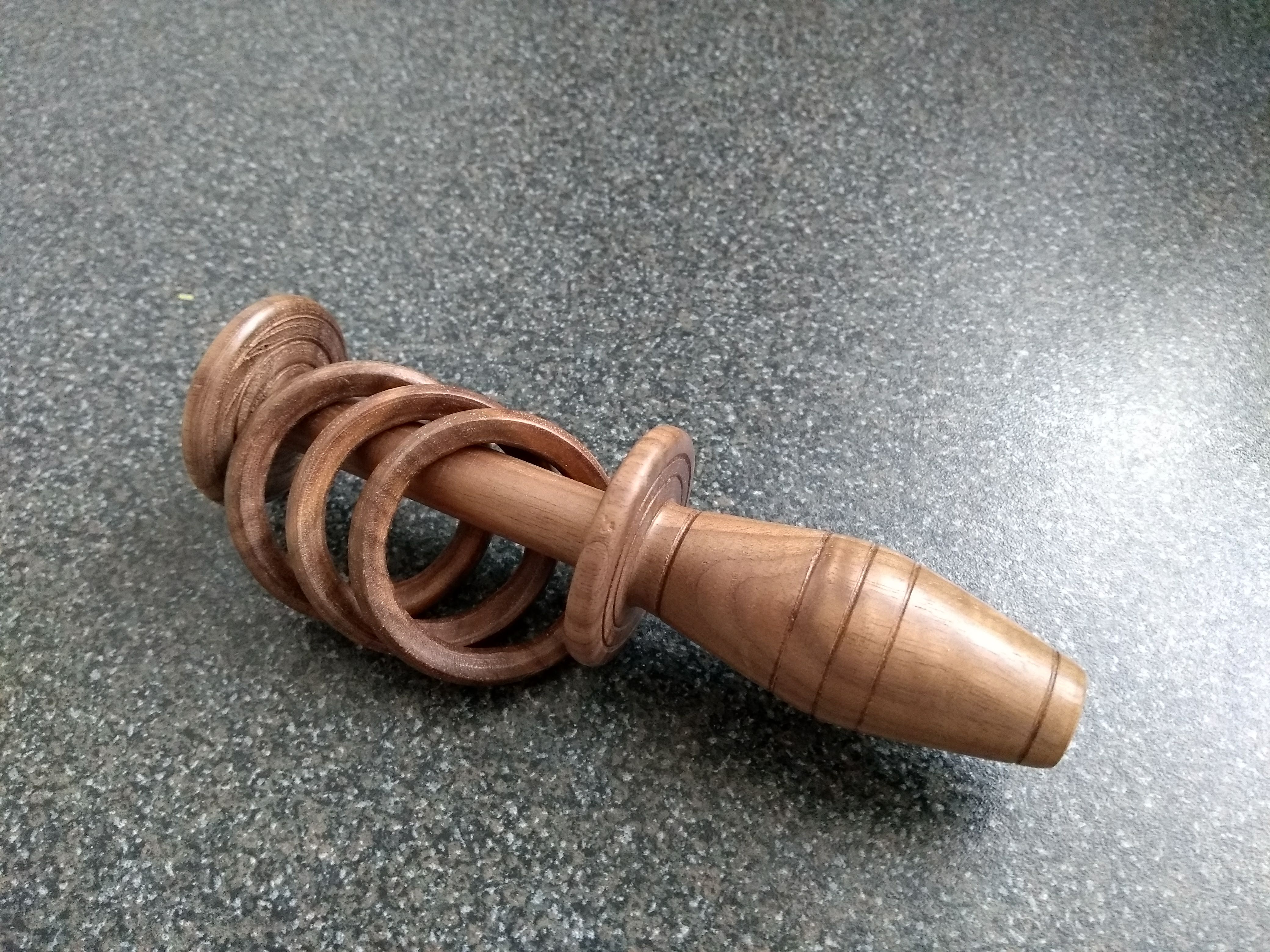

I made this for my granddaughter - it's a traditional style baby's rattle with three captive rings made from a piece of walnut. It's finished with (safe for toys) Liberon Black Bison paste wax :

Nice job; never tried to do a 'captive ring'...tricksy or what, special tool/techinque? How about an 'old skool' football rattle for a proper ear bending? :lol: - Rob
Thanks! My "special" captive ring tool is a length of 6mm HSS round bar in a home-made handle with the end bent at right angles and sharpened like a mini skew, which is used to part the rings once they are shaped. One of the guys at our club gave a demo a while ago and I was able to check out the tool he'd made. The rest is just spindle work with a small spindle gouge. Like everything, it just takes practice.
