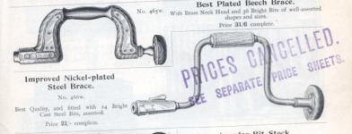

The topic of braces is a huge specialist area that I don't know in detail, but I can say for sure that you have a "plated brace" in beech, which would have been a step above a common brace without the extra bits of brass screwed on, but one down from a "framed brace" where a brass outer layer surrounds a wooden infill. From a quick and unscientific glance at some old catalogues, they were still listed by the big London dealer Melhuish in their 1899 catalogue (24 shillings, with a set of bits). In the 1921 catalogue the price had gone up to 31s 6d in the illustrated book, but an accompanying price list says it's been cancelled.
Salaman, in his Dictionary of Woodworking Tools, gives a date range for the plated brace of 1800-1910.
So it's probably Victorian, but could be early 20th century. British makers seem to have been happy to keep older designs available long after newer alternatives (eg metal ratchet braces) had been introduced.

Very interesting piece of photographic evidence in this catalogue picture which I have never seen before or even knew existed.
That is the uniting of the old style lever chuck onto the modern style bent frame body of the brace.
Thanks to the distinctive trademark we might assume it to be manufactured by
Colquhoun & Cadman​
That's now another brace related item on my wanted list 🫣 :cool:
Cheers Andy
Andy, I didn't realise that style of brace was rare - I've had this one for years!
No extra maker info that I can see, just the name MELHUISH and STEEL 8IN
