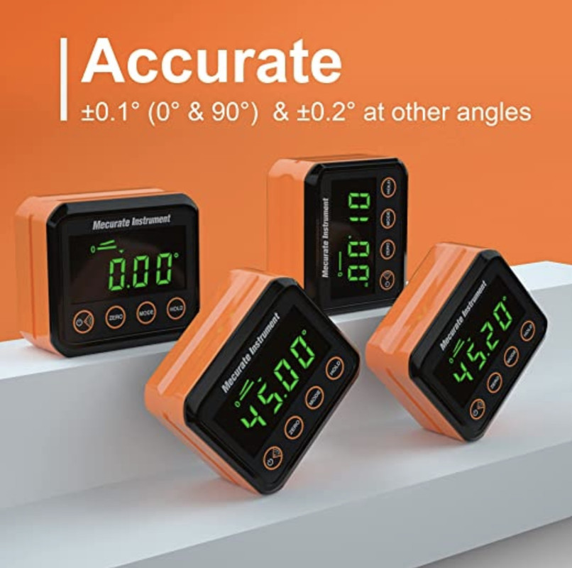

I had a quick google and a trend one for around £20 seems to be very common from many retailers
£11.99 on Amazon.

The board would need to be exactly the same thickness and density all over. You’d also need to check the centre of gravity of the device and ensure it’s exactly on the centre of the board. All rather pointless though as these things don’t seem to be better than 0.1 - 0.2° accurate anyway.

Are you recommending this ?
No, just happened to see it.
I’ve got several devices but they all seem to have their limitations. :lol:
