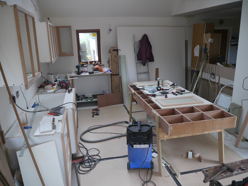

Never having made face frames before I decided that for accuracy I’d use a building board just as I did for the windows and bifold doors. I suspect that is not the way the pros do it, but it works for me. When the MFC was delivered there was a damaged freebie at the base of the pallet which I took off their hands, and although too badly marked to use in the units, it’s ideal for using as a building board, and the melamine surface is easy to mark out in pencil, clean off afterwards, as well as resisting the glue. Here’s a frame for 2 double wall units going together. All joints are dominoed.
I’ve got the base units in along one wall, and the face frames are ready to fit. Dominoes again I think.

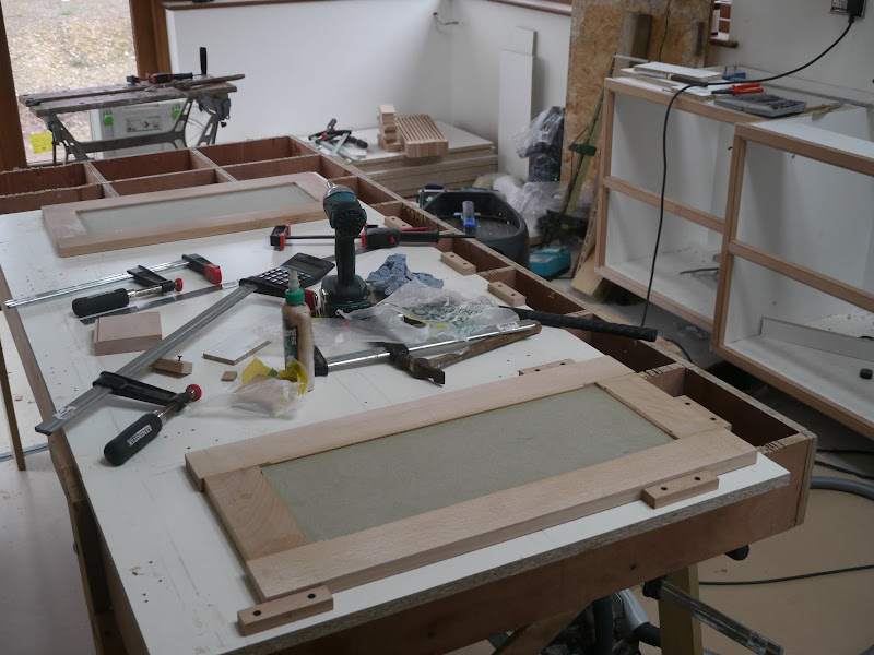

I'm making the doors on the same jig as I used for the frames - that way any minor errors in getting them square will be duplicated in the doors so they should fit nicely. This is where I find that care taken in making the frames accurately has helped no end as I find that the door of the first cabinet along the wall I'm working on fits every opening so I can now run off 6 identical doors on the same jig. If only it was always this easy!

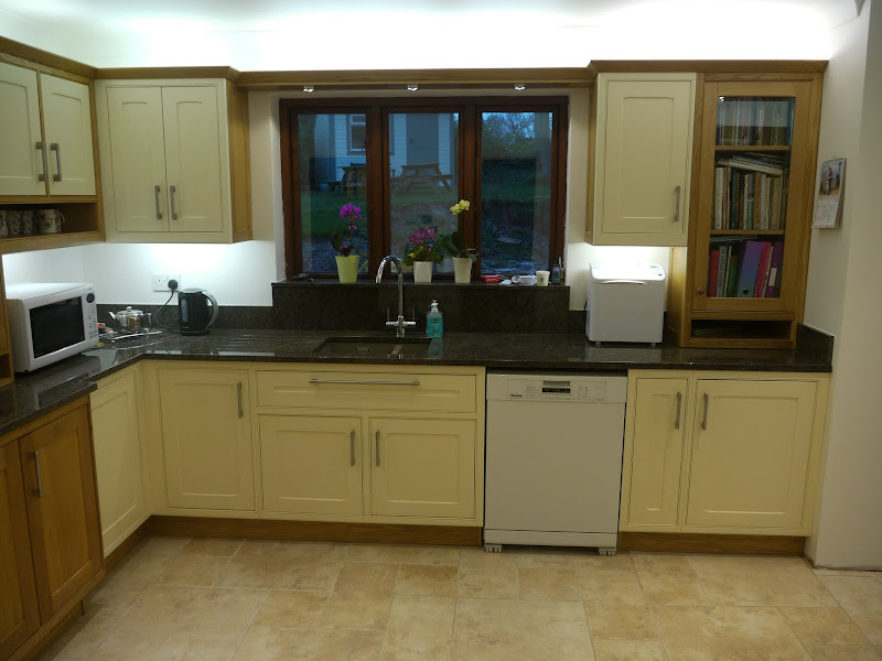

and this is the new kitchen extension.
We focused on getting the unit internals the way we wanted, and then built units to suit. No more hunting around on hands and knees! The hob is a Siemens 5 ring induction. Absolutely brilliant.

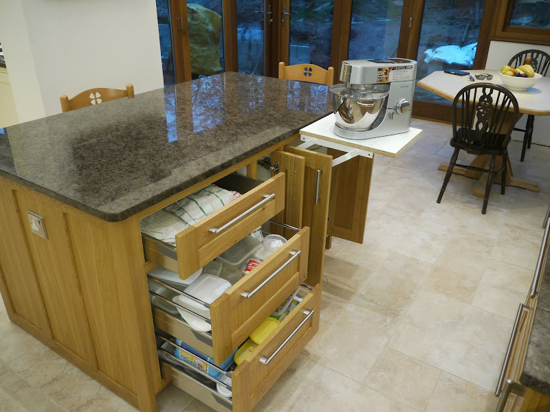

Finally, the finished island.
Fitted with Tandembox drawers and a mixer lift. I still need to replace the temporary MFC mixer shelf with a nice oak one. The mixer is plugged into a socket inside the island so can be used without being moved off the shelf.

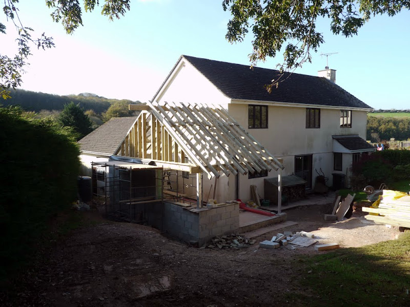

Mike G":skisopxg said:
What is the construction of the extension? It looks as though it may be steel-framed. If so, why?
Mike - it's a standard cavity block construction with a 60mm celotex cavity liner up to the top of the windows. The roof is supported on a flitch beam above the opening for the 2 sets of bifolds and the windows. From memory, this was a 150mm x 10mm steel plate sandwiched between 2 pieces of 150mm x 50mm timber, and supported by a 100mm x 100mm steel post in each corner. The gable is timber framed, with a 100mm celotex infil. then internally the whole lot is lined with 35mm Thermal Check K plasterboard, which has a closed cell foam backing which adds further insulation and also stops there being a thermal bridge through the timber frame. The floor screed has 100mm of celotex underneath it in which the underfloor heating is embedded.
