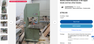

There's an honest build of machine in Somerset at the minute for 750.
They don't make'em like they used to.
Screenshot-2024-4-11 Multico B600 Bandsaw C W ripper blade and two other blades eBay(2).pngScreenshot-2024-4-11 s-l960 jpg (JPEG Image, 960 × 720 pixels) - Scaled (88%).png
Wheels not quite as nice as some particular Centauro's, the CO machines 80's sometime to 1995,
(Strictly the first ones which came with telescopic guards, those featuring complete adjustability, and not the CO badged NL before it)
but it's got a mitre slot.
I would hope the motor to be 3HP?, and not smaller.
I think there might be a 2HP one of these, w/motor damaged, started at 200 a few times without being sold, could pop up again.
So I guess it might be under powered a wee bit, plenty of these and other similar sized saws with such a motor size though.
Would run grand on a VFD.
