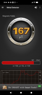

I discovered the other day that phones have a magnetic field sensor that means that metal detector apps are a thing.
This is my phone telling me that my Swiss champ army knife is definitely metal.
No idea how sensitive it is and it only seems to work on ferrous metals but I thought it's pretty cool. Not a replacement for a dedicated metal detector though.
Oh this one entices me - as far as I know metals do not possess a macroscopic magnetic field themselves - they magnetize if a field is nearby, so I'm not sure how they make it work with a pure magnetic field sensor... Maybe they can generate a field too - after all what you need is a coil and some current :-)
I'll look into it, just out of curiosity! Thanks!
I was wondering about that too so looked for more info. Apparently it's measuring changes in the Earth's magnetic field that occur due to the presence of ferrous metals. If I remember my physics correctly, the ferrous metal will provide an easier path for the magnetic field and that has the effect of concentrating it so I think it will be stronger in the vicinity of the metal.
