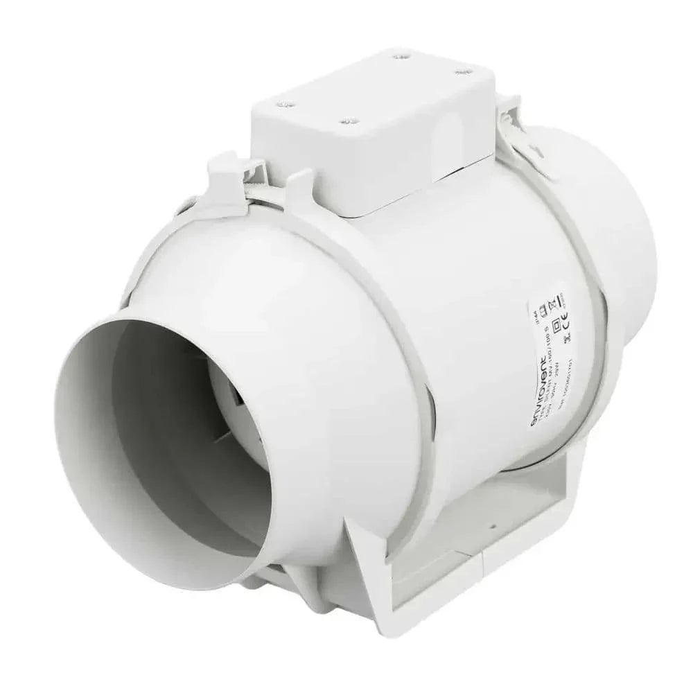

Even a very quiet fan can be noisy if installed badly, a quite option is to use an inline fan in the loft and just duct it. This model is good and compact as well as quiet.

Out of interest I just looked up the vent axia 479086 from Andy’s link on the internet, it can be had for £54 which doesn’t sound bad for a supposedly silent extractor.
That’s a screen shot of the search I did, if you don’t fancy an unknown company Toolstation do it for £62.98
