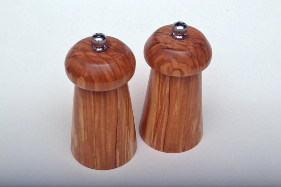

I have a pair.
Making one is easy, making the second identical is tough especially as I wanted the knots in the same place. I will sit and look at them for a couple days before I decide of they are good enough.
