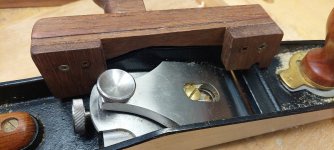

This for @Mike G we were talking acout shooting planes and planing, but everybody shoud have one.
This is my Fin that makes shooting with a Stanler/Record metal plane so much less painfull.
Inside shaped to fit the side and pieces attached to butt up to the frog and front web.
DSC_3116_zps5vcc0xmd by pete maddex, on Flickr
Fitted to the plane.
DSC_3117_zps8umhmql2 by pete maddex, on Flickr
The fin
DSC_3112_zpsxhd9vevx by pete maddex, on Flickr
In action
DSC_3115_zps1jnl1zr5 by pete maddex, on Flickr
Smart replacement handle there as well - zebrano?
You need two handles for right and left hand use with this method of fixing.
I have one of the Quangsheng LA jacks which I use with handles on various shooting boards and a donkey's ear..
My handle is a very simple construction, front and back pieces laminated together with a centre
a shade thinner than the plane frame so that it slides on snugly.
The inner pieces are notched to fit over the internal plane rib and the back of the blade ramp.
I saw this design on Alf's Combi Plane Central site and I think she referenced
Alan Peters as the original inspiration.
I have promised this before but I decided to make a new one over here, and when I get the workshop finished I will complete and show my alternative to a shooting board. So much easier imo.
