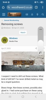

Can’t for the life of me find the thread, does anyone else remember it or the tiny hole saws that were suggested.
Here is the thread:
Lons has nailed it. Plug cutters work really well and you can get long ones. I think I did a thread on this some while ago.
