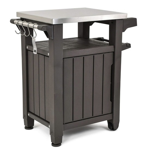

I use a table for our Ooni that has a lower shelf for the gas bottle. It sits under a cover in the garden when it’s not in use. Someone else I know bought a Keter Unity and says it works well. It has two wheels so easily moved and 900mm high like the Ooni table.
