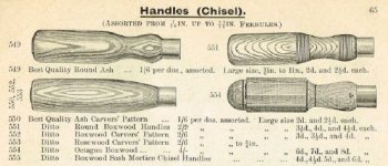

Because I promised, here's a fairly random selection from some old catalogues showing the variety of chisel handles that used to be available.
Charles Nurse, 1902 - "Octagon boxwood"
Richard Melhuish 1905 - "Octagon Box"
Ward & Payne 1911 - "Best London Octagon Box" - also the less-than-best and tapered variants
William Marples, 1928 - "Best London Octagon Boxwood"
In finding these, I couldn't help noticing that my first two examples, which didn't include the word London, were both from London based merchants. The 1909 Edward Preston catalogue (from Birmingham, not shown) did include the London designation.
Maybe it was only in the 'provinces' that the superiority of London had to be pointed out!
