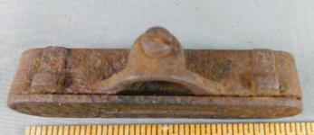

A friend of mine that it turns out has a similar interest in old hand tools as me has acquired a nice old Stanley Line Level.
I think a previous owner has done some sprucing up with some Hammerite that has resulted in the numbering becoming indistinct but some searching led me to this: https://avaluer.net/explore/2674113...ey_line_level__patent_date__june_28_1898___vg
I tried to find a patent for this date for this sort of tool without any luck. A couple of AIs insited that the date is actually 23rd June 1896, not 28th and that the patent is for a way of marking the glass but I'm not convinced. Other images found seem to show that it is the 28th.
Anyway, I was wondering if anyone knows any more about this item. Especially what the bolt was for.
Many thanks.
Edited to say:
Ah ha!, It wasn't a line level! It was clamped onto something such as a metal ruler and you have an instant level.
Here's another picture that shows the clamp better:

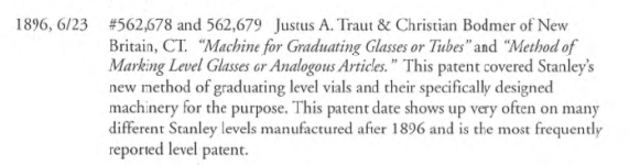

which looks like your one, presumably a number 40. No mention of the patent though. However, there's a separate listing of patents at the end of the book which includes this, with the useful note that the date is on many different levels:
So, it looks like a number 40, 23 June 1896 is what the numbers should read, and the patents referred to are indeed for how the tubes were made, rather than any feature of the finished level. Here it is, in a catalogue from 1900:
