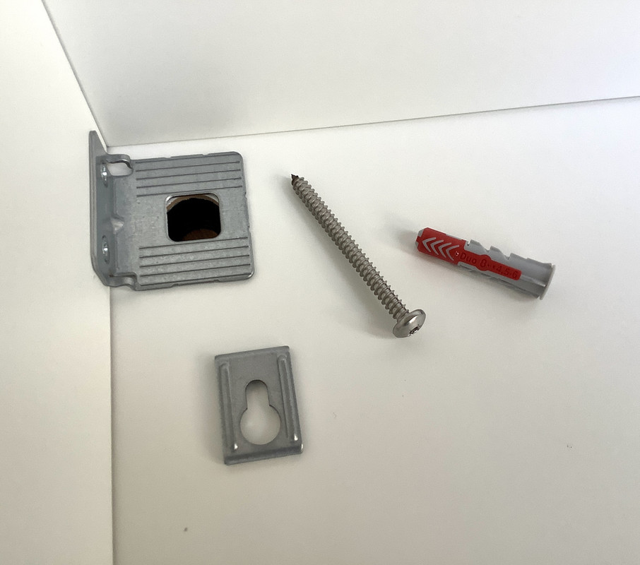

I bought a cheap bathroom cabinet with a fitting that I’ve not seen before. Unusually they didn’t supply mounting screws and you can’t use countersunk screws of which I have thousands. :(
I bought some Torx pan head for the job. Anyone else come across mountings like these?
Inside.

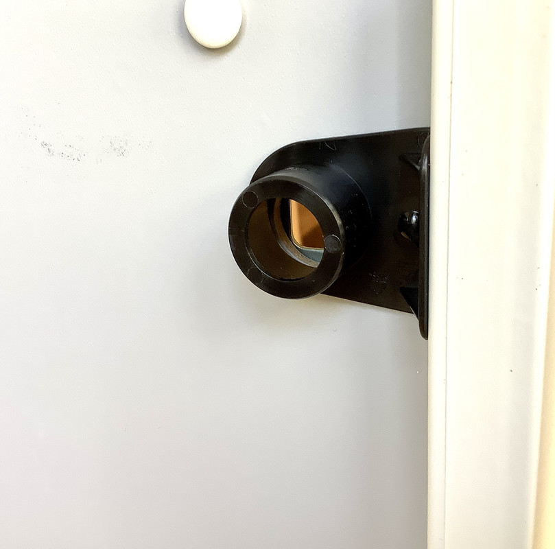

Outside.
It makes the cabinet easy to hang as the screws go in first and are then tightened after the keyhole plates go on. It also allows a little vertical adjustment.
The old cabinet had a pair of sawtooth brackets that were screwed to the wall on which the cabinet hung. This allowed lateral but no vertical adjustment.
We used to have a bathroom cabinet with similar fixings to those. As you say, they make hanging (and minor adjustments) very easy.
Almost identical to the ikea bedroom cabinet fittings, very easy to use though I don’t see why you can’t use countersunk screws, I do.
They don’t supply fixing screws as they don’t know what substrate the unit is going to be fixed to & I imagine it would leave them open to being sued if they supplied a fixing that wasn’t suitable which subsequently failed :eusa-think:

The cabinet is now on the wall. In spite of careful drilling - I always start with a 3mm masonry bit first, the holes still ended up a little off so the height adjustment did come in handy.
Yes, it’s an IKEA cabinet. The instructions clearly say not to use countersunk screws. If you did use them it would distort the keyhole plates.
