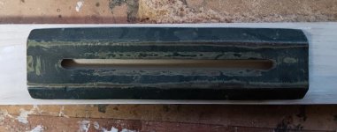

Batch A 2572 - RBs 834 to 905 - 72 machines commissioned 23rd June, 1950:
RB 839, test 41647, of 1952 - New Zealand - Wadkin Ltd. cast tag;
RB 849, test 41831, of 1952 - New Zealand - Wadkin Ltd. cast tag;
RB 858, test 41973, of 1952 - New Zealand - Wadkin Ltd. cast tag;
RB 876, test 42337, of 1952 - New Zealand - Wadkin Ltd. cast tag;
RB 884, test 42634, of 1952 - New Zealand - Wadkin Ltd. cast tag;
RB 886, test 42636, of 1952 - New Zealand - Wadkin Ltd. cast tag;
RB 893, test 42643, of 1952 - New Zealand - Wadkin Ltd. cast tag.
The first thing of note is the introduction of the 3rd type of fence.
This fence is the basic fence off the larger Wadkin RD surface planer (12" & 16"), but without handwheel adjustment. This fence has two gates, as opposed to the single gate on the first and second types of RB fence.
Note that it required a modified infeed table with a larger (and possibly repositioned) landing for the fence mounting.
The same fence was also used on the Wadkin RM planer/thicknesser.
These machines have the following features:
- 3rd type of fence, making its debut;
- 4th type of handwheels - cast aluminium, 3-spokes (same as batch A-2469 and A-2547);
- base casting with opening in boss for pushbuttons (same as batch A-2320, 2372, 2469 and A-2547); and
- base casting with opening for standard (and wider) electric control gear door (same as batch A-2469 and A-2547).
Cheers, Vann.
