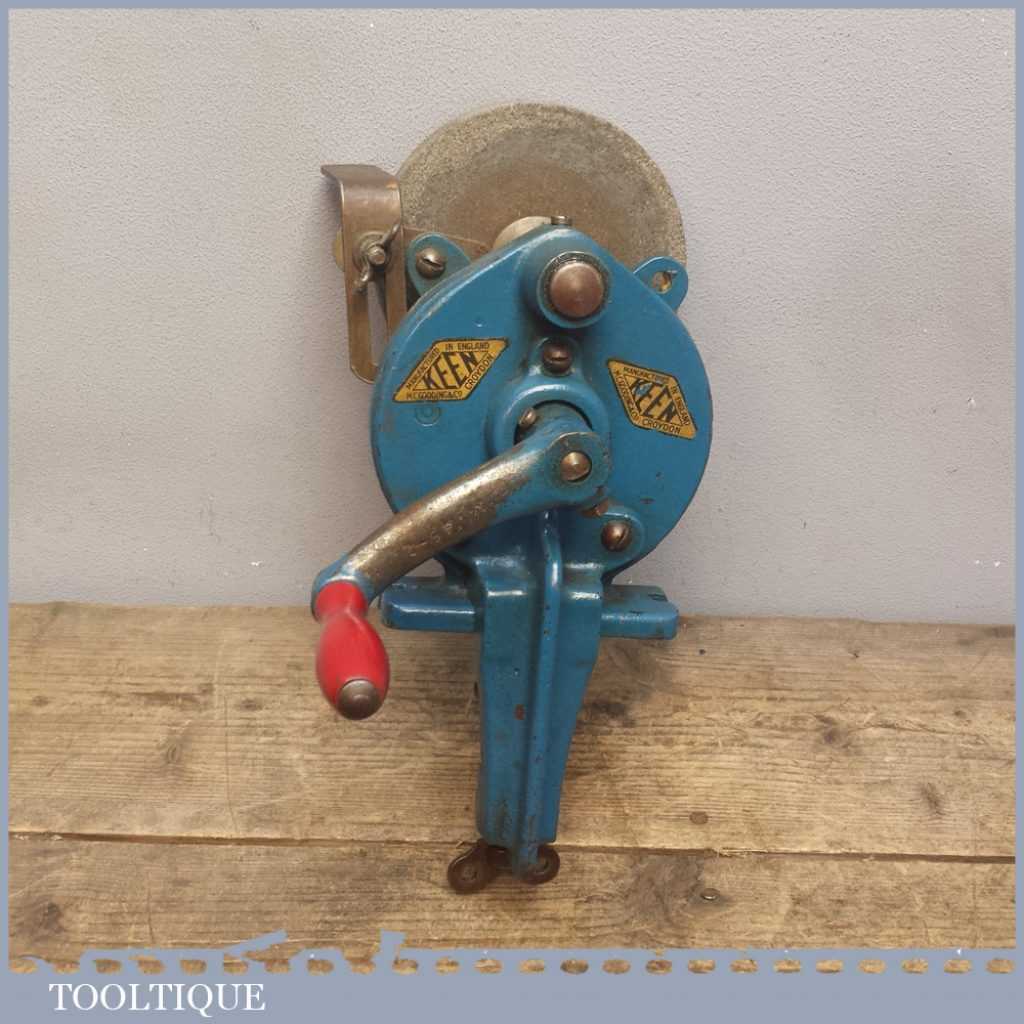

I can't add much at all, and probably nothing you haven't already found.
Grace's Guide gives the basics here https://www.gracesguide.co.uk/M._C._Gooding_and_Co
and this nice image from Tooltique clearly shows that the Keen trademark belonged to Goodings.
(from https://www.tooltique.co.uk/shop/vintag ... c-gooding/)
