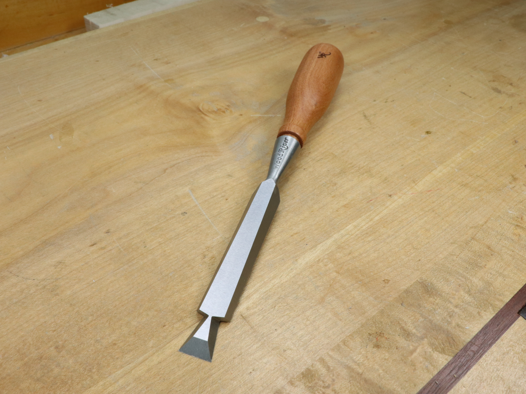

For getting in to corners on dovetails. the Ashley Iles dovetail chisels with the rounded back are fantastic. Grinding the end of an old chisel at at angle is arguably even better.
Thanks. Good point about grinding the ends. I have seen Rob Cosman do that, and I think sells some ground down now. Like this, he calls them “Cosmanized”
Ooh, that's weird - I've never seen anything like that before. That's like a cross between a bevel-edge chisel and a fish-tail one. I've got a fish-tail one (from Bristol Design) but I don't use it that often.
It was this sort of thing I was talking about:
David Charlesworth uses some with the tip ground at 1:6 for cutting half-lap dovetails but any angle is fine really (as long as it's more acute than the corner you're trying to get into). I like having pairs with opposite angles but with a decent size bevel one of them is fine. They're fantastic for getting into awkward corners like the insides of dovetails or the sharp point of the cut-out you can see in that photo.
They're easy to make, just grind a new bevel at a jaunty angle onto an existing chisel. I've got a few as I decided to make some out of some old chisels of various different widths. You can also buy them pre-ground although they're a bit difficult to find as most searches for skewed chisels will find the woodturning tool that is a similar idea.
