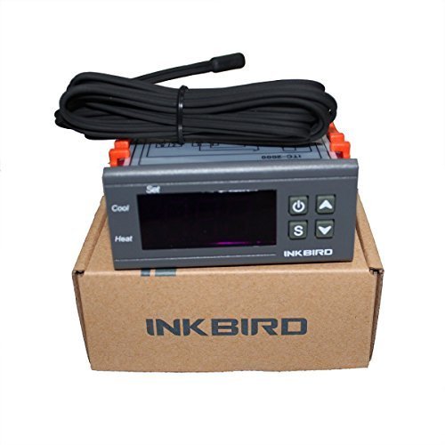

Or you could use one of these -
https://www.amazon.co.uk/Inkbird-Temper ... B018K82UQU
More wiring to do yourself but these are the same but cheaper
https://www.amazon.co.uk/dp/B0185M6I28?psc=1
I have 2 of these controllers of a different brand but identical and they have been completely reliable and remember the settings when left disconnected all summer.
Better than a simple thermostat as you can set the hysteresis to control switching intervals.
not wifi though ;)
