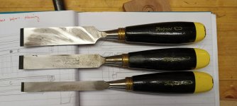

Not much help in answering the original question but if we're onto Footprints I rather like these. Some of the yellow paint has come off the beech wood handles but the sizing and balance are good.
As it happens, I also have the box they were posted to the original owner in. It's postmarked October 1974. I think they were a promotional offer from the Woodworker.
You can see that they were drop forged then finished on a rotary grinder, which would have been more economical than older hand methods, but the Sheffield steel was being made in a predictable, reliable way then.

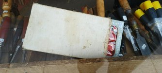

Just continuing the digression into red handled Footprints, I spotted these while window shopping early this morning
They're out there!
