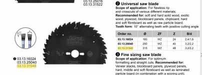

I need another Universal blade (as supplied with the machine). Originally ordered one from Felder UK with the expectation of delivery 5-6 days. Now told it is out of stock. Maybe back in stock in 10 days ..which takes us to the Christmas shutdown etc so realistically it won't be until 2021 before I see it.
So any recommendations for an alternative please ?

I'm wondering though if I will find the right tooth combination...

That blade should be fine, WZ stands for Wechsel Zahn (translates as changing tooth). They are really good allrounders in the saw, also on plywood, for heavy ripping I swap to a blade with less teeth and a heavier back to the tooth support. Faced boards need a different configuration blade of which there are a couple of varieties. I use Leitz, Freud, Stehle; Guhdo (I'm really pleased with these).
I would go for something with more teeth.
Have a look at the Freud with the 96 teeth.
I have a collection of different manufacturers saw blades. Omas. CMT and Freud all very good but have to say the OMAS is the best. They are also stocked by S&S
