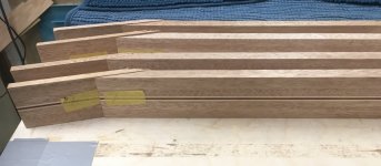

I missed taking photos of gluing the neck blank laminations. Not sure you want to watch glue dry. :)
Anyway, now they're glued and par'd, time to cut the 13 degree angle to create the reverse scarf joint for the headstock.
The headstock blank then gets reduced to 9mm to accommodate 2mm of veneers, so that the string tuning post still has winding room.
Almost time to lower the CNC machine from the rafters. Got to do some work on it; I've upgraded to a new controller, which I'll commission first. Then I'm waiting for a ballscrew upgrade kit.
Time to true up the scarf joint surfaces.
Lay the smaller on top of the larger so the angled faces create a flattish surface.
Gently plane across the grain to achieve the surface level with the squared line.
Finish off with a sanding board,
The bottom one isn't glued, it's just held together with DST for the purpose of this photo. When it comes to gluing/clamping, I shall raise the headstock section a hair above the neck section and sand it back level.
The fretboard will cover the top join, and the headstock back veneer will cover the lower join.
Using the bandsaw 13 degree angle cutting jig to clamp the parts together.
It's easy to end up applying glue to the wrong surfaces. 😕 Happily I realised just in time. Honest!
Using the 13 degree offcut as part of the clamping system.
I could see glue squeeze-out evenly from the two visible surface joins. Hopefully there will be some at the other joins.
I forgot to tell you what the couple of thicknesses of masking tape were for.
They provide that tiny gap to let the headstock section be proud, so that I can sand it back exactly level with the neck section.
And the glue squeezed out just right.

The headstock is 9 mm, but 2mm of veneer will be added. The string post has a shaft of 12mm before the winding area.
The neck is 16mm thick at the heel end and will be 13mm at the headstock end. It will have a 9mm square aluminium reinforcing rod underneath the fretboard.
And the fretboard adds 4mm.
