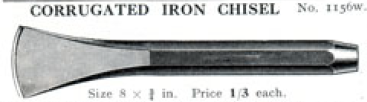

Way back over a century ago in 1924, one Edward Oakley had a bright idea. Corrugated iron sheeting was a popular material for all sorts of roofing requirements, but it was difficult to cut. As far as I can tell, the standard tool was a cold chisel with a long curved edge, like this: (picture from a 1925 Melhuish catalogue)
but it must have taken ages. The portable angle grinder was still decades away in the future, and you couldn't even use a hacksaw, as the thin blade had to be held taut in a frame, and the frame got in the way if you were trying to cut something more than a few inches across.
