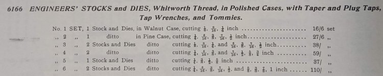

The earliest commercial illustration I have found is this rather crowded one from the Timmins catalogue of 1845
and here's a similar engraving from the 4th edition of the Sheffield List, around 1855:

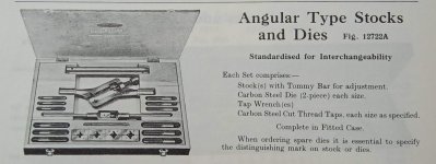

But the design shouldn't be dismissed as just Victorian - it lived on for more than a century - a recognisable version was still listed in Buck and Hickman catalogue in 1964
and even in 1971:
