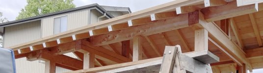

I need some opinions, please. One of the tie beams has a partially rotted pith exposed at one end. I do not know how deeply the rot extends.
This end is tucked under the eave and not directly exposed to rain It is the left most on the picture below. On the original assembly I left it like this. Now I'm thinking I might want to use linseed oil to paint the end grain both to limit water intrusion and for esthetics. I used white linseed oil paint on the more exposed top plates and rafter end grain so doing so on the tie beams and rafters would be a match.
I would not paint the rotted area directly but instead consolidate and fill with epoxy for a smooth surface, then paint. I understand using epoxy is fairly common for timber end repairs. But I have also read that there are concerns that epoxy fillers can cause longer term damage because they are water impermeable and can trap moisture behind the repair and actually accelerate decay around the fix.
So I'm facing a few options. A) do nothing. The wood is now dry and the beam should last longer than I will. If someone sometime in the future wants to repair or replace the beam that is on them. B) Epoxy fill and paint for the esthetic gain, hope that the repair lasts longer than I do. C) perhaps a third option is to construct metal end caps to better protect from driven rain. D) purchase a replacement beam now.
I think if I was in that situation I would be digging as much of the soft (rotted) wood out that I could and then treat with a wood hardener and a fungicide - depends what is available to you over your side of the pond.
As the building is dismantled I'd try to put the beam vertical and pour the fungicide/wood hardener into the hole and allow it to puddle so it soaks into any soft wood that couldn't be removed. Continue to do such until it stops soaking in. Then mix an appropriate epoxy resin filler to fill the hole. It really depends on how deep it goes and how much possible weakness removing the rotten wood may bring to the beam for the weight load it may be put under.
Because the beam is uninstalled, you can easily add mechanical strength if the rot took out a significant portion of the wood.
Epoxy fills the void, but adding metal or timber reinforcement ensures structural integrity.Internal Dowel Reinforcement: Before packing the epoxy putty, drill two or three deep holes into the healthy wood core through the rotted end. Drive fiberglass or stainless steel rebar rods into the holes, leaving them protruding into the cavity. Pack the epoxy around them to create an incredibly strong reinforced core.
Just my thoughts... may be of some help but others with far more experience may come up with a better way to proceed 🤞
