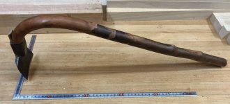

My next diversion is to try my hand at adze finishing, which I understand is called chouna shiage in Japan. Here is a guy in Japan who specializes in this kind of decoration in Japanese chestnut. I have in mind making an octagonal hand rail somewhat as he does.
There are several kinds of chouna with different shapes and uses. I happen to have friend who lent me his clamshell shaped adze to try, which is curved in two dimensions.The bent wood handle with the bark attached is traditional.
My research tells me that this style is used to make multiple small, shallow cuts. After some truly terrible first attempts I think I'm starting to get the hang of it. Here is an attempt on some Port Orford cedar:
And another attempt in western red cedar:
Early days and both sharpening the curved surfaces and learning the best cutting angle, speed, stance, effort, etc are a challenge. I'm not very good yet but I'm having fun so far.
Any tips or suggestions are welcome.

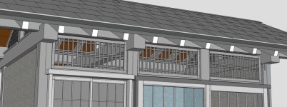

My almost last woodworking subproject for the shed is to make the fixed sash for the three transom spaces above the window and doors.
My original idea was to have a set of lattices like these thinking they would add some extra light and ventilation.
But the more I thought about it the more they looked too busy and the extra light and ventilation was unnecessary given the doors, windows, and gable lattices. I also was not eager to mill and join all of those lattice parts.
One alternative would be to just fill and plaster the openings to match the plaster I intend for the walls. But I had one more wide and long and beautiful clear vertical grain cedar board from the same set of boards I used for the doors that was begging to be seen. So I decide to make solid panels instead of lattices.
