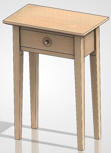

This is what I've come up with as a first stab at a design:
I'd very much welcome comments / suggestions on how it looks. I've modelled the top as solid but it'll probably be a panel glued out of two planks. The top is 24 mm thick but with a substantial chamfer on the underside to make it seem a bit thinner. For a sense of overall scale, the top is 300 × 500 mm and the overall height is about 700 mm. The legs are 40 mm square at the top, tapering down (on the inside faces only) to 26 mm square at the bottom.
I haven't decided what wood to make it from but I'm probably leaning towards Sycamore, Sweet Chestnut or Oak. Oak would match the bed, but I don't see that as an essential requirement. There's an American Black Walnut shelf thing that currently sits on the panniers and I expect I'll move it onto the new table, so there will definitely be a mixture of wood species regardless of what I choose to make it from.

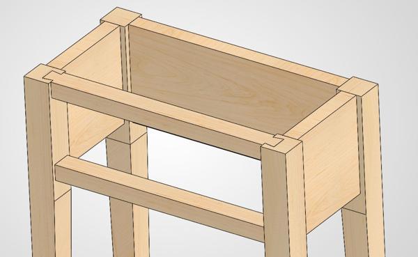

If I hide the drawer and the top surface from the model then the structure becomes a bit clearer I think (note that I haven't modelled the planks that the drawer will run on yet:

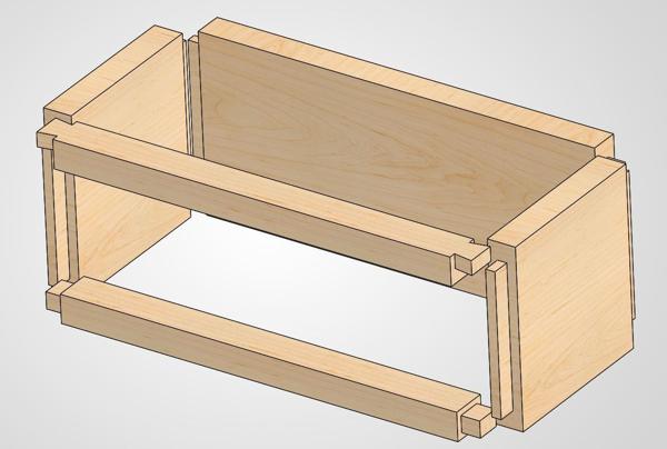

With the legs hidden, all the planned joinery is visible:
Mortice and tenons for almost everything and a dovetail lap joint for the top rail at the front, much the same as Matt Estlea did in his video series if I'm remembering rightly (it was quite a long time ago that I watched it). I might change the panel tenons into haunched ones, if only because I've never tried cutting one.
Again, any suggestions for design changes would be very welcome. It'll be a while before I start work on it (I need to buy the wood first and I've got some busy weekends coming up) so there's plenty of time for design changes.

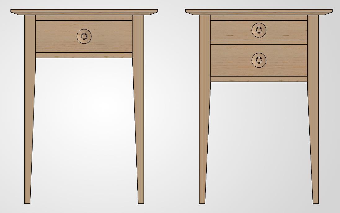

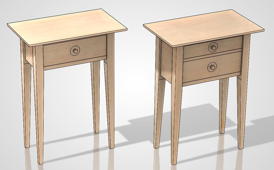

The best bedside table I’ve used had the top, the drawer, and a shelf. A shelf is good for storing tissues which is helpful for allergy sufferers like me. You don’t want to display the tissues on the top, or make them hard to get to in a drawer, so an open shelf in addition is very welcome. Can also be good for drinks.
Top for book, phone, lamp
Drawer for spectacles, pills
Shelf for tissues, drinks

Your design looks good to me. You could perhaps make the legs a little more delicate?

They look really elegant, thanks Gary. I'd already designed in a bit of a bevel:
Do you think it needs more? For that matter, do you think it would be better to narrow the base a bit (i.e. have more overhang at the top)?

I would like to make them more if the collective wisdom of this forum thinks I can get away with it. At the moment they're 40 mm square at the top, tapering down to 26 mm square. I can't see any reason why I can't make the taper steeper and hence get down closer to Andy's 19 mm square at the bottom. Do you think the top end needs thinning too?
I couldn’t manage without three drawers :eek:
The chest of drawers that used to be there had three drawers. One of them had a box of tissues in it, which has moved onto my new bedside "table". The other two are still full of the clutter that was in them when it was the bedside table and I don't think I've gone into the spare room to open any of the drawers in the last two years.

I think there is a balance to be struck with the taper on this table. On fine furniture it is nice to see a taper down to 19mm, but I always think it looks very delicate. Whereas 25-30mm at the bottom looks much stronger and practical. At the top of the leg I would keep to 40-44mm square as there is a lot of joinery going on. Personally for a bedside table I think your sizing is spot on.

For determining the amount of overhang, I usually start with an overhang equal to the width of the leg. That usually looks good and you are close to that with your sketch now. For thickness, half the width of the leg is also a good place to start. 40 mm leg = 20 mm thick top. Note "place to start." You may decide to end up somewhere else.

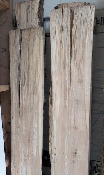

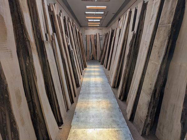

This morning I had a trip over to my favourite timber yard:
They had loads of stock of Oak, Sweet Chestnut & Sycamore plus a few bits of Yew, Ash, Sequoia and these lovely looking bits of Spalted Beech (which I didn't buy, despite being tempted):
After browsing the stocks for quite a while, I ended up coming home with a healthy stash of Sycamore in a few different thicknesses. I bought way more than I need for the bedside table (I could probably make four of them!) but I figured it would all get used on something eventually. I really enjoyed working with Sycamore when I made the Mini-Moravian bench and was really happy with what that looked like once finished so hopefully this Sycamore will live up the same standards.
It seemed to pass the first inspection from our little 21-year-old:
I see a lot of hand planing in my future...

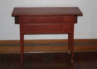

Very nice table @AndyT and as I remember it! @Dr.Al requested suggestions as to design ideas, but what I do is to scan Pinterest for inspiration, bearing in mind that there's nothing new in woodwork design that hasn't be thought about decades or even centuries ago. F'example, this is the Pinterest board I created when I was researching the 'Overflow Bookcase' project, so by picking around ideas I was able to come up with something that was acceptable to me and more importantly, SWIMBO. On that board you ought to be able to see the Japanese themed design that I adapted - Rob....who's taking a break from garden landscaping!
Looking back at my table, I see that I was closely following a design in Thomas Moser's book "How to Build Shaker Furniture". It's also featured in a magazine article by Christopher Schwarz available here: https://www.popularwoodworking.com/wp-c ... 4-Seg2.pdf which Custard pointed me to. The article has full dimensions and some good advice on stock selection.
The legs actually go down thinner than I remembered - to 5/8" which is about 16mm. The top is 19mm thick, bevelled down to 12mm. I made mine rectangular not square and I did a "proper" drawer with a cedar bottom set into slips and sides made from quarter sawn oak.
