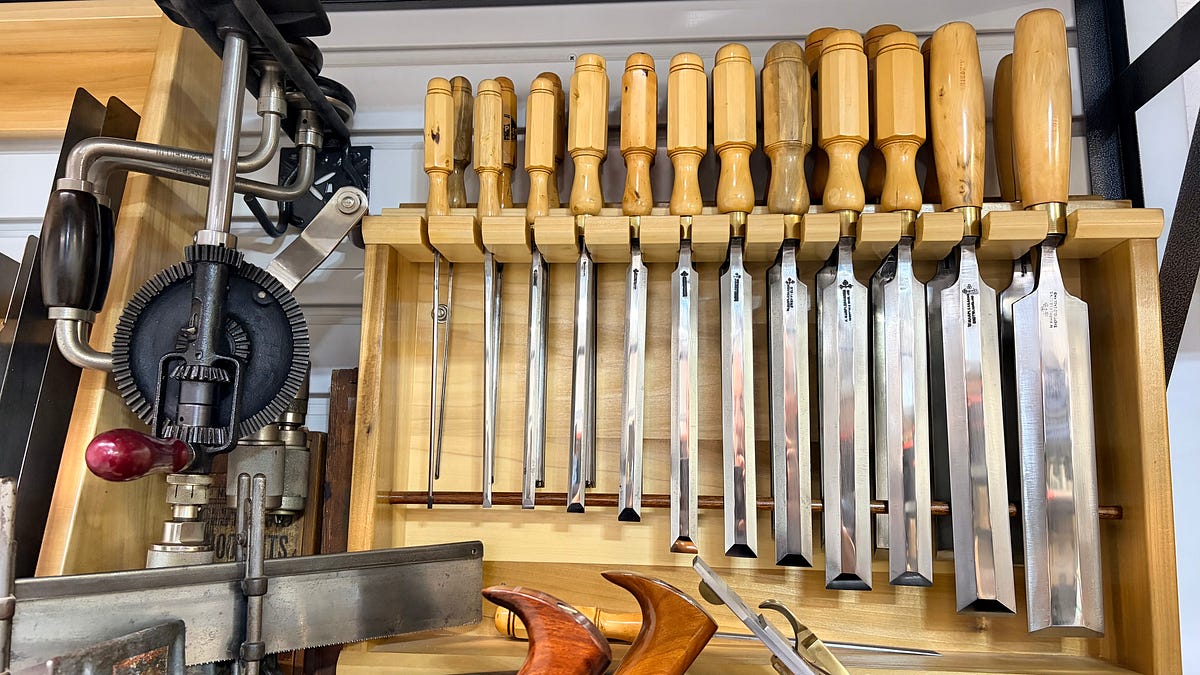

I did use some rust treatment (Evapo Rust) on some old hand chisels but, as you'll see in a photo, left a dull grey cover on the metals of the chisels. I'd like to avoid this with these planes - if possible. Apart from dismantling as the starting point what would be the next steps and treatment/s to use... white vinegar for one? Or use the Evapo Rust and clean of with ????
Quick hint - if you get to the grey stage with Evaporust, give the steel a rub over with a toothbrush, wire brush, green scourer from the kitchen etc, while still wet. The loose grey will all come off. You can stop as soon as the surface is sound, there's no need to go back to bare shiny steel.
I'll post more and find some pictures when I get home.
That's great advice from Andy. Evaporust or citric acid or white vinegar all work, they'll turn the rust into grey-black gunk that comes off quite easily with some rubbing. As soon as you've cleaned it off, dry it and then give it a wipe with some light oil (3-in-1 for example) or it'll start rusting again alarmingly quickly.
I used the EvapoRust on some other bits as well as the chisels and saw how the rust fell away... Just wasn't over happy with the changes in colour. I was expecting far more rust and deterioration on these planes than there is... wasn't looking forward to getting them out of the drawer - in a damp'ish area. Having seen some white mould growing on the inside of one of the sides I'm going to aldo have to make new drawers. Mind, they've been there overb38 years...
