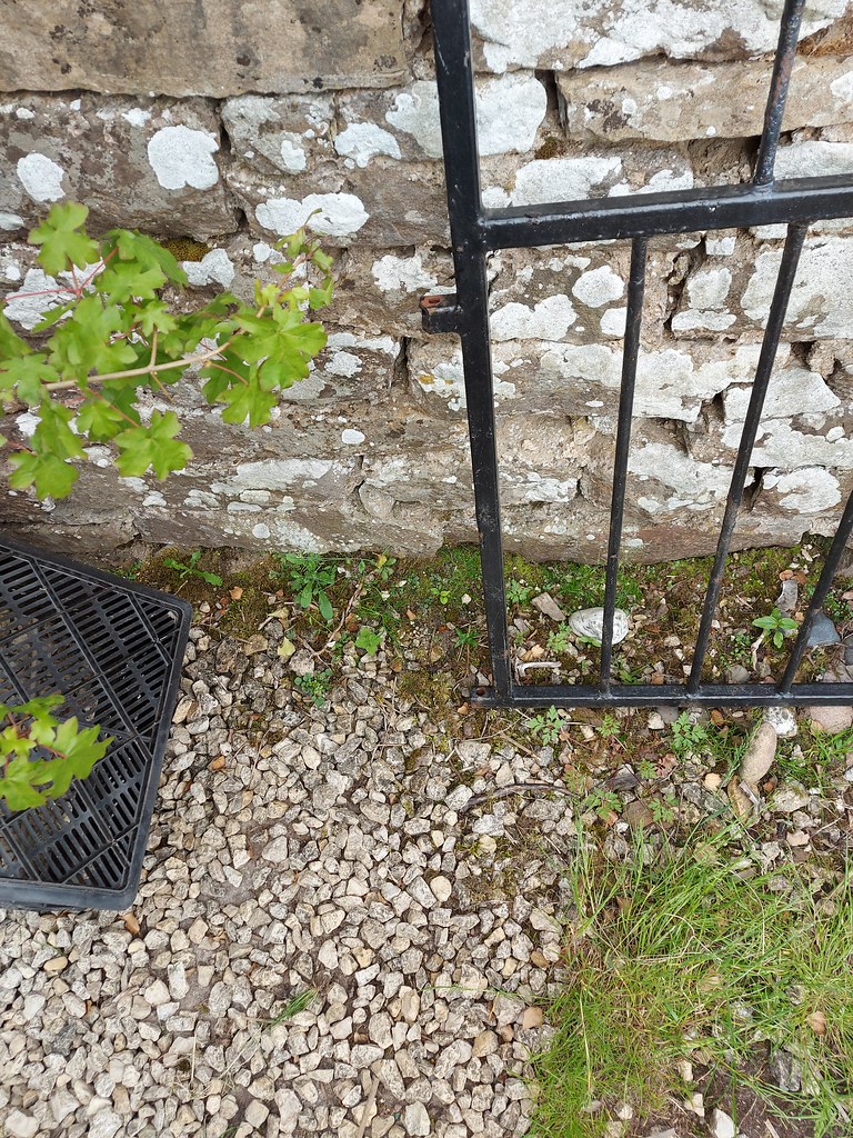

I digress. I'd like to commission someone to make a couple of metal supports for the hinge points if possible. I have no idea of the best way to do this. They could simply be a spigot welded onto some square section. Or round. The only sensible thought I've had is for it to end up welded to some screwed thread that I can then epoxy into the stone wall.
I reckons i has the stock in the pile for that Roger. Please measure the hole and let me know the offset you want. A think a plate and pin would be the easiest and let you fit it to whatever you want. If you want a pin instead i can do that easy enough and leave enough that you could just drill through the post and bolt the other side.
Thanks Dave.
Offset...now you're asking...what do you mean by that...even though I got metalworking 'O' level that was a long, long time ago !
The 'pivot' (for want of a better word) will be going into stone hence my suggestion re threaded rod at that pint to give a key to the epoxy. But open to suggestions, thanks.
Ok, gap between post and gate instead of fancy words like offset. :lol: how much pin do you want sticking out the wall?

I think the most important question, Roger, is what this attaches to. If it's a wonky old dry stone wall then you'll have a different solution compared with a neat brick wall or a wooden fence. If this is light duty and you don't need built-in adjustment, then a back plate with a couple of screw holes for screwing-and-plugging is a decent solution. A wonky old wall will mean you need adjustment, and so a shaft epoxied into a hole for each hinge will give you a chance of getting the gate in the right place. So, a bit more info, or a photo or two....
Mike G":3rl8hvun said:
.....A wonky old wall will mean you need adjustment, and so a shaft epoxied into a hole for each hinge will give you a chance of getting the gate in the right place. So, a bit more info, or a photo or two....
You've got it in one, Mike.
RogerS":3utoawab said:
I will need measurements for both pins then Roger.
Thanks, Dave.
Pin diameter can be 8-10mm. Length 40mm. No need for any sort of securing mechanism to stop the gate being lifted off.
Offset - 1 off 100mm plus length of the threaded portion.
1 off 80mm plus length of the threaded portion.
I hope that's OK ?
I shall get you a drawing this evening (I haven't got a fag packet in work) and then get started.

Somefink like this? Simply utilitarian and robust.
Absolutely spot on, Dave :eusa-clap: :obscene-drinkingcheers:

Thanks Dave. The length of the screwed thread part? Probably 75mm? Is that OK ?
RogerS":z4j5klrr said:
Cool. I'll get them sorted over the weekend.
Yep, though it won't be a perfect thread for the last 25mm as I'm cheating a bit and using a coach bolt, save me having to cut threads and better steel than threaded rod. I'll leave them a tad long so you can make of it what you wish. Or I can flip it round and have 50mm off thread on the end with a clear shank on the middle.
Oh clever...I like that :eusa-clap:
Clear shank in the middle please.
Pm me your address and I'll check postage on monday.
Oh those are perfect thanks, Dave :obscene-drinkingcheers: :obscene-drinkingbuddies:
Will do.
Huge thanks and kudos to Dave (Novocaine) :eusa-clap: :obscene-drinkingcheers:
