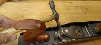

Here's a photo of mine, which is the WH QS version.
If you get no joy with fingertip adjustments, a little "pin hammer" is what you need. I find that there is just enough room to hit the shoulders of the iron and make a tiny correction without touching the screw.

As I've already said, I always slacken off the lever cap screw before trying to adjust it.
I think it’s your engineering mind overruling the idea of hitting a finely made lump of metal. :D
If you were to use woodies you would soon get the hang of tappity tapping to get them bang on including the blade protrusion.
In comparison your your adjustment is fairly simple.
Have you got a purpose made small brass adjustment hammer ?
Well, perhaps we have found a difference in practice that's worth exploring.
When I tried out lateral adjustment just now, I took the plane as it was when I last used it, without slackening the screw. I didn't try wiggling the adjuster side to side - I was sure that wouldn't work.
I just used gentle taps as shown. There was a discernible movement of the angle of the edge.
Maybe Rob tightens his down more than I do. I'd call it reasonably tight but not as tight as I could manage. I certainly didn't use pliers or similar.
If you slacken and retighten the screw, I think there's an extra chance for something to shift again.
(I've seen problems on other planes, when the end of the screw was not well shaped, and the last tightening gave the iron a little shove sideways. Worth checking that's not happening, though it's not been a problem on my plane. )
So I suggest you try a hammer, unless you've tightened everything up too solid.

I've got nothing against hitting things with hammers - a lot of the most precise alignment for machining is done with hammers. I hadn't considered it mainly because at a glance it looked impractical. Having seen Andy's photo I can see that it should be do-able with a pin hammer, although it feels like a shame that a hammer is needed to adjust a plane that (at least nominally) has a lateral adjustment facility.
I've got a few wooden planes and find the hammer works well for adjusting those, but of course the back of the blade is much more accessible on wooden planes than it is in my LA plane.
Part of the reason I'd rather get it tuned in such a way that the hammer isn't needed is that it'll be a pain to get the hammer to the back of the blade (even with a pin hammer) without removing my "customisation", which is (currently) a permanent feature of that plane.

Edit- this one might work quite nicely: https://www.holteyplanes.com/settingHammer.html

Dr.Al":14owned6 said:
It's much, much easier to move the blade's lateral alignment on the Veritas that it was on the unmodified Quangsheng.
That’s interesting :eusa-think: I’ve never had any problems with lateral adjustment on my low angle planes with Norris adjusters & wondered why folks made such a fuss about how difficult they are to use but as my planes are all Veritas that may well have answered my confusion.
Doug":3vtncgqf said:
Same here Doug; all my 'users' are Veritas LA planes and from day one, I've never had any issues with the lateral adjusters or the Norris mechanism. The only thing I do is to clean them out from time to time and give the threads and pivot points a drop of 3-in-1 oil - Rob
I don't have much to add aside from having a secondhand Veritas LAJ.
The weight of the tool is nice and it's well balanced.
On the flip side, the handle is crude and I miss not having adjustment at my fingertips. Haven't quite decided if I like it.
