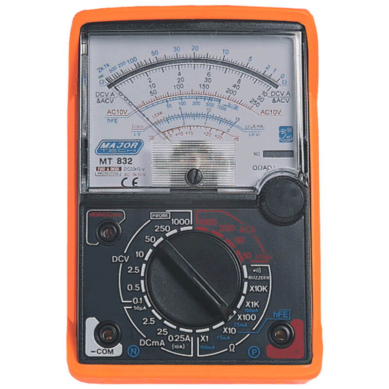

I have an ordinary AVO8 (love it - they're usually not expensive secondhand), A UNI-T clamp meter (only AC, not DC, sadly), A Maplin small toolkit analogue multimeter that looks almost identical to Mr. P's one, and a 'cooking DMM' I've had for years, used for general mains stuff.

Pete picked up on the AVO's impedance - you need current flowing to make the needle move, which means moving-coil meters usually have a fairly low impedance (resistance). They're better at making low resistance measurements, than higher ones, and you need to keep them tuned-up if you need accuracy. Like my cooking DMM, useful for mains work, AVOs are useful for checking earth resistances, etc., but they are fragile (and have no peak hold function!).

Google Avometer if you want a moving needle.
