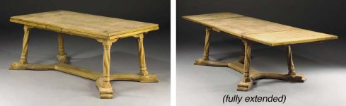

4e372726-1535-423e-a61c-50fa1be421f3.jpgThis was the starting point. Note the bevel beneath the top (which is too thin for the bulky legs).

The thickness of the top is fine. But the legs are way over-sized. If that's oak with decent joints it could be 2" square not 4" and still be plenty strong enough to stand or dance on. And you might be able to move it with a car, not a lorry.
I agree, the legs in oak (or a similar hardwood) need only be 50-60mm square not 100mm sq. The framework though, doesn't appear to be knockdownable which is one of the prerequisites of the design brief; it's gota come apart and that one won't :D! What would be required in my very 'umble opinion is an end frame so:
