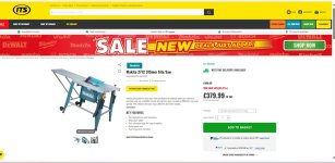

Don't know if it's been mentioned but one of these might be worth a look: Site Saw.jpgPowerful motor and better depth of cut than a table saw.
A cast bench saw with sliding table would be my go to for a workshop (but new is out of the £500 budget), instead of a bench saw a site saw is ok if used in a workshop and can still do heavy rip work. I like table saws for carting to building sites as they are very portable and can usually handle most medium tasks with relative ease but the larger motor and blade on a site saw tends to be better for larger ripping jobs.
