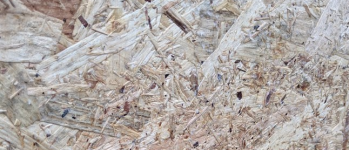

Today I took off the DPM roof to finish the roof off properly i.e. insulate; breather membrane; batten and add the metal roof sheets. But I found mould. Quite a bit of it. Mostly on the under-side of the osb; but also on top of the plywood. Now I'd allowed no ventilation of the space between the ply and the osb because I was only expecting the osb/DPM temporary roof to be in place for a few days. But it was there for at least 6 weeks.
My guess is that there are a few sources of moisture: I suspect that the slab probably hadn't fully dried out before I put up the building; the walls themselves had been stored outside for months and I suspect they were carrying more moisture than you'd want; and as I mentioned in a previous post, we had a storm that took the DPM off in one corner and filled the building with water and got some of the walll studs pretty wet. And then I put some OSB and a DPM over the top of it. I followed advice on here have opened the doors to get some air through, but the weather has been pretty cold, pretty damp and pretty still for weeks now.
Anyway, the upshot is mouldy OSB (which I have no real use for now anyway so not a nightmare) and mould on top of the plywood that I've used on the inside for the roof. I also note that the plywood has warped a bit, and some of the plywood offcuts that I'd left in the building have curled up like a banana.
Some pics of the mould - I appreciate that it is quite hard to spot in the photo of the OSB, but in real life it's quite clearly there:

-Check that plywood/rafters are dry and if so, pull back the breather membrane; scrub the mould off with a stiff brush; insulate between the rafters; reattach and properly fix the breather membrane; add the battens and then the metal roof sheets
- add a vapour barrier on the inside of the plywood roof and re cover with ply/OSB/plasterboard. This is not something I had planned on doing but the way the plywood on the roof has warped makes me question whether it can create an effective vapour barrier, and it seems like a relatively cheap and simple measure to make sure.
As always, I welcome any thoughts on whether there is anything else I should be doing.
