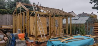

The weather isn't quite so good as it has been in recent weeks so progress is becoming a little slower.
The frames were all completed in a couple of days and put into place the following day. The folding wedges and the bed of mortar worked out really well.
The roof is a much slower entity altogether. I'm working on my own and have tried placing the rafters individually and also as a built unit of two rafters and their cross tie. I don't know which is easier but I'm sticking with the individual pieces of wood due to the weights involved for one person.
I've found the best method for placing the cross ties is to use left over removal strapping which holds the cross members nicely and allows easy height adjustment by sliding up and down the rafters.
Maybe I didn't need to be using 6x2 cross ties but too late for a change now as only two left to pop up. Tomorrow's job as it's a bit wet today!

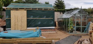

A busy few days during which time the concrete has more or less dried out after last weeks downpours which turned the base into a paddling pool.
The thermalite blocks seem to take the longest to dry out and whilst removing some internal OSB sheathing I noitice the wood was damp on the block-facing edge. Appreciate this wood is fairly water replusing but decided to slip a 300mm vertical section of Damp Proof course vertically between sheathing and the blocks around the circumference of the structure.
Since I didn't want major water problems again, with the help of the good lady we pretty much wrapped the building in membrane yesterday and will unpin it to put the insulation in place and to finish it off properly.
Save for the gable ends and extra membrane at the roof edges, this is looking much more water tight.
The fold at the bottom of the membrane is a temporary feature whilst we work out the hospital corners on the DPC, it allows us to get the square shape.

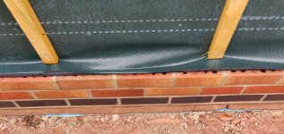

And last night disaster struck in the form of the storm.
The floor is flooded and I don't know how.
I have a theory.
I put some of the battens on yesterday and the breather membrane no longer overlaps the entire brickwork.
I think the holes in the brick have filled with water which has found its way into the inside. It's only a theory but the best I can come up with...
What do I do? I have a number of options:
- Nothing because the routed edge of the bottom featheredge board will cover the brick
- Fill-in the "holes" in the brick with mortar and SBR which will make it waterproof
- Extend the breather membrane with some more breather membrane or DPC
A more elaborate extension of the third option would be to form the DPC under the breather membrane and then use silicone to stick it on the top outer edge of the bricks providing a proper seal.
This is a horrible setback, particularly since the weather isn't great.
The Thermalite blocks will hold water like a sponge. Fortunately I put some DPC between the blocks and the OSB inner lining.
Maybe.
I thought the breather membrane had to overlap the folded back DPC.
I got mine wrong to start with.
Then was advised by more experienced members to overlap the DPC.
Which allowed the battens to be almost as proud as the DPC wrapped around the arris rail along with the wedges will then let the cladding, particularly the bottom board, to overlap the brick plinth, as well as provide somewhere to staple the insect mesh.
But I think you should definitely find the source of the ingress and real with it, if it isn't the membrane.

The building is well covered in breather membrane and the leak is definitely not from the roof. Whether the tiles will perform over time remains to be seen.
The leak is definitely around floor level so I extended the membrane with DPC so there is no water run-off into the hollow cavaties of the brick.
De-humidifier is on max!!!!!
Used a mop and now the dehumidifier to dry it all out.im certain the issue is water pooling in the brick cavities but time will tell.
The inclement weather really takes its toll.
My small store shed leaked before I boarded it, and I discovered that the source of the problem was water running under the DPC. I waited until it was dry and ran a bead of low-modulous silicon around the outside between the DPC and the brick it was sitting on. That solved the issue.
I'd not bother with a de-humidifier. Just throw doors and windows open.
The water ingress was definitely happening either under the DPC (most likely) or through the brick cavities. An extra layer of DPC under the membrane and overlapping the brickwork has cured the issue.

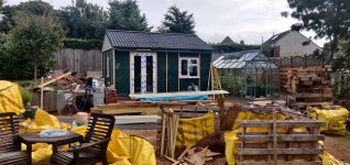

Cladding is underway although a bit back to front. We did the gable ends first in order to finish off the roof detail with the scaffold tower on site.
As well as the cladding have started the roof insulation (100mm Xtratherm) and just finished the windows and door.
The cladding really eats up the Bedec barn paint. First three 5l tons gone and another 5 on order. Not cheap at 60 quid a pop.

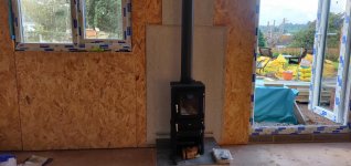

Progress has also been excellent on the Workshop but thankfully it's all been a little routine. Lots of painting of cladding and we now have only a couple of boards left to fit.
We also moved inside and insulated the rafters with 100mm Xtratherm. Sealed it all up with expanding foam. Bought a proper gun from Screwfix and it's a totally different proposition than when I last used expanding foam a couple of decades ago. So much more controllable.
Have now got half of the OSB board on as the ceiling.
Plus the "Hobbit" arrived from Salamander stoves so all cosy and warm and a "pathway" for any failed woodworking projects!!!
