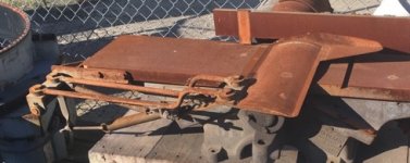

I dislike the American pork chop guard - at least as supplied on my Makita surface planer (attachment to my thicknesser).
When I did my apprenticeship with New Zealand Railways, all the buzzers ("surface planers" to you) were fitted with Australian "Ideal" guards, which are similar (if not identical) to the "Surty" guard.
As fitted to an ex-NZR Robinson HV 18" buzzer...
...and as fitted to my ex-NZR Wadkin RB 9" buzzer.
My Wadkin is still in pieces. It'll be interesting to see what I think when I get back to using that type of guard again.
Cheers, Vann.
