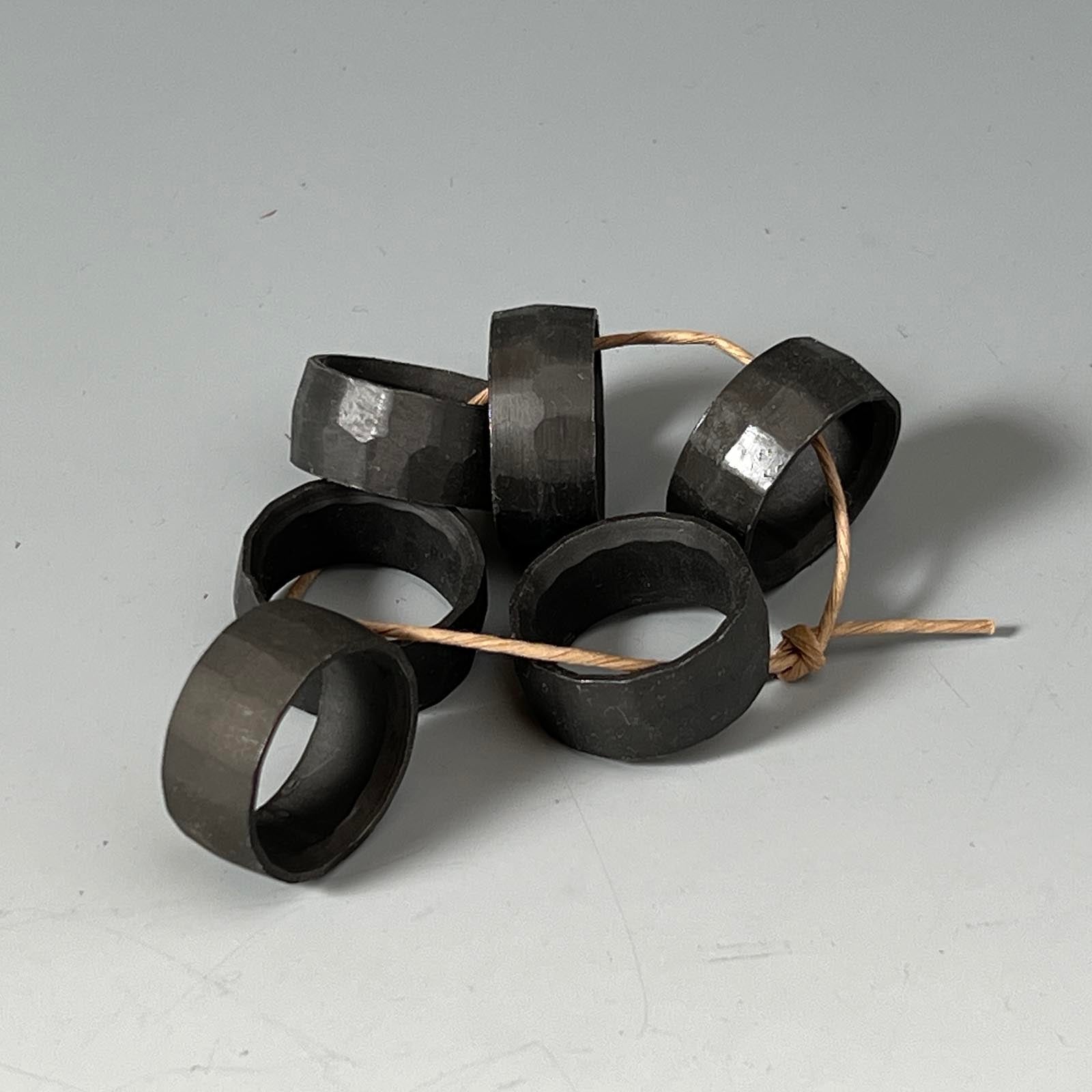

Looking great! And very generous of that guy ! The part you are calling ferrule is typically referred to as hoop or crown. There is a tool to set it https://www.amazon.co.uk/KAKURI-Japanese-Chisel-Setting-40900/dp/B0CN8FD8G1
But personally I never bought the tool and just use an automotive socket that fits. Handles often are different sizes so just find whatever socket is larger than handle but still contacts the hoop well. As mentioned the link to Stan Covington’s site has a great instruction on proper setting the hoop. Otherwise they get smashed like some of those were. You can also order replacement hoops if any are too out of sorts. I often otder from this site (but don’t brwse their tools unless you want to part with your money lol)
I bought one from Tyzack Tools in the UK and it makes the irksome process of fitting the hoop a piece of cake...on offer as well. I saw these in Japan some time ago and forgot to buy one, but I never thought I'd ever come across one in the UK - Rob
Edit - looks like I bought the last one, now out of stock.

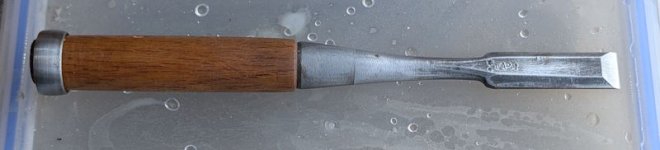

I decided to start with the 15 mm chisel as the hoop had been so loose that the handle had stayed in good nick but the hoop was a bit mashed:
I put it in a collet in the metalworking lathe and gave it a bit of a tidy-up, including cutting a chamfer on the inside:
I then mounted an off-cut of acetal (just because it's what came to hand) in the lathe, cut a taper on it and jammed the hoop onto the taper. I could then clean up the outside a little with a file and some 240-grit wet-and-dry paper.
To re-fit it, I used @SteveMP's excellent tip and grabbed a socket to be whacked with a persuading stick:
Re-fitted:
I imagine the wood will very quickly mushroom into that chamfer when the chisel is used.
With that, done, the first chisel is finished:
